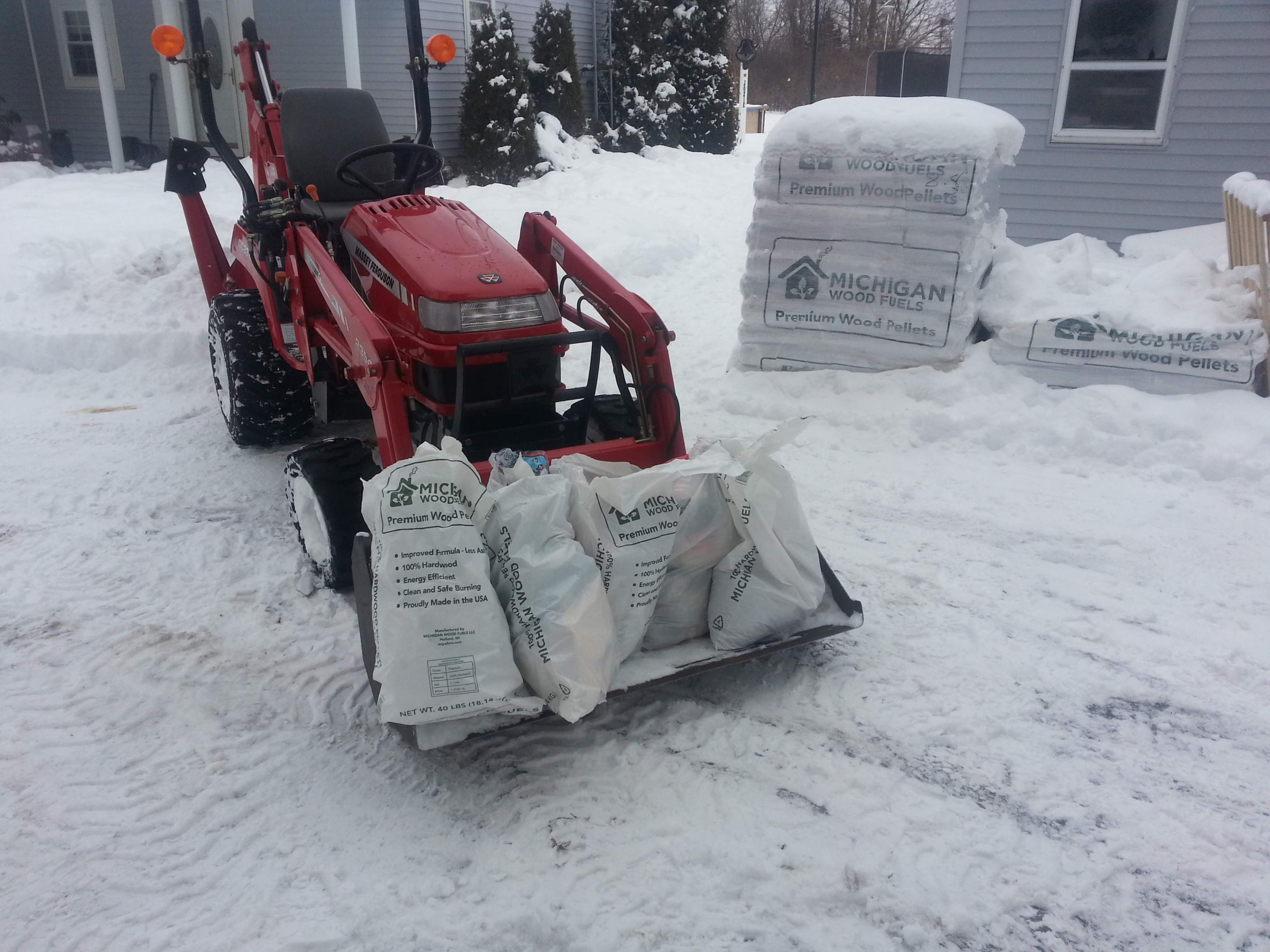

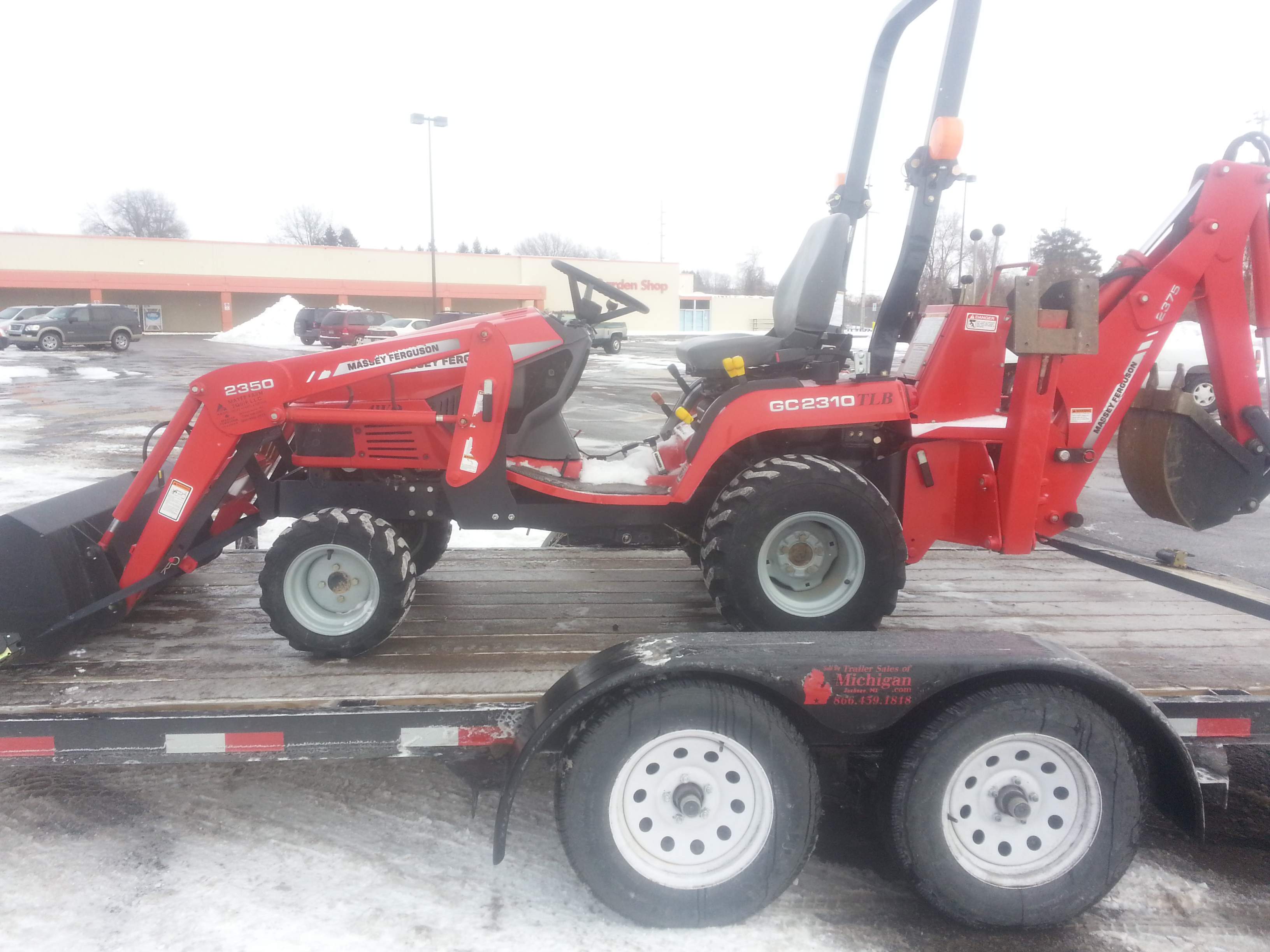

I have been lurking around gathering information on the right tractor for myself, I ended up with an amazing 2007 MF GC2310 w/ 180hrs, and in very great condition.
Thank you to every member who has posted on this forum as I gained a great amount of information that lead me to my purchase. Here are a few pictures and I will be around more often now that I have this beast of a machine :D
Also a big Thank You to Mayer Farm Equipment in Jeffersonville, OH. Each staff member were pleasant to deal with and I feel we did good on this unit @ $11,500 OTD

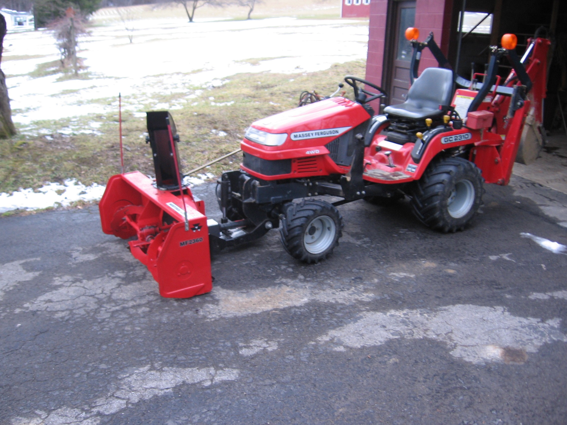

Have the same machine - an 2005 model. Paid $15,600 new. Great machine. Have around 650 hours on it now. Got a used MF 2360 snow blower for it last fall. This winter it paid off.
