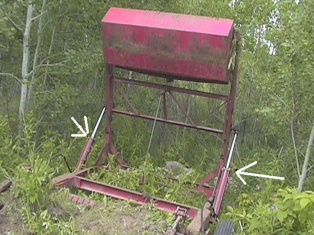

Here's the situation: I have a NHTC40DA w/3 added sets of NH rear remotes. 2 sets are used for the top & tilt leaving one set unused.
Due to the large amounts of material we handle on the farm I'm strongly thinking about getting or making a trailer that can be dumped hydraulically. Several of the dump setups I've seen use 1 hydrauilc culinder w/1 hose. I presume these work by aplying hydraulic fluid behind the cylinder to extend it to dump when the control lever is pulled.
The question I have is how does the cylinder retract to allow the dump bed to lower? Do you push the lever in the opposite direction as to dump? Or is there some other sort of hydraulic control valve (?) needed to somehow allow the fluid to get back into the tractor reservoir??

I have a single acting dump trailer. It works fine with standard 2 way valves. You won't need anything special.
One caveat however in that the single ram fills & empties. A large ram takes a lot of oil. My JD A Power Trol only has a 4 quart capacity & a full load on the trailer 6K + lbs will not allow the ram to extend fully.
A 2 way cylinder will have oil on both sides effectively adding oil capacity.
I have converted smaller 2 way cylinders to 1 way by installing a breather in the unneeded cylinder port. About a $5 part that eliminates second hose, connector etc.
Pix of rockpicker with breathers, setup has 2 circuits and a valve with only 2 hoses to tractor. /forums/images/graemlins/grin.gif
