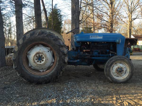

I went with my father in law today to look at a Ford 2000 that was for sale at a very low price. He had it delivered to his house an hour later. It has a bad seal leak dripping out of drain hole in the bottom of the bell housing that he should replace, the right brakes and meter does not work, but other than that, the old tractor seems to be in pretty fair condition. I looked up the serial number and it is listed as a mid 1963 model, 4 cylinder gas burner with 4 speed transmission, PTO and lift. He's seems pleased as this is quite a step up for him from his Ns he has been used to using. He don't garden anymore, but does like having a tractor around to lift stuff with his boom pole to move around, occasionally level his driveways and bush hog.

Brakes on that model are just like the 8n, so check adjustment, may just need a few clicks to have brakes.
Leak fro bell housing could be rear main or trans input shaft, or both.
Proof meter drive is off the nose of the hyds pump. Could be meter, cable, or drive end.
That 134 city red tiger is a great engine design. Very robust.
Spin on oil filter is a fl1a, from ph8a, Napa 1452 or just about any cross to those.
I reccomend 15w40 oil for most climates. UTC can be put in Hyds, diffy, and trans, plus PS had it been equipped.
   / New (to him) 63 Ford 2000 #6
PS, uses same plugs as that 8n, and same points if the n was a side mount, same cap, and codensor, again, if the n was a side mount.
Don't forget to service the oil bath air filter.
