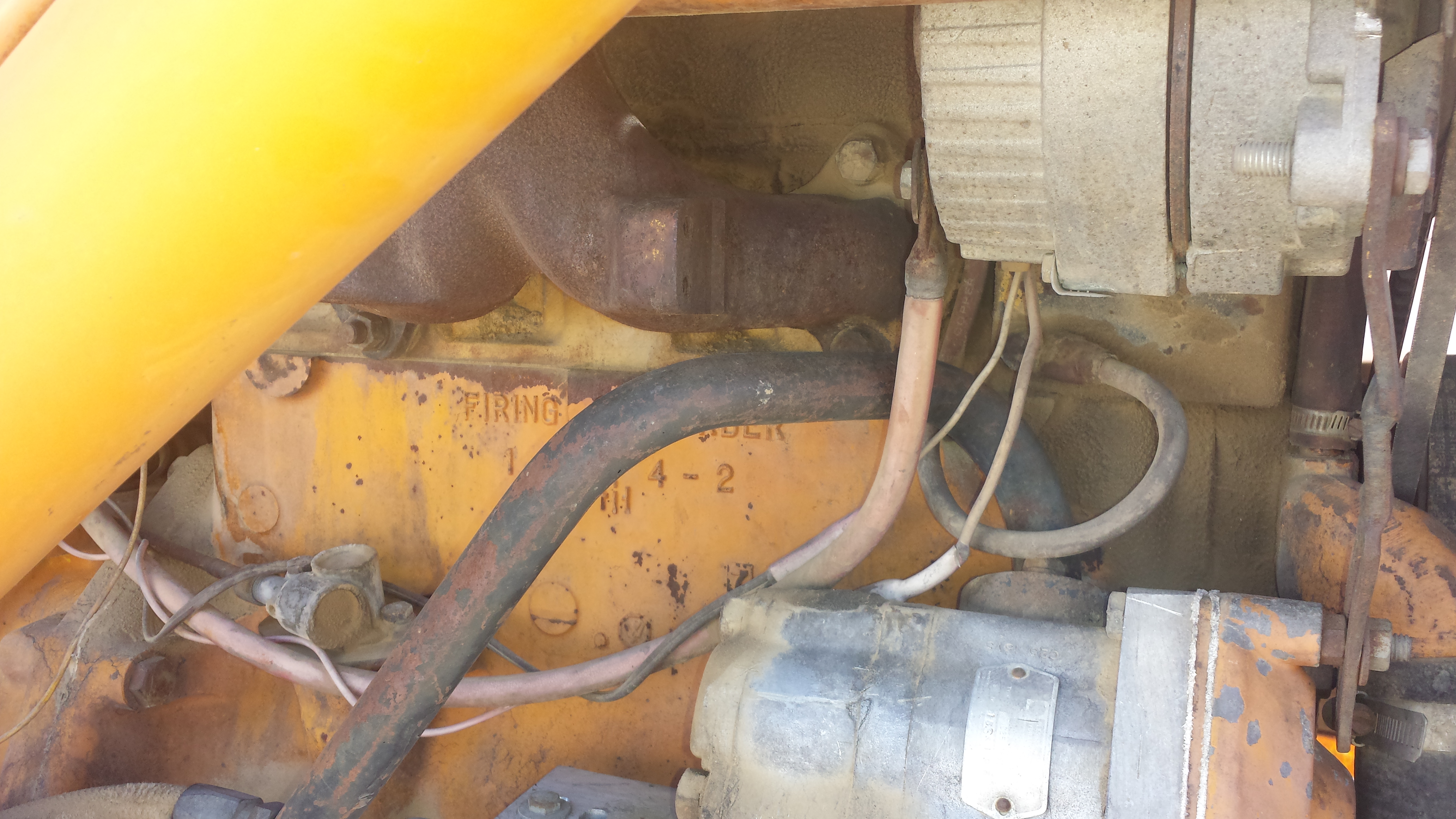

Having problems with the starter which was rebuilt last May. Tractor has been dead for at least 3 months now and will not turn over. I've charged the battery up plus ran jumper cables from my truck and while the solenoid engages it will not crank the engine. Ever since I installed the rebuilt tart when I go to crank the engine over the only way to stop it was to disconnect the battery unless the engine started then no problem. What will get damaged if the starter cranks too long.
   / New to forum and new to large tractors #36
IH and CASE are nowhere near alike!--- I have 580 ck backhoe/loader . You have an IH.---If you run the starter too long , more than a few seconds, you take the chance of burning it out, then you can go get another starter.---You have a major electrical circuit problem that needs to be fixed before you go any further, and possibly damage something very expensive.
Start out making sure all of your main cables are good, might be wise to put on new ones, so you have good ground and full amperage to the sol. thanks; sonny580
#37
Found out that the guy who rebuilt the starter used cheap chinese knock off parts that had failed. Got it rebuilt by a shop in Yucca valley and man does it work much better than the when the starter was rebuilt the first time. Does anybody happen to know what amp hours the original battery is for the IH 3444?
