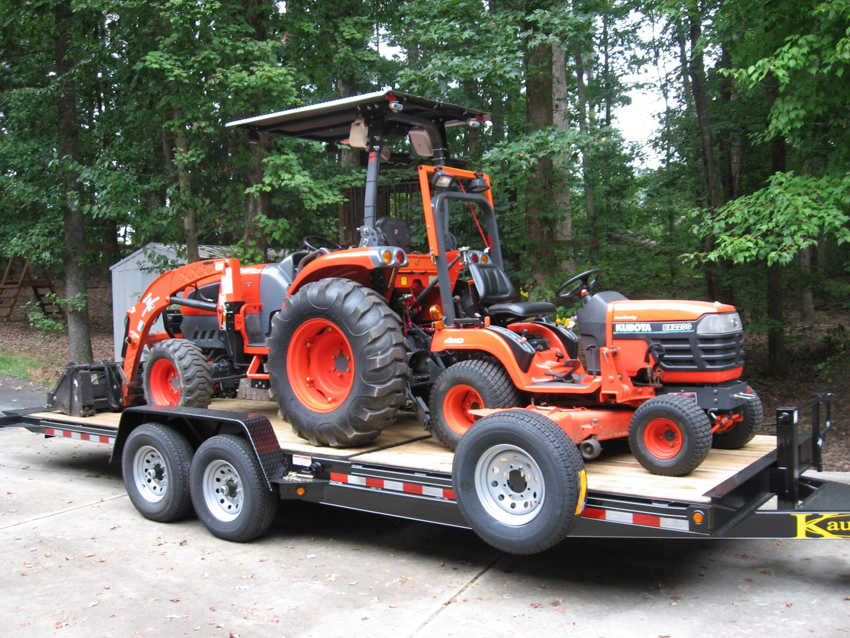

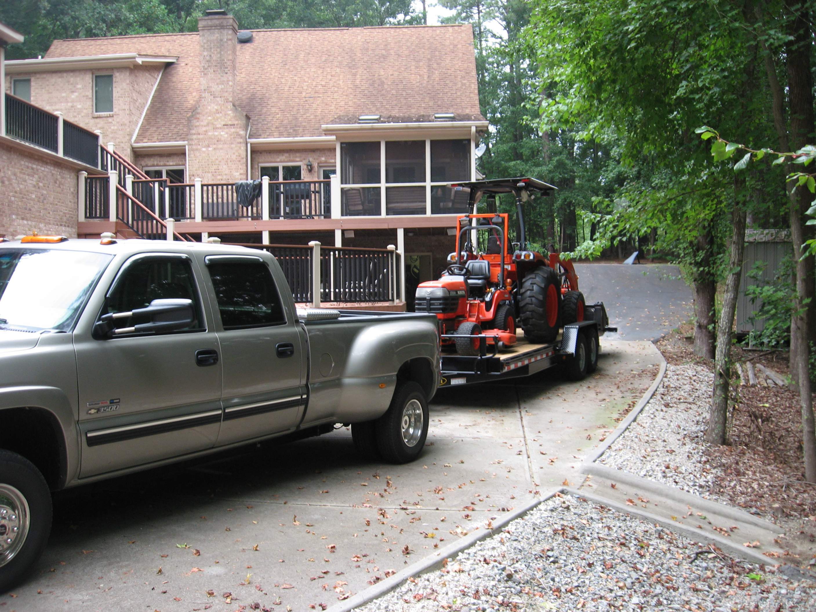

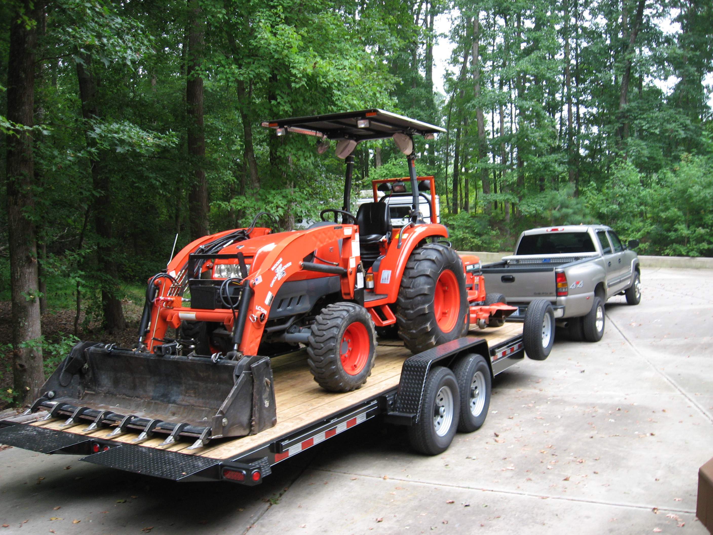

Just got it today from Kaufman 22 foot tilt. I knew it would be close if both tractors would fit. I love it when a plan comes together. For safety police only time I would load both is to mow one property I own 20 miles aweigh. No long tows with both tractors. Lots of room for one and a lot of other stuff though. tilt trailer 001.jpgtilt trailer 003.jpgtilt trailer 005.jpg
   / New Tilt Trailer With Kioti and Kubota on board Pictures #2
Nice fit. I bet you measured and double checked a few times. Good job!
