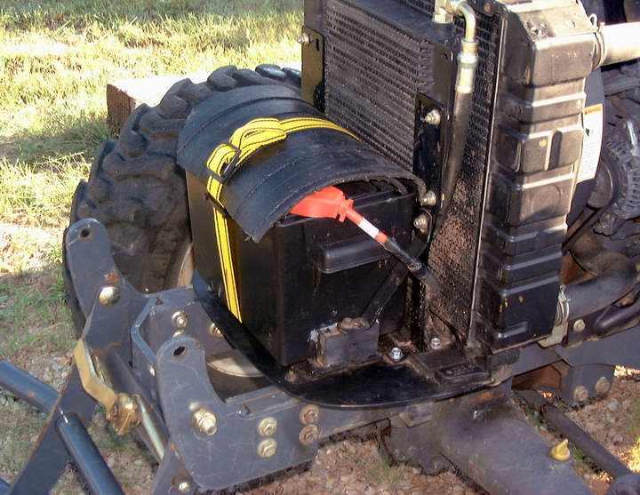

Any chance of a picture? /forums/images/graemlins/confused.gif Here's the way the guard is mounted on a TC45D. I was installing a battery box and had the grill guard folded down. The only way I can imagine your dealer could have screwed it up is to only use two bolts on each side and slide the guard back so the front holes on the grill guard align with the rear holes on the tractor's mounting bracket. That would sure block the hood. /forums/images/graemlins/mad.gif

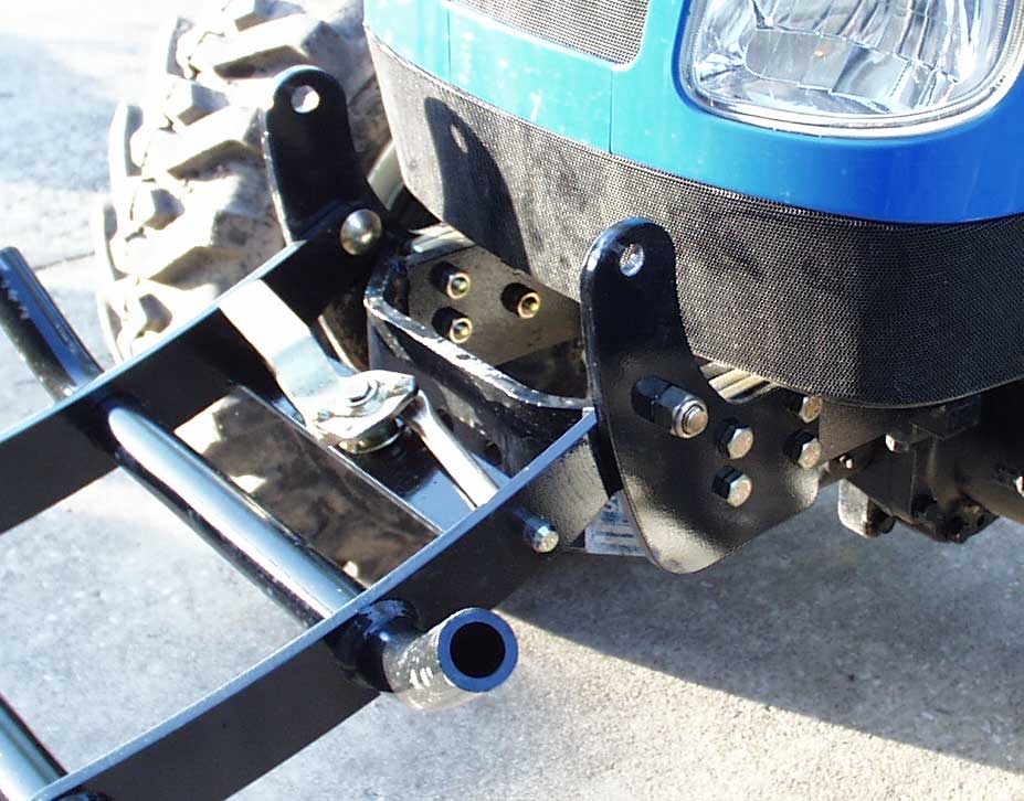

Here's a picture of me trying to open the hood, showing the interference with the guard brackets.
The correct part number for a TC35DA grille guard is 719849056. I don't know what I have, or if the TC35D part number is different.

Chuck, there isn't much you can do about the guard blocking the lights, but I've looked at your pictures and mine a few times and I think they put the wrong mounting brackets into your kit. If you look at the front two bolts and then go straight up, your bracket starts to curve right above the forward bolts. On mine, the bracket is still flat and goes at least another 1/2" out before starting to curve up. I think that's just enough clearance to allow the hood to rotate up and open.
Drilling the holes out so they are elongated should not be done. If your guard slides backwards if you bump something, that's not much of a guard in my book. Now if there is enough room so the holes could be drilled 1/2" to 3/4" farther back, that might be an option, but that would be something I'd let the dealer do. Another option might be to take the brackets off and move them forward, just using the two rear mounting holes in the front holes of the tractor frame. That would move your guard out quite a bit. In that instance, you would want to make sure the guard clears the loader. If it does, you might wait and get your dealer to investigate and fix the problem when you take it in for the 50 hr check.

Now that I look closer, I see what you mean. My brackets do look shorter. I took the guard off (didn't have much choice if I wanted to open the hood) and will call the dealer to see if they have another guard in stock. If they do, I'll take mine back for comparison. If not, hopefully they will order one for me. Thanks for the help.
