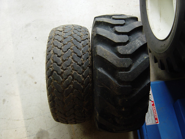

I'm lucky. I've got both tires for my TC18. The R4s were marking up my lawn. Here's a side by side comparison
Rears attached
   / New TC24DA on the way, need to make tire choice!!! #7
And front.
My dealer hooked me up with a set of "take offs" for 50% off list. Retail all 4 corners would run you ~$800 +/-
