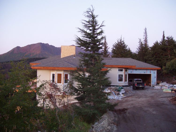

Thanks for the nice comments, guys. I've been waaay too busy lately w/ a work and dry in a house I'm building for my family. The pics of the tractor I should have snapped tomorrow ...in the interim, I can't quite post a peak of it but if you could see into the garage on the left hand side, that's where it's at. The blower ordered for it is the std New Holland 3ph model.
I'm a little concerned about it as the driveway is gravel and has some rocks on it that I'm fairly certain would be launched through that blower like a machine gun. Never operated this kind of setup before and am a little concerned about it. We'll see soon as she comes in.
Thanks again, and pics soon.
