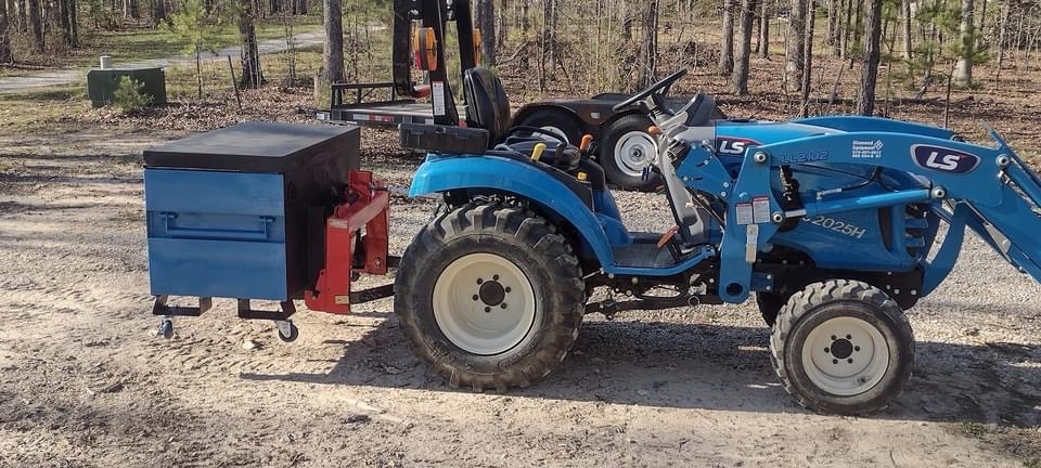

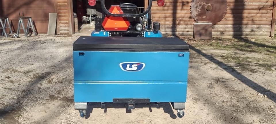

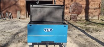

Here is a little project I just completed. I was wanting something different than my old "standby" 3 point carryall and I settled on this. I started with a used jobox I bought off marketplace and had some 3" channel and other scrap steel laying around. I started cutting, grinding, welding and painting and here is what I came up with. My inspiration was from another board where a fellow mounted one to a standard carryall. I wanted a bit more compact design. For counterweight I put 4, 60# bags of concrete mix (still in the bag), then a 5/8" piece of advantech I had for a level floor in top of the concrete bags. I still have plenty of room for both chainsaws, gas cans, cant hook, and my other wood cutting tools. The rollers make it easy to move around in the shed when I take it off. It matches my little LS pretty good. I documented the build and hope to post a YT video one of these days.

very nice craftsmanship. (y)
