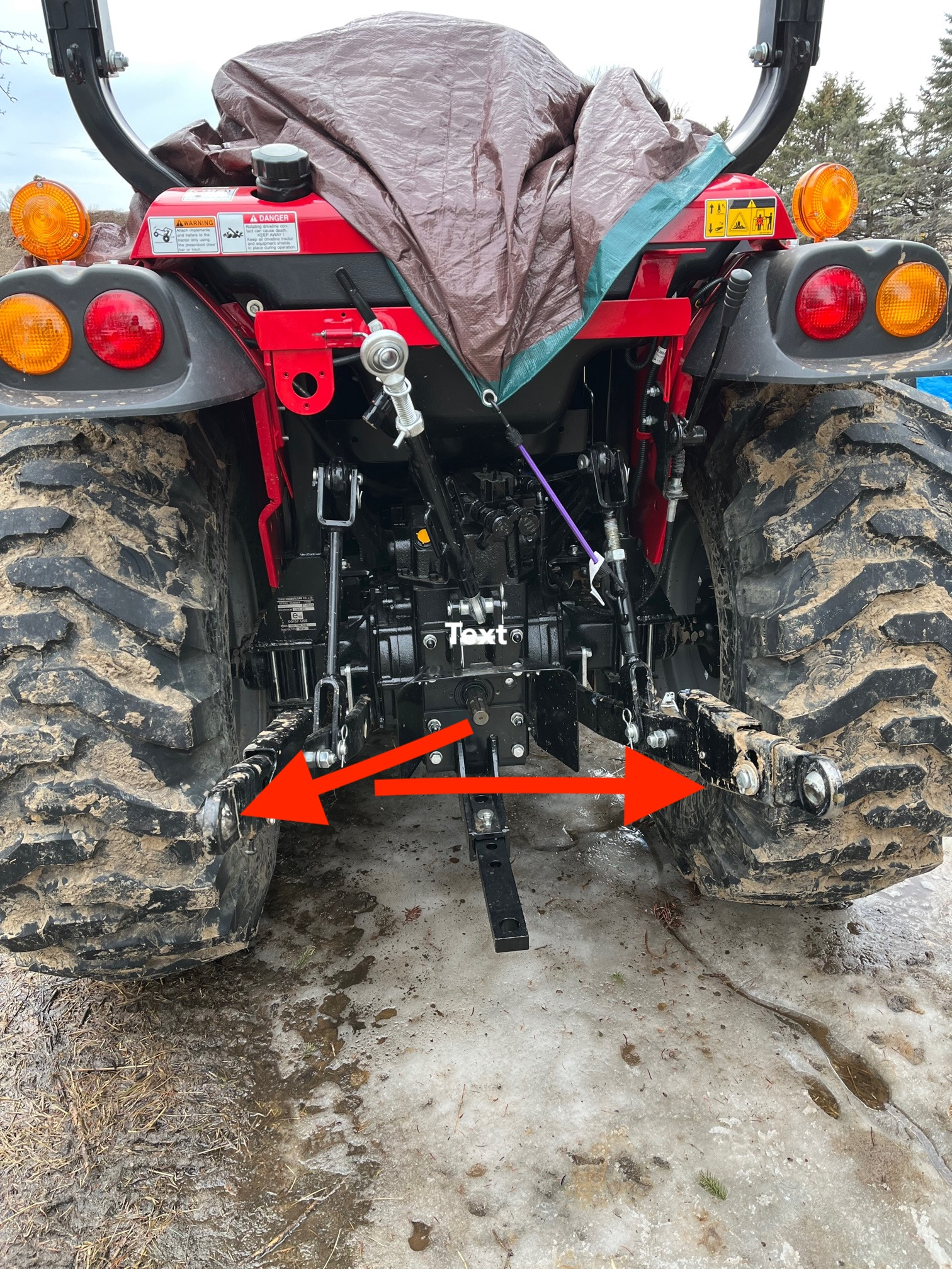

About 10 hours in, and i've worked it hard with lots of dirt moving. Couple issues:
1) I went to pop the hood and check things out and the front guard bracket is slid back and unable to open hood (see pick).
2) the lower hitch points swing back and forth and could easily hit the tires. not seeing any sort of brackets or similar to hold them in. Normal?

See page 2-34 in your operators manual regarding the check links on the three point hitch lower arms.
Edit: I'm assuming that the checklinks can adjusted to shorten enough keeping the lift arms from hitting tires.

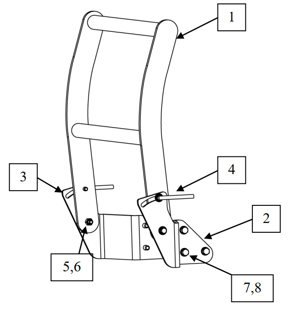

1- There should be a pin on the grill guard that you should pull and then fold the grill guard forward so you can open the hood. Don't forget to put it back in place or next time you move the loader, you'll bend or break stuff.
2- Use a bungee cord or something similar to tie one arm to the other so the arms don't flop around hitting the tires. The same stuff you're using to tie the tarp on the tractor works just fine. This only happens because you don't have an implement hooked up.

I saw that in the manaul when I was going through it. However, I couldn't locate the check links on my 3 point hitch. Am i missing something here based on my picture in OP?
   / New T474 Can't Open Hood and 3 Point Hitch Swinging Side/Side (see pics) #5
The picture in post #2 shows the check links that you should have.
They will work with an implement or 3 pt "draw bar" installed.
Otherwise they have no restriction to out swinging on the arms.

Saxon11, my RK is made by TYM so I imagine they have a similar design. On mine the two levers (3 & 4) are threaded and hold the grill guard in place. Just loosen both levers and you should be able to swing the guard forward to allow clearance for the hood.

All 3 point hitches swing if not stabilized PERIOD
Maybe it’s the angle of the photo but I don’t see any check links on your photo. If they are missing, the dealer needs to install them.
