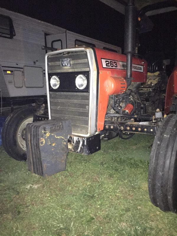

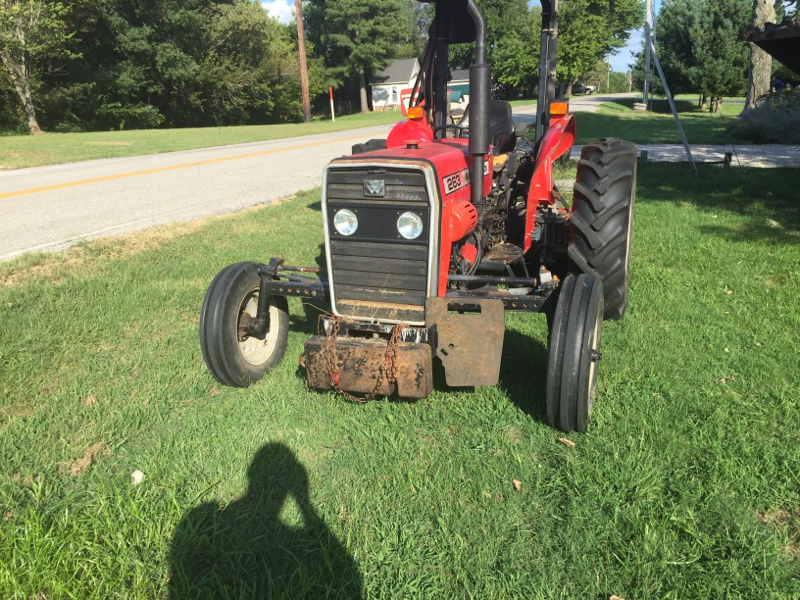

Had weight chained to the front. Wasn't crazy about it but couldn't find Massey weights around here. So I went a different route.

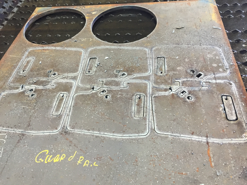

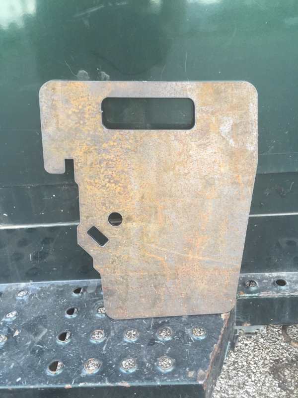

Think it was leftover AR 1"plate each weighs 52lb. I sent them this picture I found on Google (black and white) and they drew and burned a 1/4" Template in under a 1/2hr.(awesome job and fit) let them know it was good so they burned them. It was free I take care of my coworkers.

Thank you they beat the old one in looks
