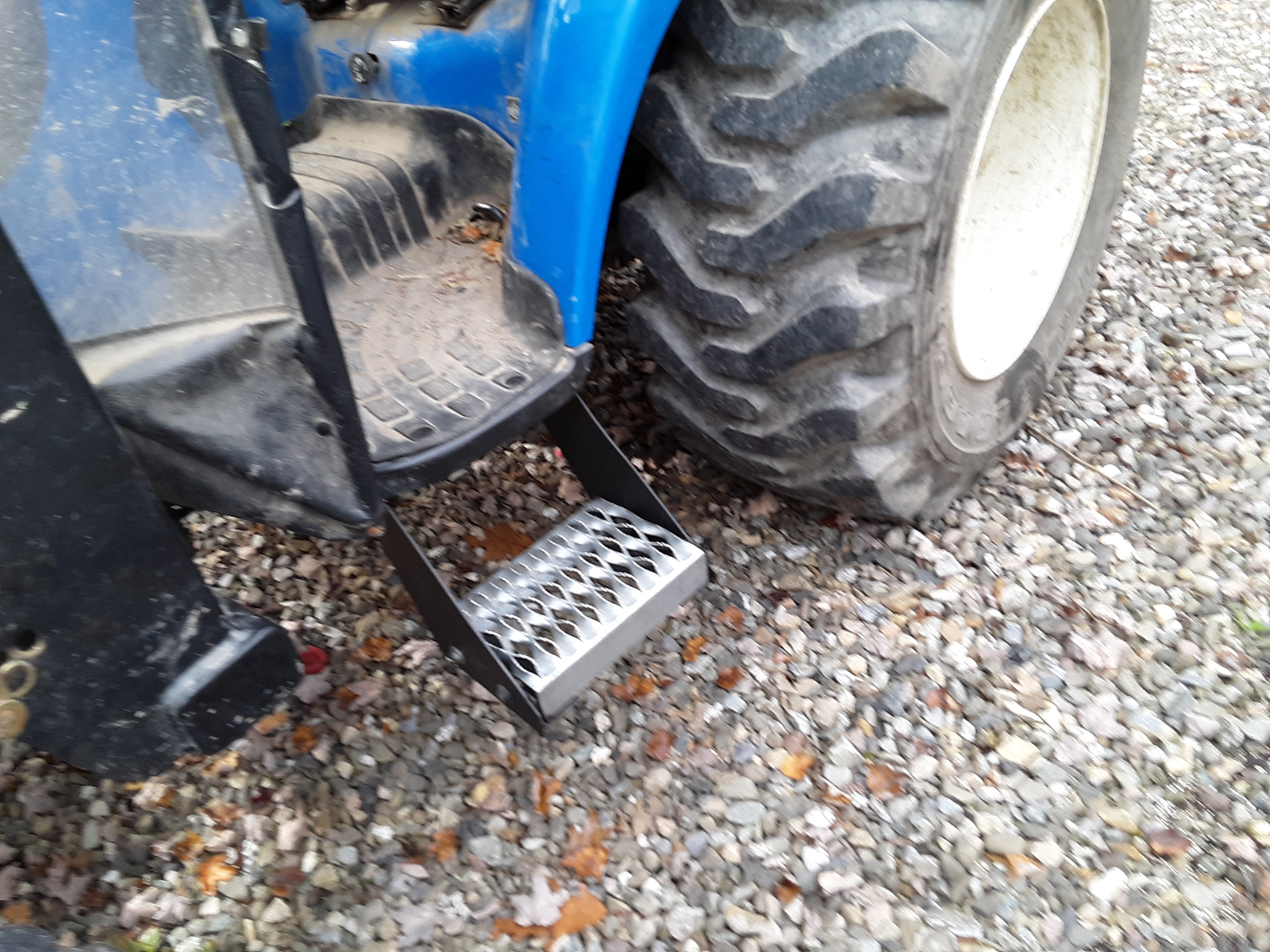

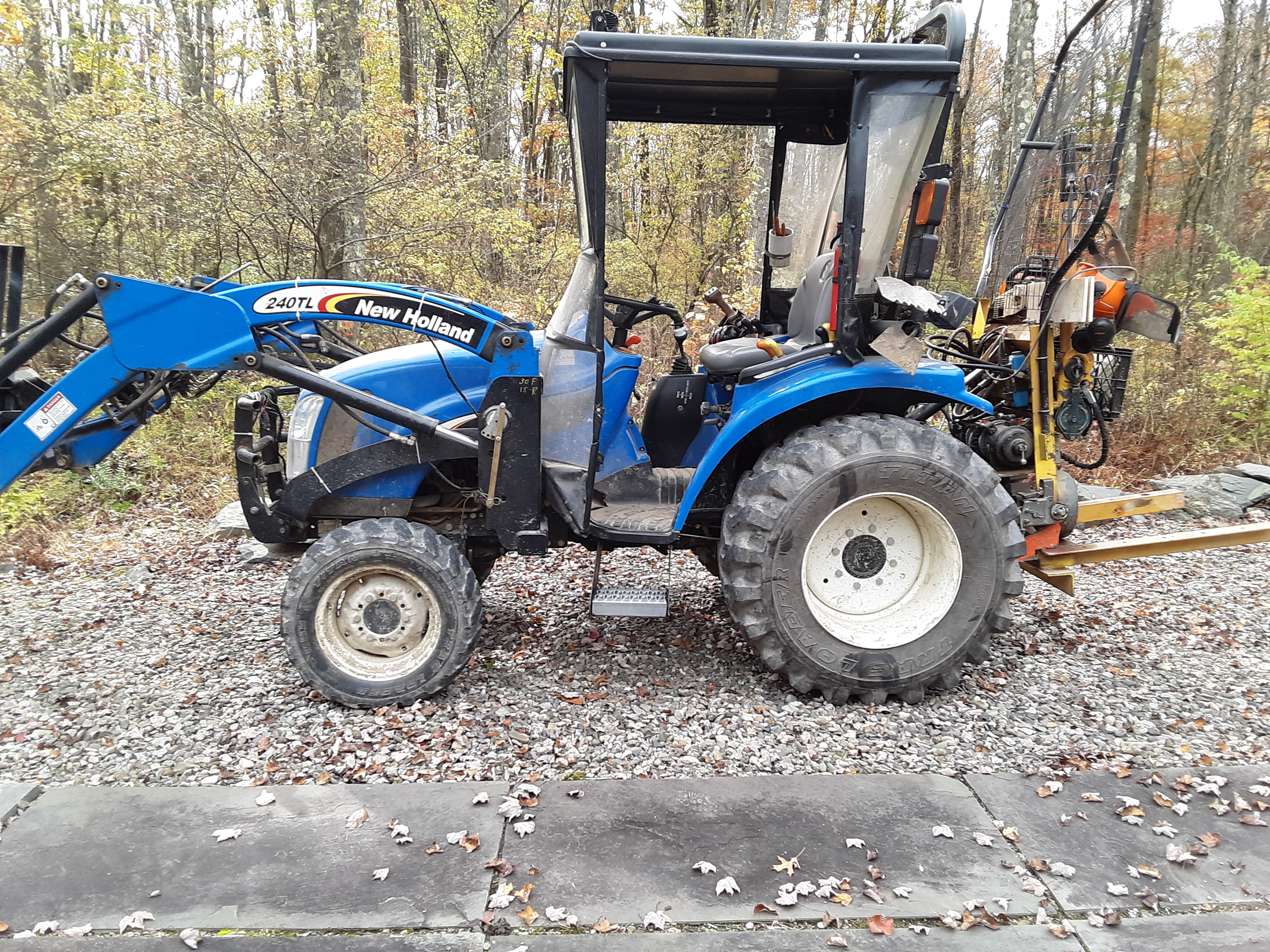

I had a factory step on my TC34DA. Going up worked great. Coming down I would have to back down if I wanted to use it. Di not bother me until I had a knee replacement. I never backed down , not much room to turn around. Now I did not want to land harder on my good knee than I had too. New step time. Stringers , spacers I had around bought a 7" tread. It was not particularly difficult but time consuming. I may add one more brace but it works great. TC34DA with new step.jpgTC34DA step.jpg
   / new step for NH TC34DA #2
Great looking step! I am due for a knee replacement within a couple months, and I have thought about getting on/off the tractor after the replacement. I also have enough scraps around for the stringers. Where did you get the step from? All that I find around here are about 20" long and they want a small fortune for them.
Amazon 7" x 24" $42 I didn't even use 1/2 of it. Pay for shipping and you can have it. PM me. Don't believe anything they tell you about knee replacement. It hurts like crazy and you can get addicted to the pain meds in a couple of days. I am not sure I will ever be able to kneel on that knee cap. On the other hand I am really glad I did it. Bad knees suck the energy right out of you.

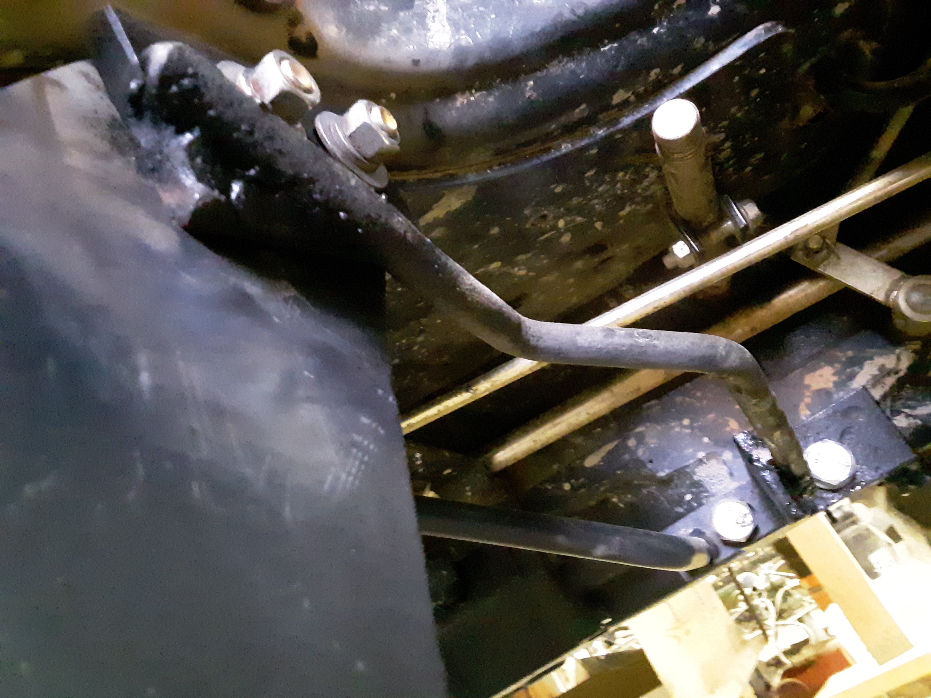

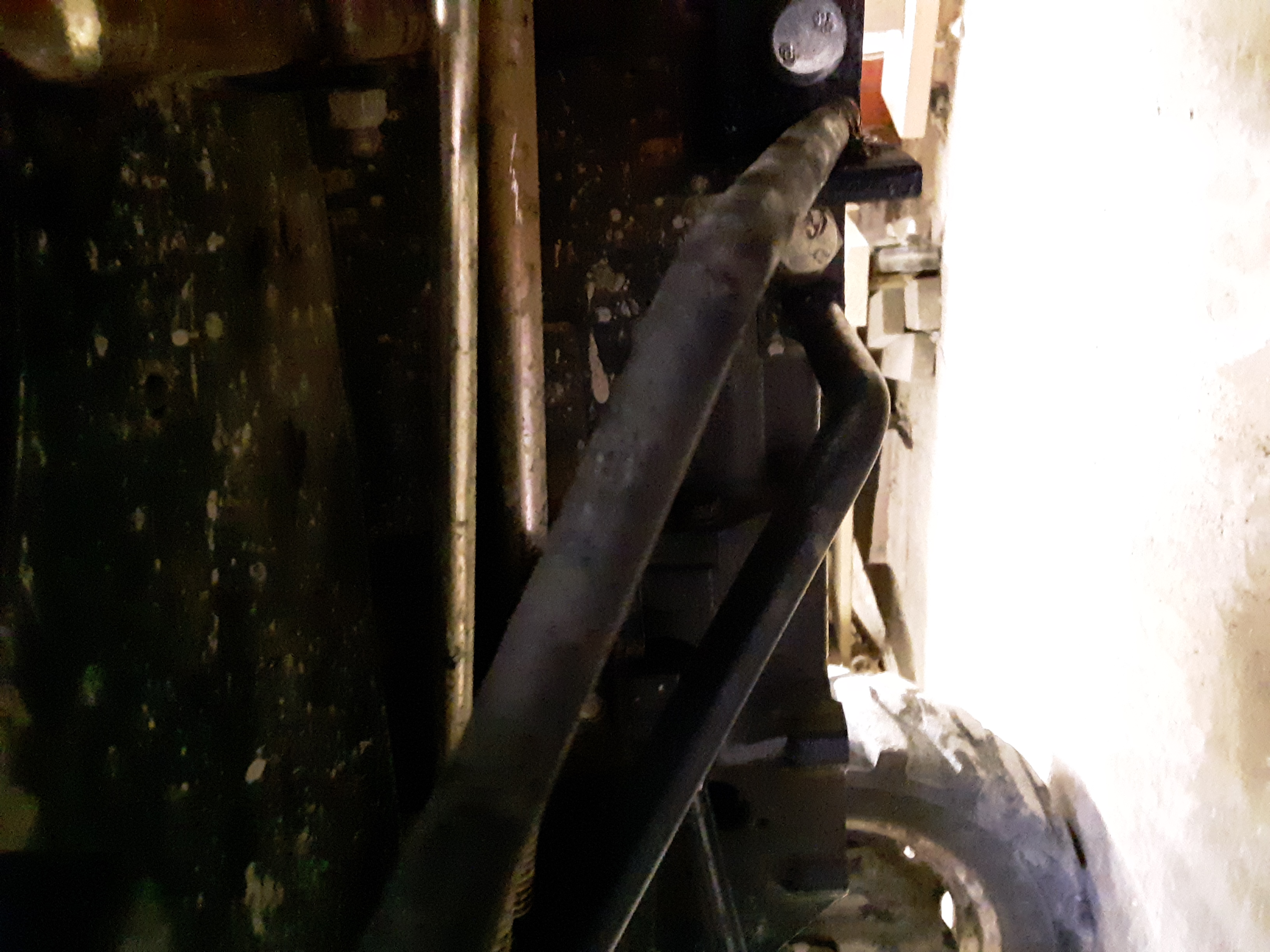

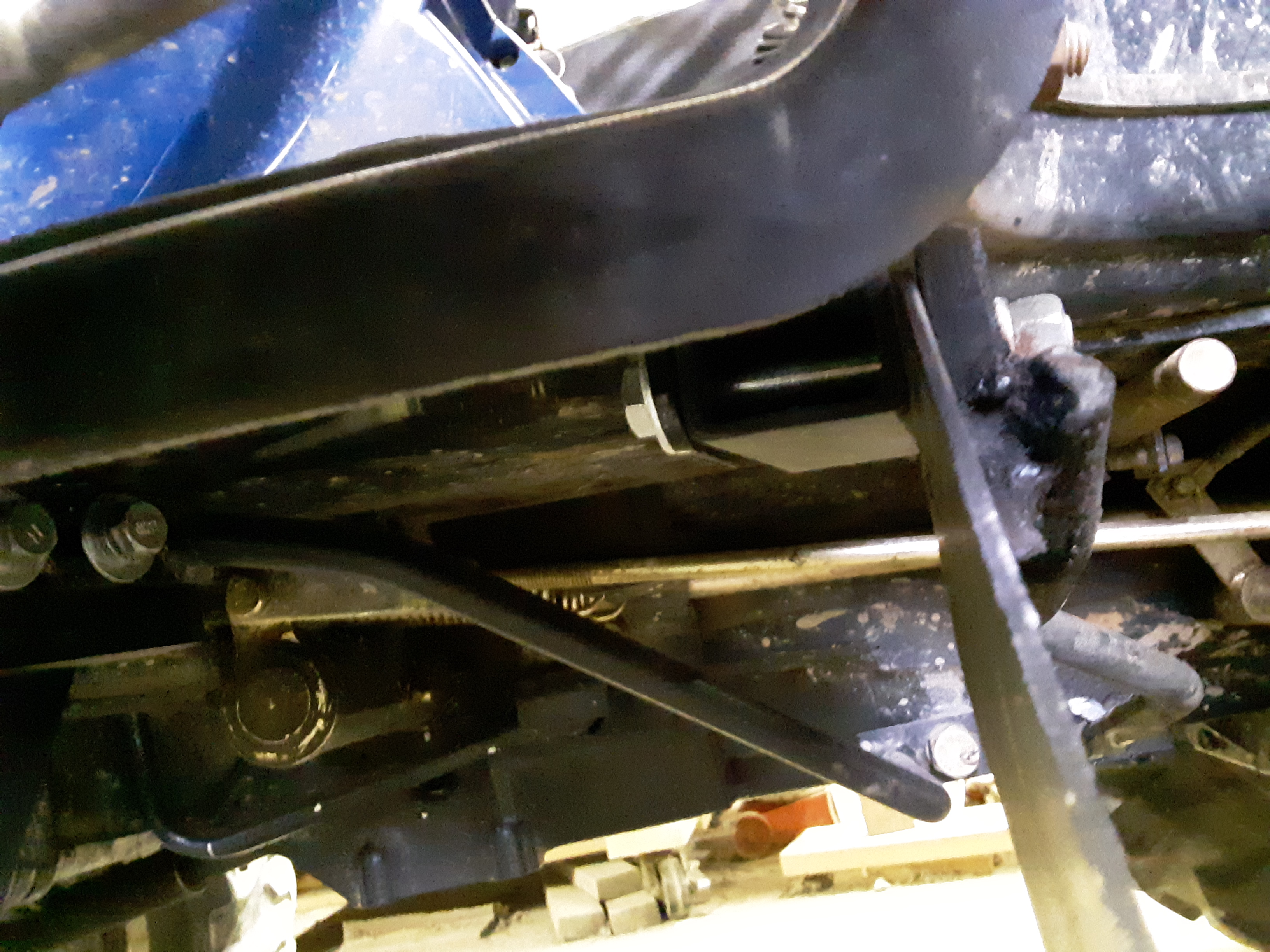

Pictures show braces under the tractor from the tapped holes in the transmission to the top of the stringers

Thanks for posting the pics.... I haven't had a chance to get out to put the step on mine yet. Too many things to get done before winter takes hold! I also have a few factory braces that I 'll probably attach to.
