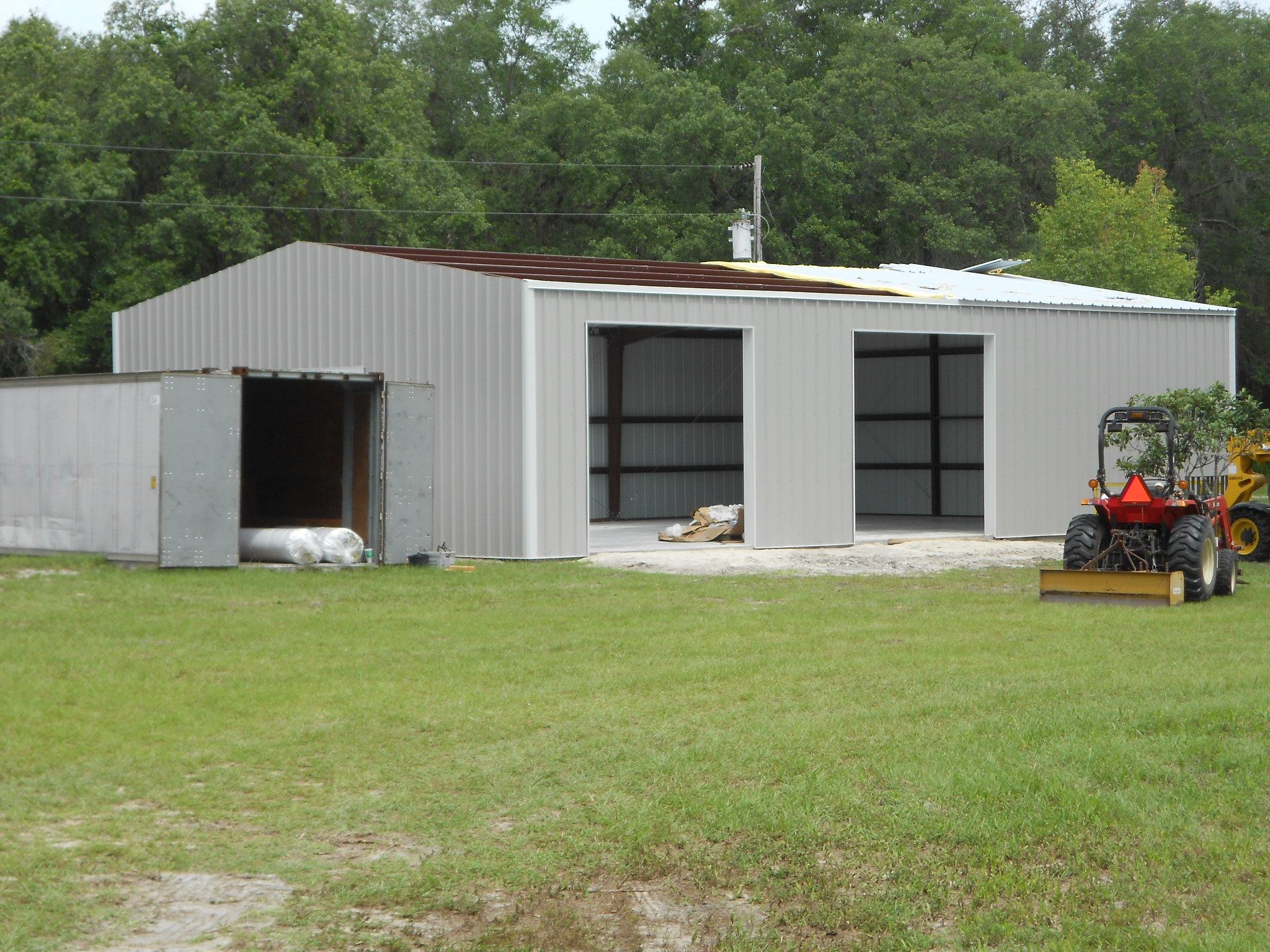

A year and a half ago I put up a 40' X 60' x 12' red iron building.
It came with certified, engineered drawings and a 130 mph wind load rating.
I don't know what kind of codes you have but it might matter.
Just the building parts, factory cut, formed, fitted, jig welded and delivered was $17,000. Have you figured the cost of material?
Yes we have compiled a full list of required parts.
I should say that I am an ex Plant Engineer from a major US steel framed manufacturer so I know the product very well but I am not a design engineer, thus I have intentionally gone for an element of over design, but excluding doors we are still on a cost build up of $12K
Thanks for your input
Bill
