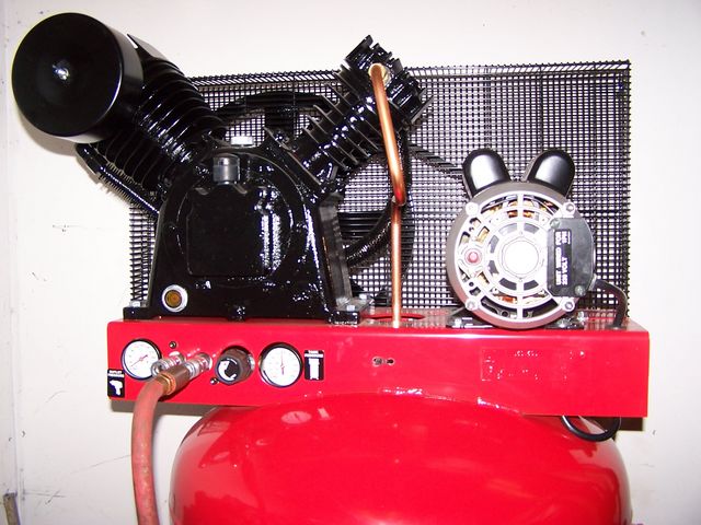

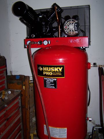

Finally had to bite the bullet and buy a new shop compressor. My old one was a 5HP, 60 gal, 2 stage 120# max rated compressor I bought from Northern Tool (was called Northern Hydraulic back then) over 25 years ago. It served me well with annual compressor oil changes, one belt change, and one relief valve replacement. The motor and compressor are still fine but the bottom of the tank rusted out. I bottom blew the tank at least twice a week but eventually the moisture in the tank took its toll. I thought about patching the tank but found it to be paper thin and the whole tank needs replacing.

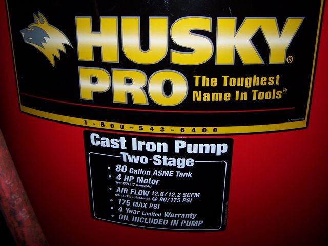

New compressor I bought from HD and is 4HP with an 80 gal. tank, 175# max and has a built in pressure reducing regulator that feeds two ports plus I have two more ports off the side at full pressure. The unit is made and warranted by Campbell Hausfeld for HD using the Husky name.
And of course I used my tractor and forks to remove my old one, unload the new one off the truck and set it in place. Also splurged and bought a new hose and replaced all my quick connect fittings on tools and old hoses.

Good looking compressor. Seems to me it ought to last at least as long as the old one did.:)

dbdartman said:
What's the CFM rating at 90 psi (or whatever psi they rate it at)?
generally on the label they will list 2 CFM's one at 90psi and one at full output pressure (whatever that is)
usually they very more than shown so take the numbers on that label with a grain of salt
