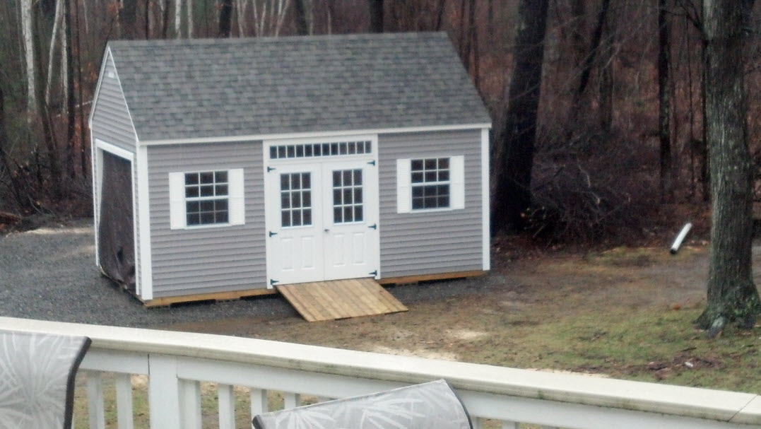

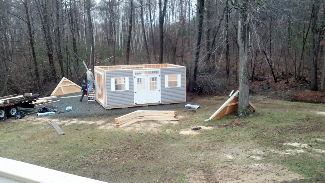

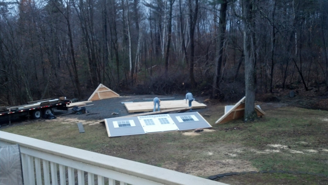

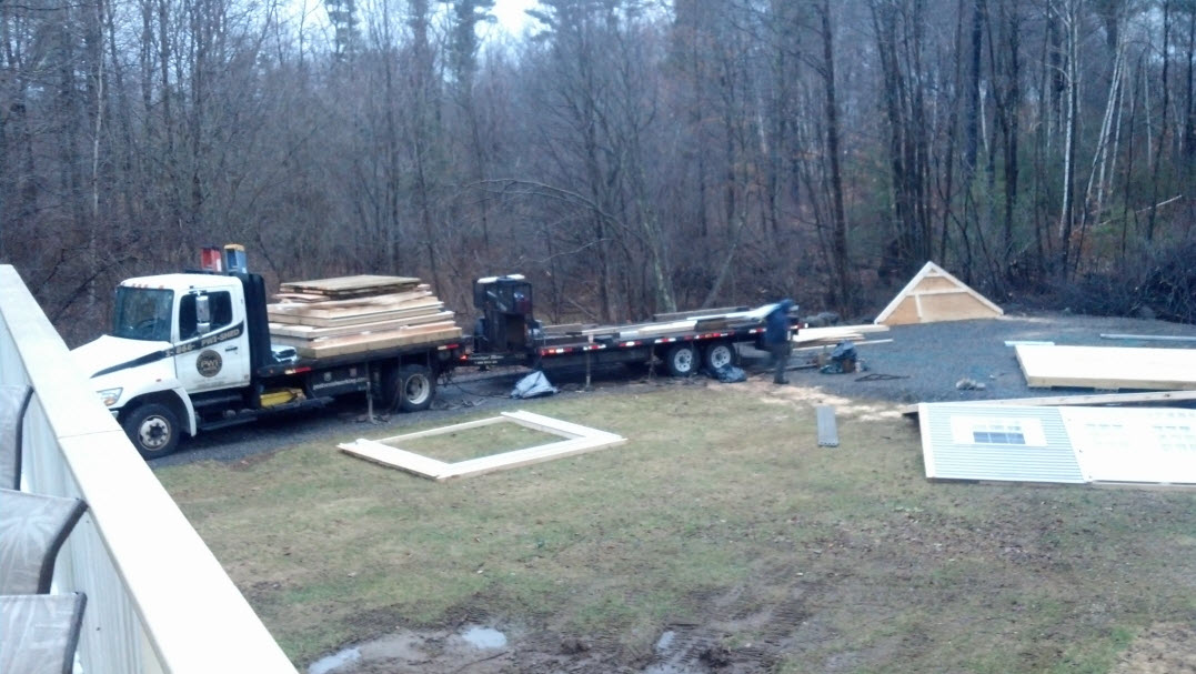

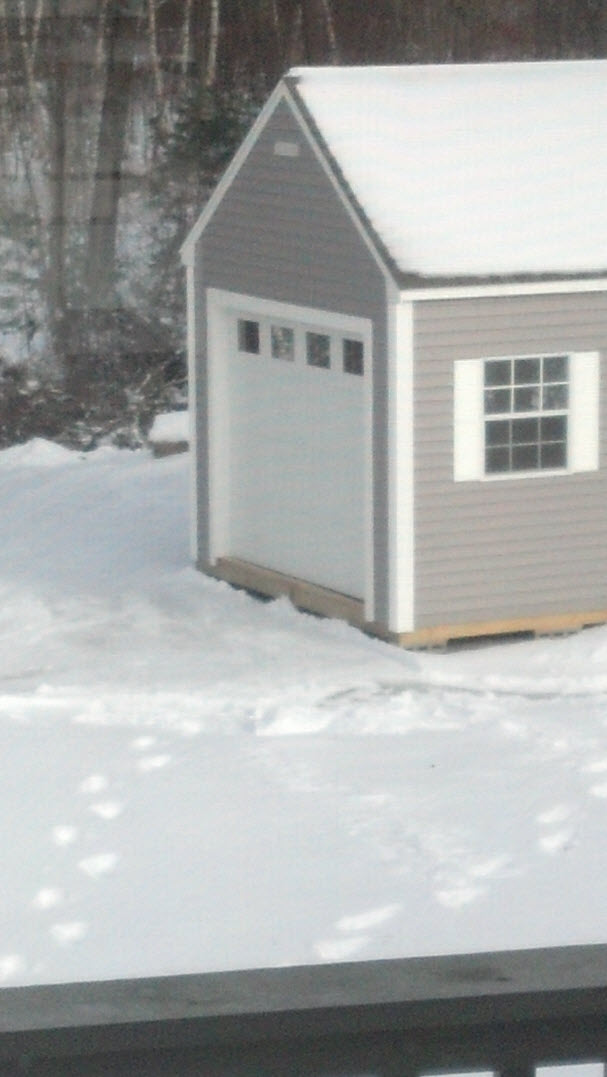

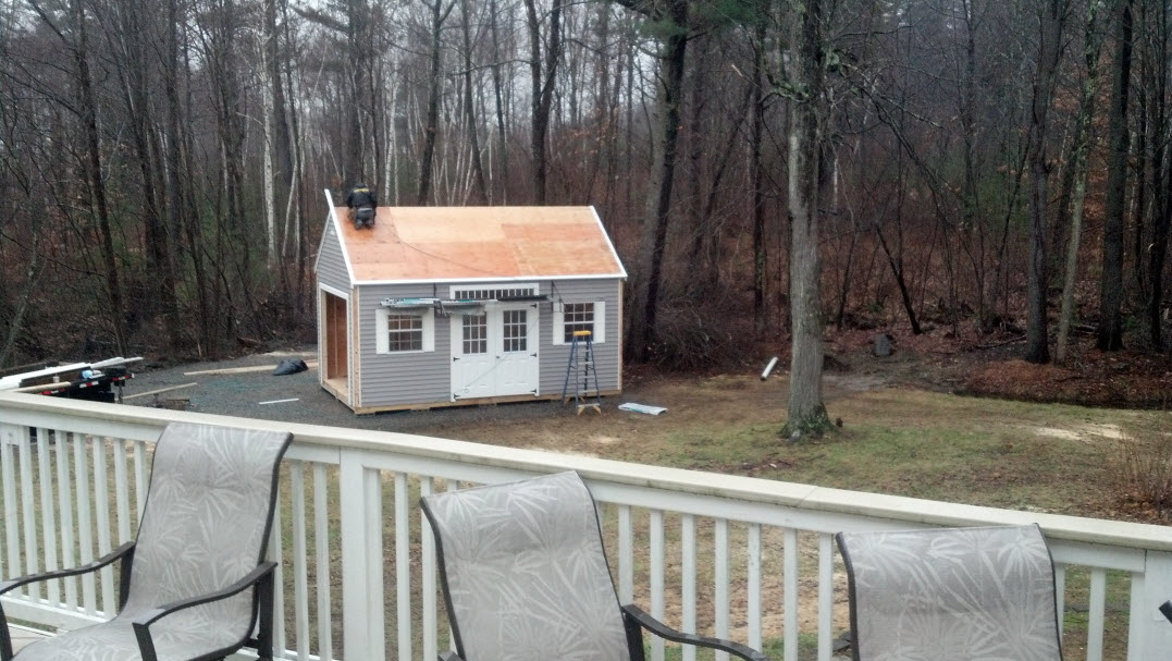

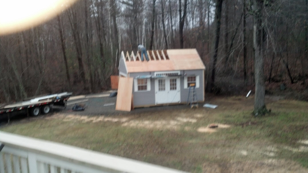

Just an update, I did go with the Post Woodworking recommendation of 12OC 2x6PT with joist hangers and the double (and staggered) 5/8 plywood floor. It worked great last winter and not a deflection or bow or "soft feeling" at all. It feels very stout and sturdy. Here are some pics of the shed going up (in the rain!)
PostWoodworkingShedBuild -001.jpgPostWoodworkingShedBuild -002.jpgPostWoodworkingShedBuild -004.jpgPostWoodworkingShedBuild -006.jpgPostWoodworkingShedBuild -008.jpgPostWoodworkingShedBuild -010.jpgPostWoodworkingShedBuild -012.jpg
