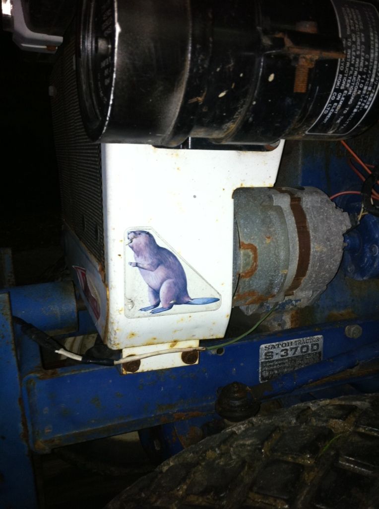

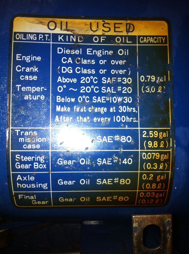

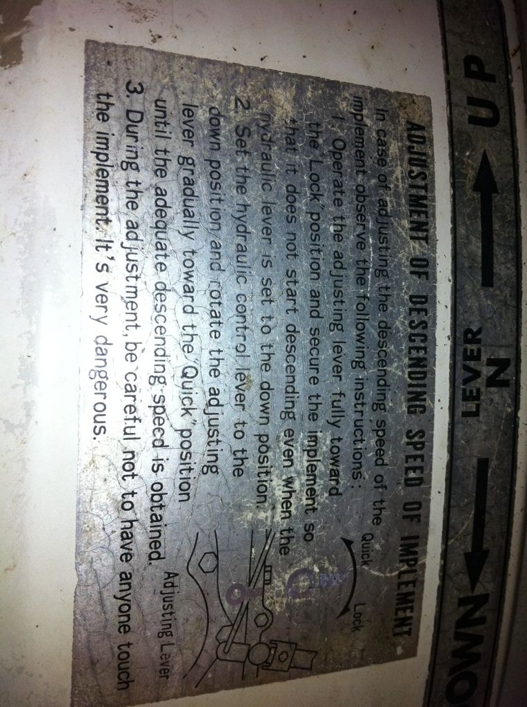

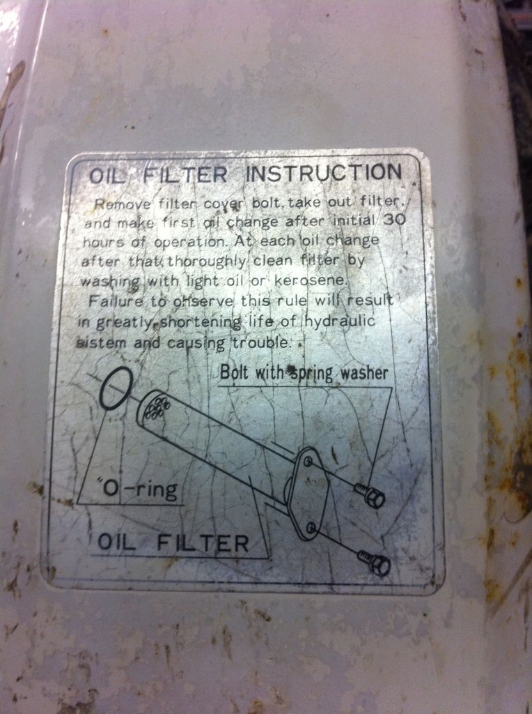

Found this little Gem while cruising craigslist. Seems like a low hour unit (no hour meter). It does have the CCW PTO, but someone put an adapter on it for the correct 6 spline shaft. I got a 54" finish mower with it. I'm going to restore her up nice and make a front snow/dozer blade for it and hope to find a small loader to put on it. It runs great and everything works as it should. I have changed all the fluids so far. The transmission has some water in it, and i'm guessing it was because the cap was off and it sat outside. It just just had a plastic plug in it. I drained it, flushed with ATF and diesel fuel, put clean ATF in it and ran it some more and drained again. Up in the air what kind of fluid to put back in it. tag says SAE #80, but I plan on putting a Kubota front blade on it off of my other tractor. any thoughts?

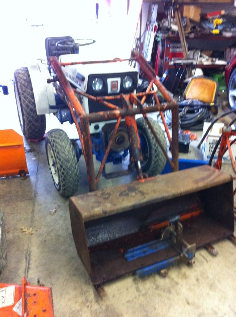

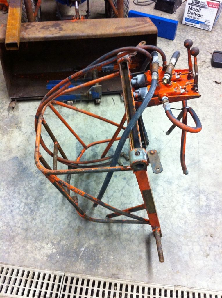

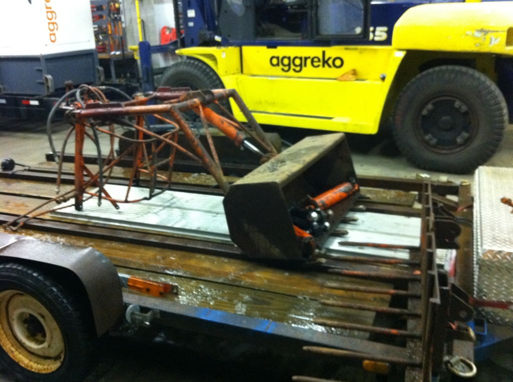

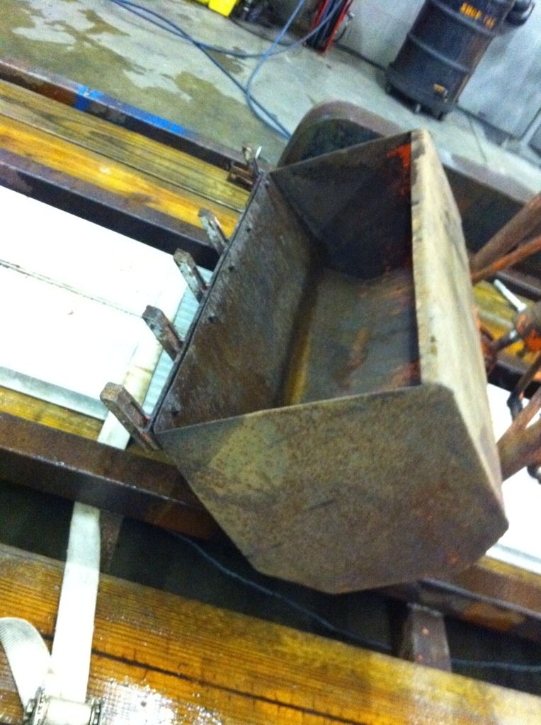

I'd love to... I just picked up a 42" wide bucket FEL setup off of an old economy tractor. I did a little trading and got the complete setup with full hydraulics, Hyd tank, Hyd pump, lines and a hay fork setup. I'm going to have to length the arms a little bit. I've got next to nothing in this setup. I'm looking forward to playing with it in the next two weeks with the down time at work. It doesn't look like the subframe mount will be too hard to fabricate and I have 90% of the material.. Wish me luck.
   / New Satoh S370D owner #5
that loader looks very twinky...I think you will just tear it apart on your mitsubishi...
I would take the hydraulics, maybe the bucket (even that looks thin) and plan on making a new set of arms, subframe and grill guard.
I have a loader on my 332 garden tractor that looks like it would bend that one into a pretzel. With 4wd and more weight you will have even more tractor power than my 2wd garden tractor.
I bet the tractor hydraulic pump would be sufficient to run the loader. I think that is how the ones that were sold for these tractors were run.
