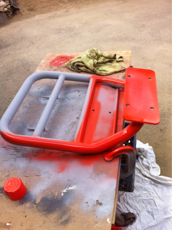

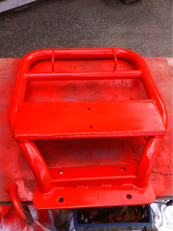

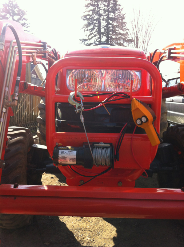

Trying this out in the morning to pull small brush if it works then we will buy a 12,000 lb winch

Hi,
While the idea is good...the tubing is too light to pull from. Maybe you can get the mount to go to the 4 holes that bolt to the front frame?
Those Kioti brush guards are not nearly as strong as the old style.
Good Luck
Dave G.
