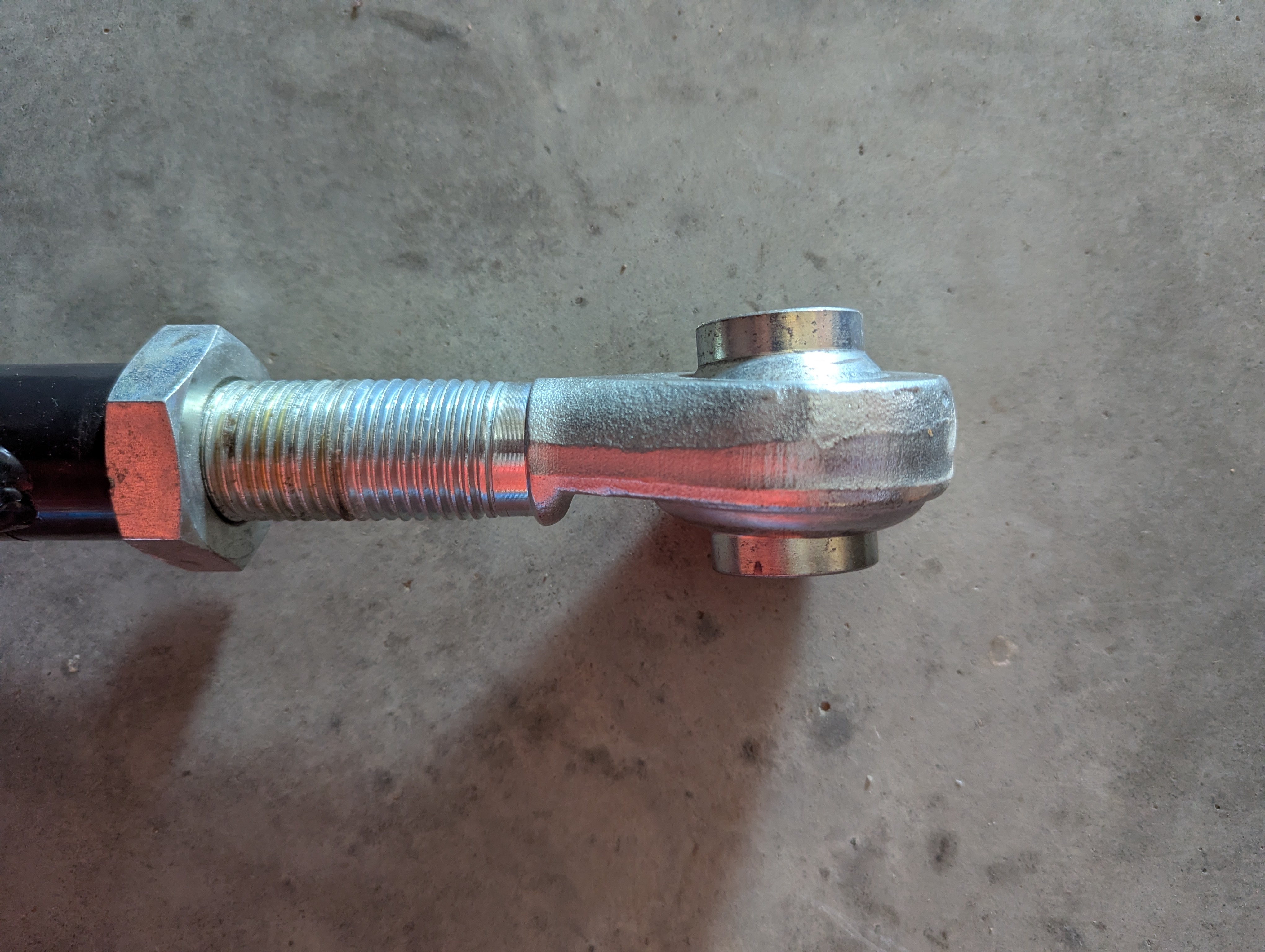

2. Any suggestions on how I can modify this top link connection in the pictures? Any extensions? Adapters? I have a heavy hitch trailer mover that is Cat 1 and new tractor is Cat 2. The "ears" on the ball joint wont allow it to fit in between the top link connection (width) for the hitch. I can't seem to find another Cat 2 ball that doesn't have the ears on the ends. I love my old Mahindra that has both Cat1 and Cat2 in one swivel ball but I can't find a replacement repair end I believe they call it. I have searched high and low for any adapter etc but perhaps I am looking for the wrong terms.

Thank you D&D. For point 2, I looked at those but was hoping I could get just the repair end (the part that connects to the implement not the tractor) being cat 1 but the thread size is often too small. Should be 1 1/8 for a larger Cat 2 top link.
   / New RX730P - Couple of questions as a new owner #4
next thought then, have a machine shop (or you) make a threaded insert for the cat 2 to cat 1
   / New RX730P - Couple of questions as a new owner #5
Just grind the cat 2 end down far enough that it will fit between the ears of the implement.
Use a bushing to reduce the 1" dia down to the 3/4" dia of the cat 1 implement and still work fine for any cat 2 implement.
I imagine that this would cost all of maybe $2 for the reducer bushing and maybe 10-15 minutes of grinding time, and that's if you are not set up for it. If you are set up for it, maybe 3-4 minutes.

Thank you. I thought about grinding it. All I have is a cutoff wheel and I would need to figure out how to secure it while cutting then perhaps hand file it clean. Just didn't want to look at the ugly cutting job on a brand new piece of equipment. :)

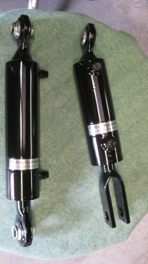

You could always just get a Hydraulic top & tilt set, no grinding required. ;)
Get a hydraulic top link. They are awesome to be able to adjust an implement. I got a quick hitch for mine also which is cat 1 and I did have to grind the balls slightly to make them fit.

J&K I appreciate the detailed reply. Its helpful. I will check out a hydraulic top link. I have been considering a quick hitch as I am not getting any younger. Ill have to see what brands and build quality look like.

I ground my top link too, Had one piece of equipment where it was 1/8 of an inch or so too wide. Did that years ago no issues so far.
