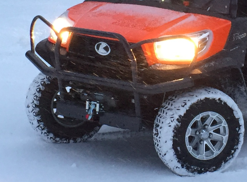

It's fairly easy to mount a winch in the front bumper, and the holes matched up to the Warn 3000 I bought. Hardest part was running the wiring to the battery. Sorry I don't have a better pic than this:
Here's the winch I got: Warn Industries - ATV & Side X Side Winches: Vantage 3000-s
It was on sale at Northern tool last winter and I had a $50 coupon, so it was a good deal. I set mine up with the plug for the winch's wired remote hidden under the hood. I did not wire up the permanent switch, since there wasn't a clean way to mount it in the dash and I figured I could just use the wired remote from inside the RTV just as easily.

Get one with roller guides if you can. Cost a little bit more but the cable will last a whole lot longer and it's safer too.

You can buy the fair lead separately, if you find a good deal on a winch you like, which doesn't have one. They run around $30-60, for an UTV sized winch fairlead.
