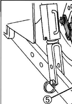

After nearly 20 years using a Fred Cain 5' cutter behind my Kubota 4630 I finally purchased a 6' Woods 72X mainly so that the added width wood cover my tire tracks. I'm having problems getting enough lift in the cutter. When set up according to the manufactures instructions the tail wheel will only come a couple of inches off the ground. Is this normal? If I shorten the break link all of the way the lift increases but then I would have readjust constantly. I have put the top link in the lowest hole on the tractor which also helped. Is there something that i am missing in the adjustment process? Thanks for your help

From pics it looks like the Wood's top link pin is farther forward than the bottom link pins. So you'd need to shorten your top link when using the mower.

Move the lifting struts for the arms to a hole farther away from the implement so they give you more lift. I has a similar problem with a disk and had to move the struts to the front hole to get enough lift.

Thanks for all of your replies. I believe I've solved the problem. Attaching the lift arms to a lower hole on the cutter seemed to solve the lift problem and still have the break link adjusted according to manufacturers instructions. The instructions never mentions changing lifting points. The tractor has plenty of lift capacity. This cutter is brand new and I haven't had the opportunity with all of the rain we've been getting to try it out. I'll let yu now how it goes. Thanks again for your input
