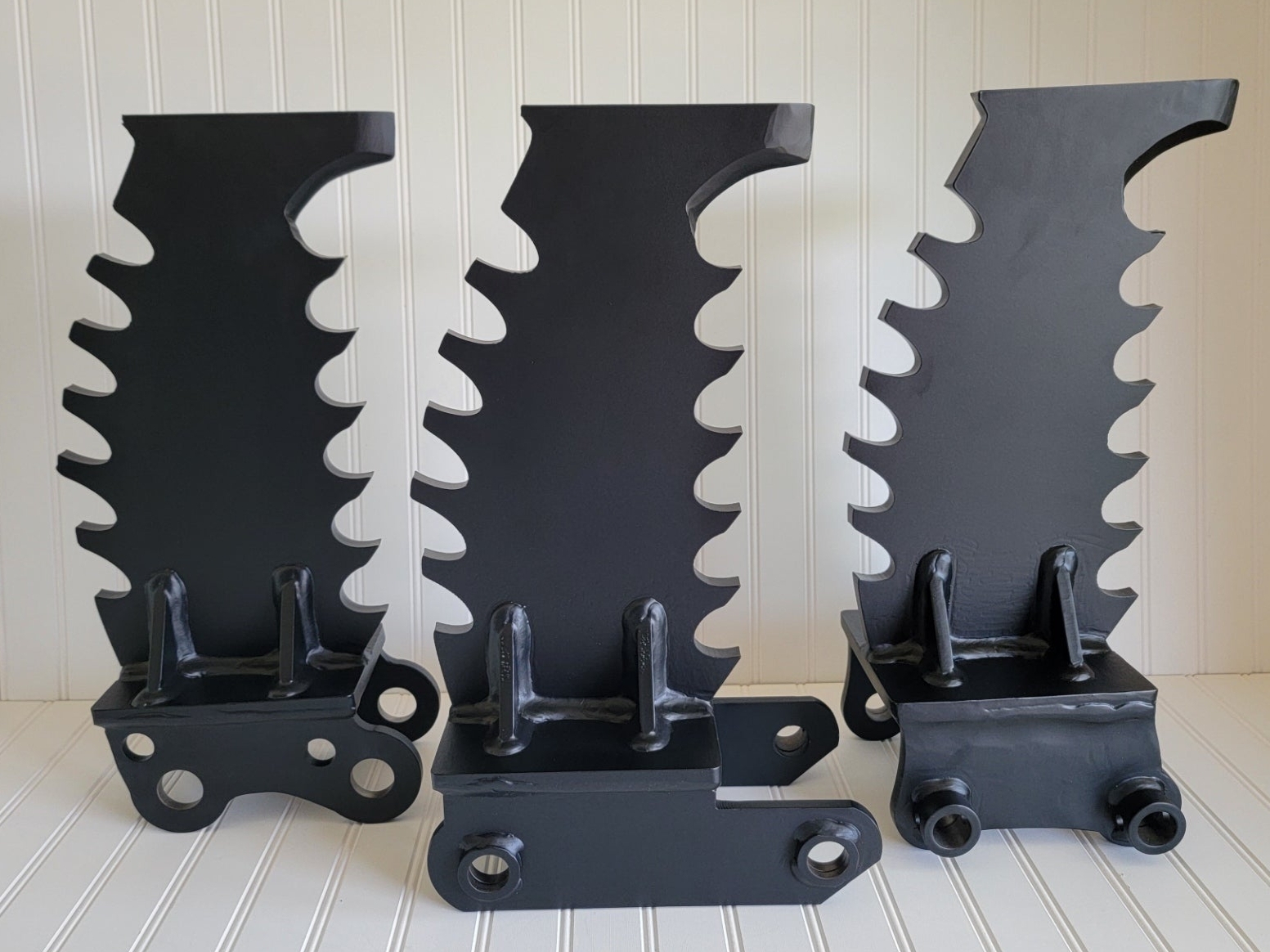

This is a new more aggressive design. It is getting great reviews. It works well backward and forward.

Hi Gofast,
I would like to know what grade metal these rippers are fabricated from.
Also do they have a sharpened edge or is it just squared off.
And I'm guessing they install with the existing MF bucket pins.
I have a CB 05 BH.
Thanks, KC
   / New Root Ripper design BH-2720, CB-65, CB-75, CB-86, BH3222, CB-05, 2375, CB-10, CB-20, 1580
The blade it 5/8” A36 Steel top plate is ½” CB – 05 ears that the pins go though is 3/8” just like factory bucket.
The front are pretty sharp the back are more blunt but you are pushing with those.
Yes it works with your factory pins. We also have a 6” trenching bucket for the CB – 05.
We currently have one CB -05 Root Ripper and Trenching bucket in stock ready to ship.
