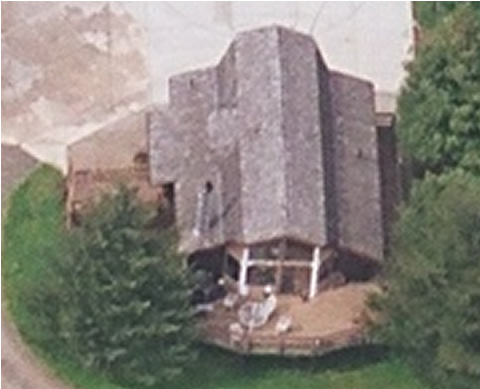

So let's see if I can answer a couple questions, clarify my thoughts, and summarize a bit. /forums/images/graemlins/mad.gif
I have attached a .jpg cropped out of a larger aerial shot of the property to show this roof. It's pretty fuzzy since it is cropped out of a much larger area, but it should help visualize what I'm talking about.

So I am guessing several of you will bite my head off for not wanting air flow, and sounds like some agree that this can work. AGAIN let me reiterate (contrary to GuglioLS's flattery), I don't know much about this, but have just been thinking on it for a long time and trying to figure out what should work.
I would sure love any pointers to roofing concepts like this (open beam ceiling, exterior insulation, etc.)
Thanks! I really appreciate all the discussion and ideas floating around. /forums/images/graemlins/smirk.gif /forums/images/graemlins/smirk.gif /forums/images/graemlins/smirk.gif

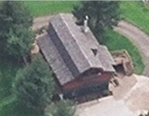

Here's another view from the other direction. In this one you can sort of see a dormer on the right side of the ridge line, we want to put two like it on the left side to push out some space in the loft bedroom and office. Those would face west and pick up the sunrise and a perfect view of Mount Hood. /forums/images/graemlins/smirk.gif
