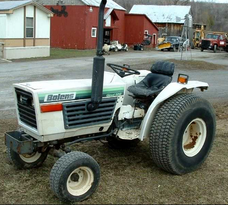

I have a bolens G274 with some pretty rusted out rims. Especially the part where the valve stem is. I can poke the inner tube with my finger. Does anyone have a place I can find replacement rims? The tires currently on there are 355/80D20. They are a bit dry rotted but still look useable, but I would even be open to getting a different size rim and tire combo if that is an option. How could I search for the rims? Width, height, bolt pattern, mounting plate inset (sorry I don’t know the technical term) etc..

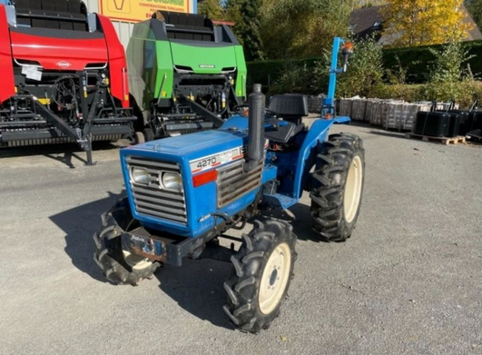

You know the Bolens G274 is really a Iseki TE4270. Just a different paint job.
Chances are Iskei rims fit just fine.

Thanks for that. Yeah I looked for rims for iseki too and couldn’t come up with anything. I need rear and front but the rear are in worse shape. I saw in another forum that kubota rims might fit but idk how to make sure before I order them.

It doesn’t look like it. Mine has a 6 bolt pattern. Those seem to have more

I think I’ll end up welding them up. Hopefully it’s not too bad of a job

I’m pretty sure there’s calcium in there given the age. Think I’ll just leave them dry once I get them put back on. Do you think there will be much of a difference in the snow without the ballast? They’re turf tread
