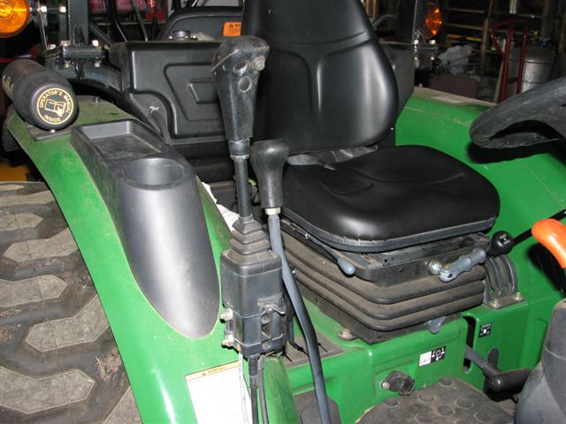

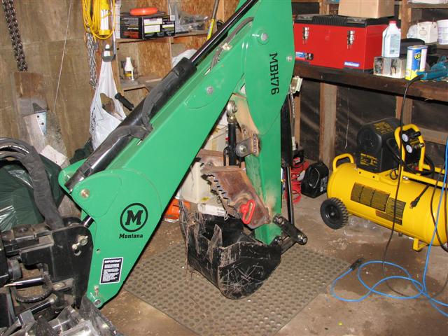

Yes the price it included all hoses and all. I believe the third hydraulic is operated by one of the hoses on the FEL. I have taken a few pics will try to include them into this post.
