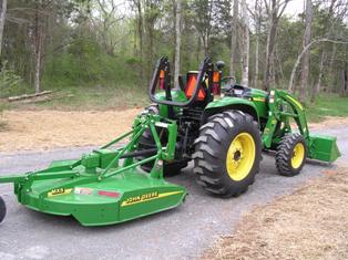

Just wanted to say thanks for all the info from everyone and all the informative posts; pulled the trigger on the 4120 last March and have been extremely pleased with it so far. Glad I went with the bigger machine versus the 3720. See the attached photo. Thanks again!
