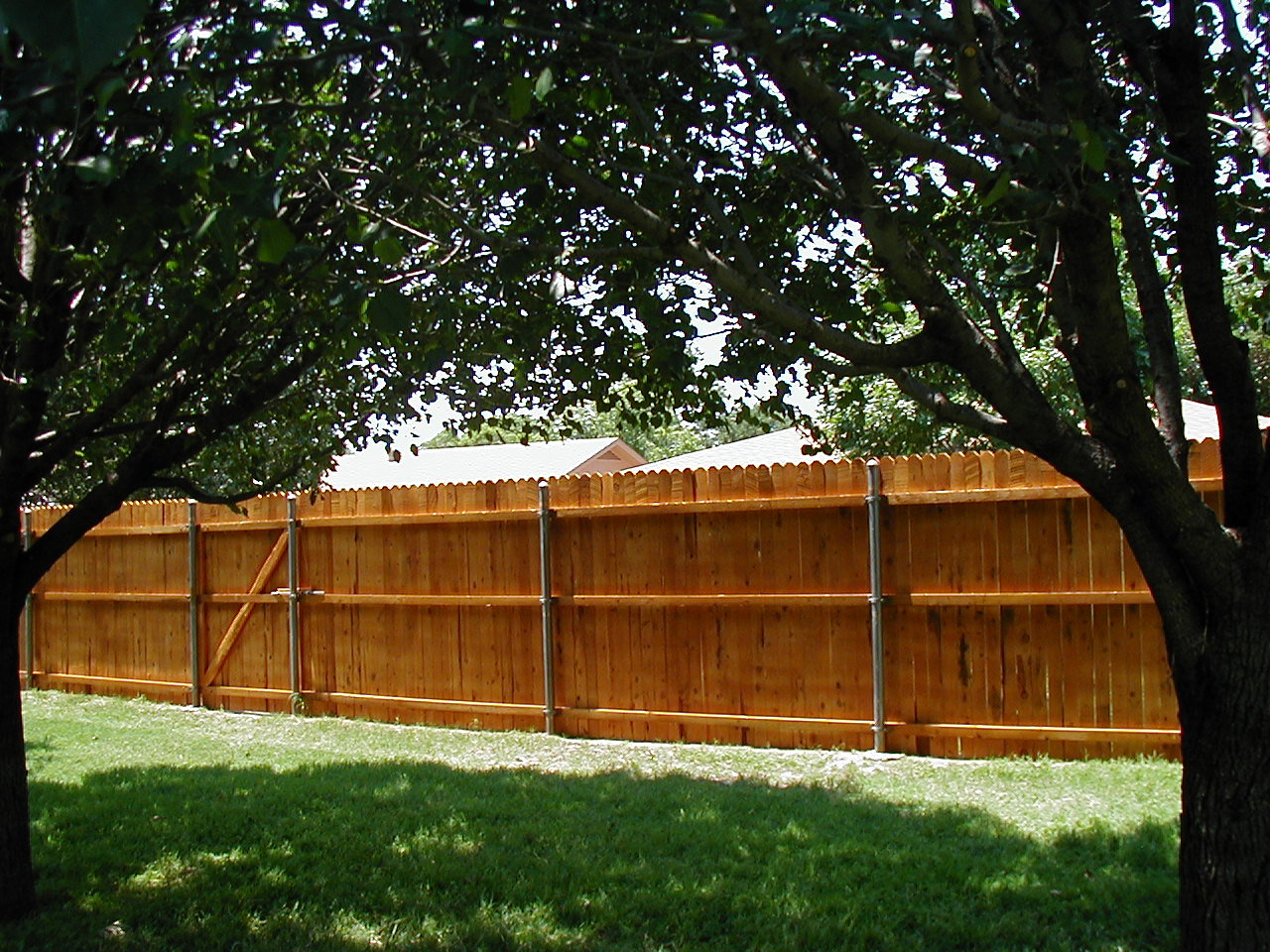

I don't know if I should rent a paint sprayer, buy a pump sprayer, pump sprayer + backbrush, airless sprayer, etc etc. No clue! Just want to protect my nice new fence and make it last a long, long time. Also don't want to die of heat exhaustion, and don't want to make a career out of it. What should I do? It's new treated pine. How long should I wait to stain it? Thanks! :)

I'm not sure how long you'd need to wait, but when we put up a new fence in May 2006 (untreated panels from Home Depot) I used my one quart paint spray gun and applied Thompson's Advanced Water Seal in the Honey Gold tint. Unlike the old oil based Thompson's the Advanced is water based, easy cleanup. One thing I learned is that you must apply as much as you want initially, you cannot go back and apply a second coat after it has started to dry, as you can with paint, because it sheds water and your second coat will just bead up and run off. So, as you can see in the picture, my spray job was a bit lighter in places than others. Now after 4 years (it's supposed to be good for 3) the neighbor behind me rented an airless spray rig from Home Depot and applied another coat, so it now looks even better and should be good for another 3 or 4 years, but I don't have a new picture.
So, for me, personally, a spray rig and Thompson's Advanced would be a good choice, although I know there are other good products, too.
