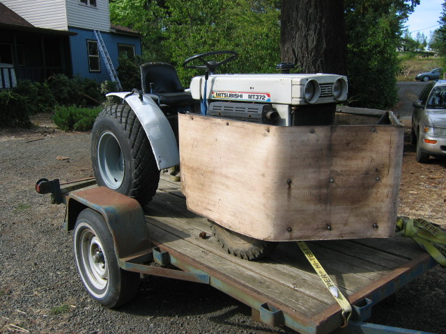

Well... I went ahead and did it. The same feeling as when I bought my first car many years ago. I think it is going to be a lot of fun. In between the test drive and picking it up the water pump went out. The guy kicked a few hundred off the price and I took it home anyway. The first project will be tracking down a pump and taking off the christmas tree skirting before getting into the pump. Sweet!
Thanks for the suggestions and encouragement.

A & T Parts & Rebuilders these guys can rebuild your water pump. i used them before and they did a good job. the tractor looks nice.just send out the pump to them and u get it back in a few days and you will be tilling the garden.
