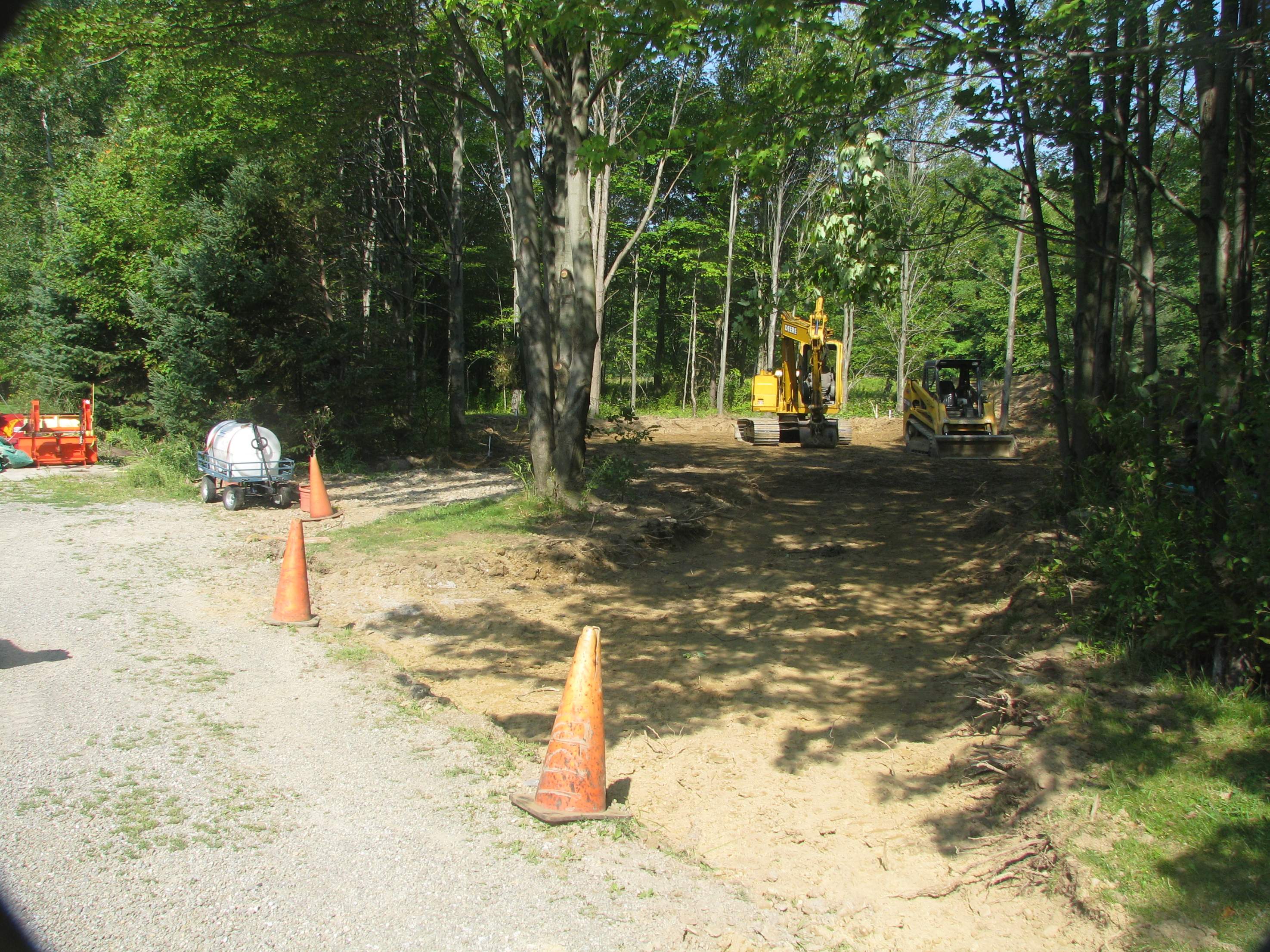

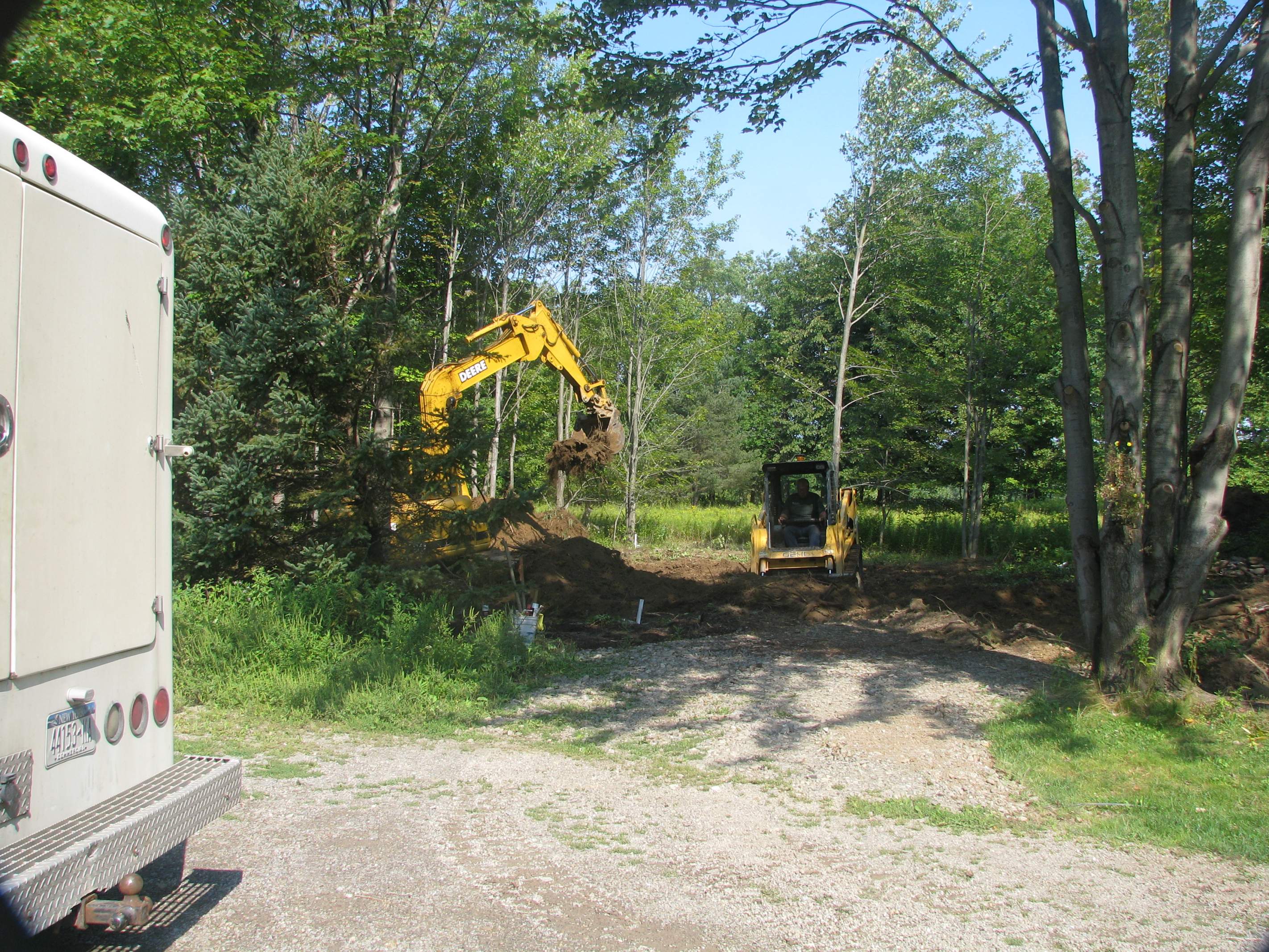

   / New Pole Barn - Orchard Park NY

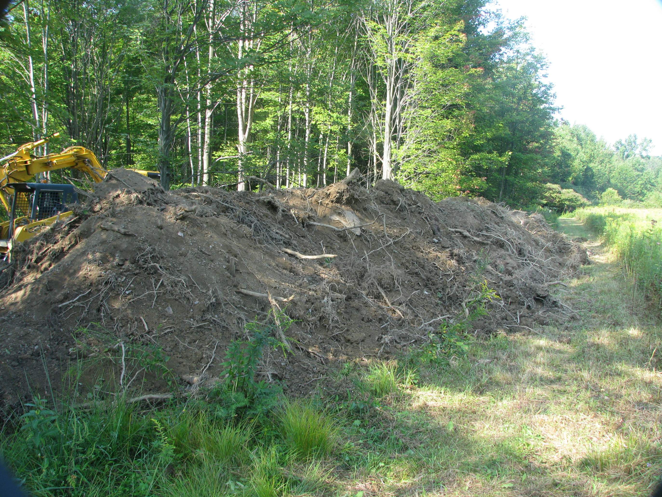

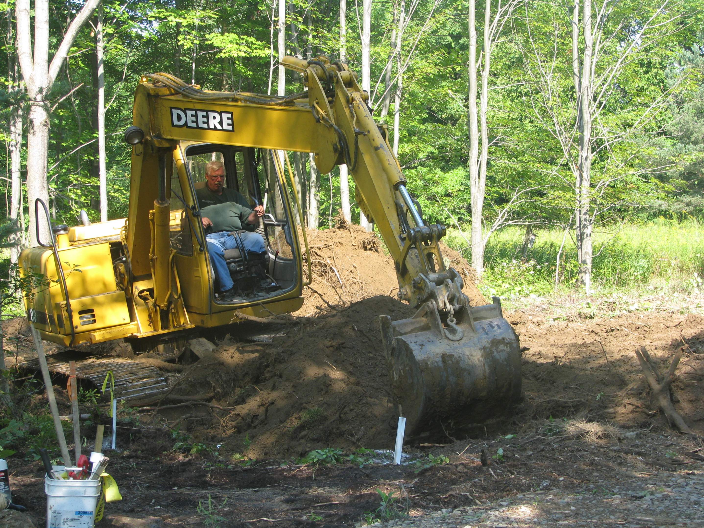

Here are some pictures of the site being prepared.

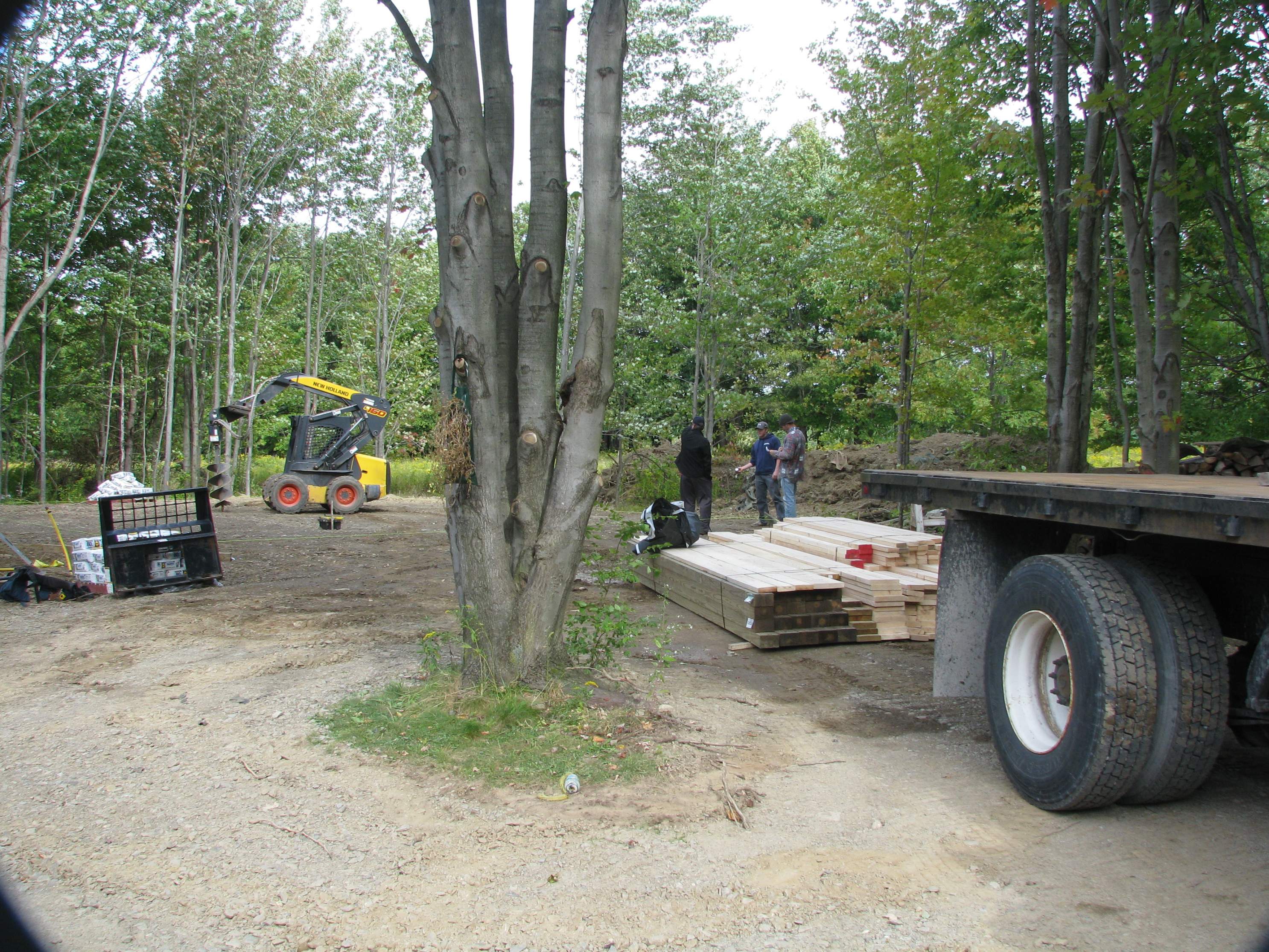

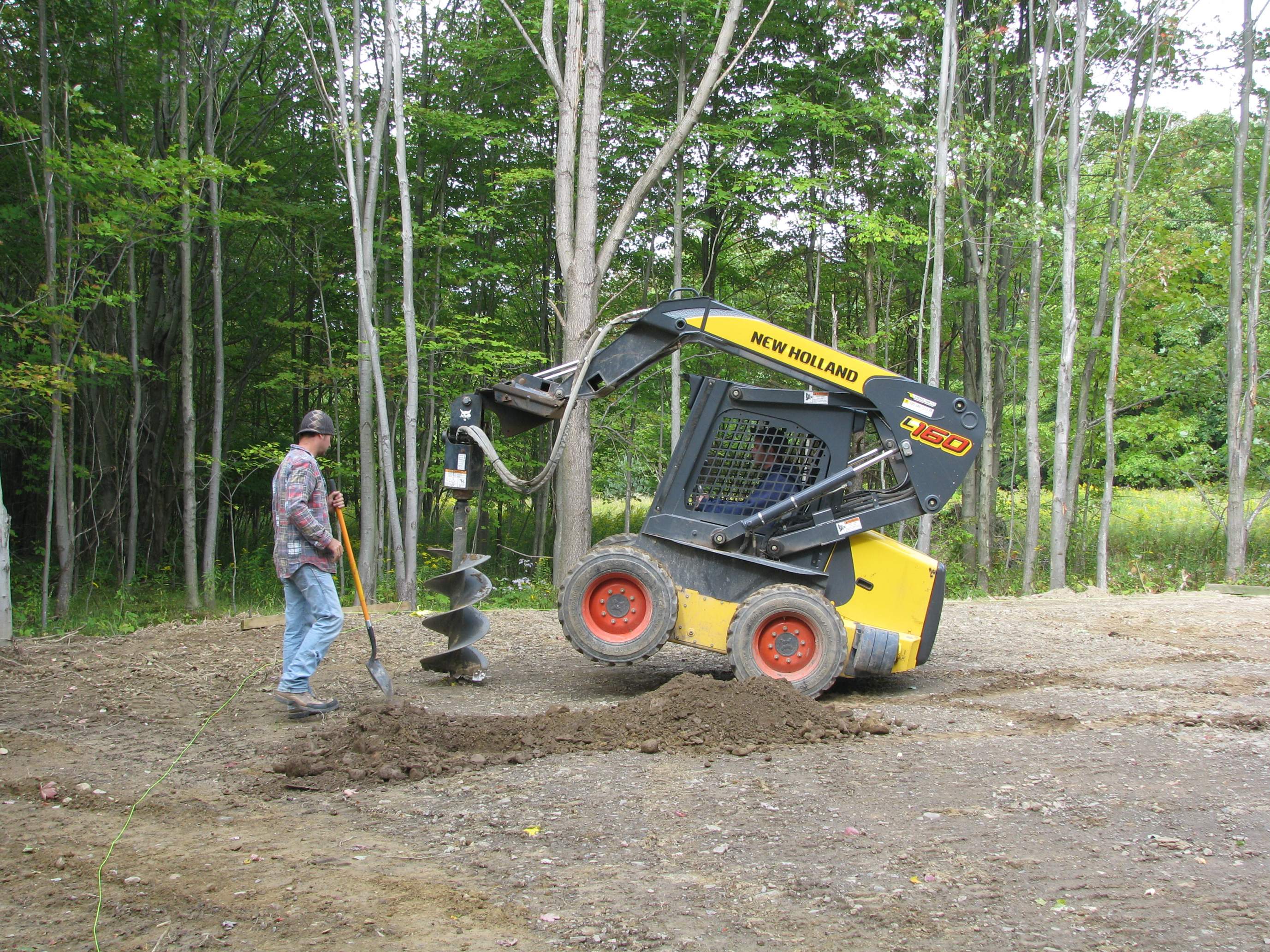

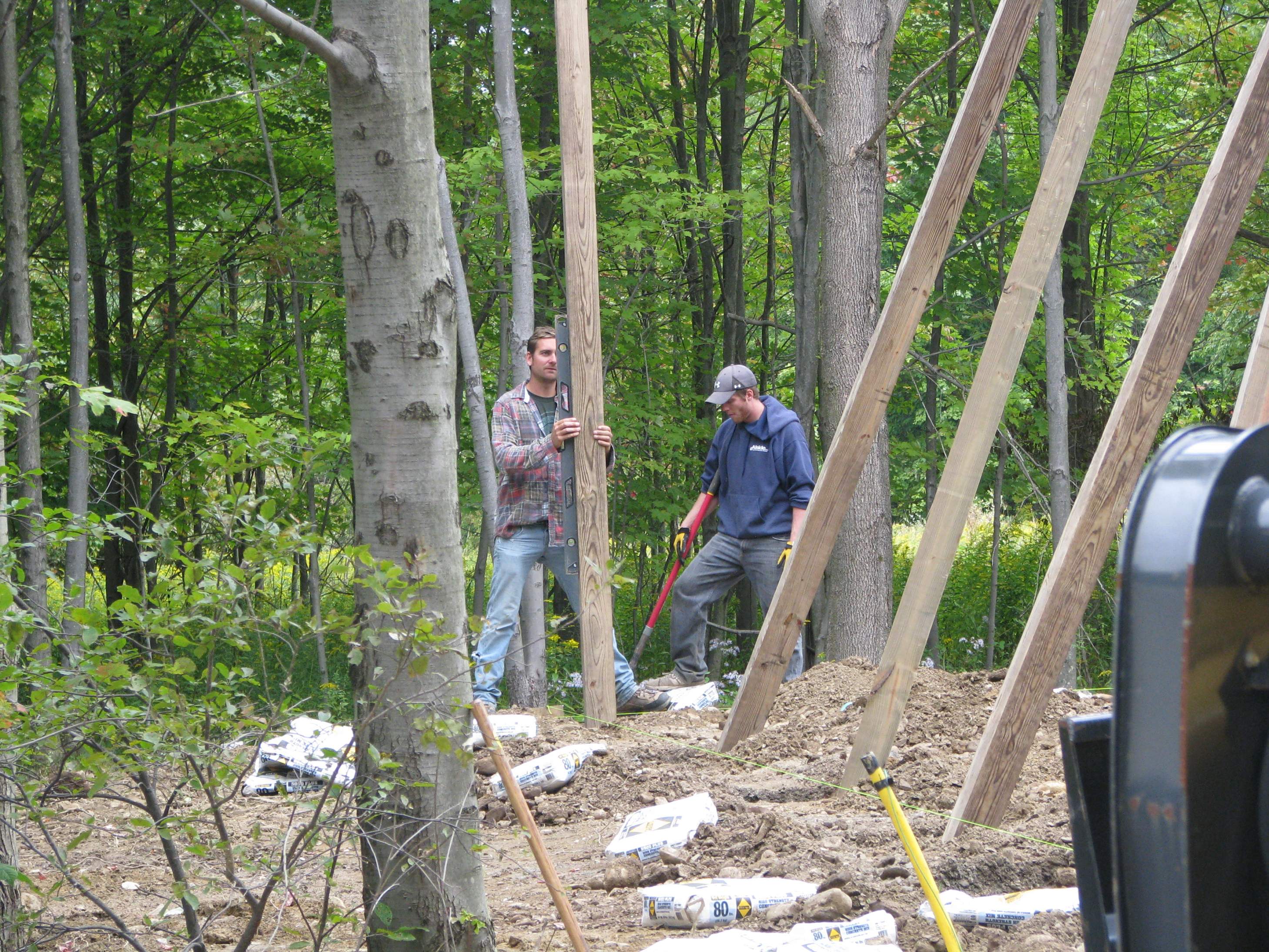

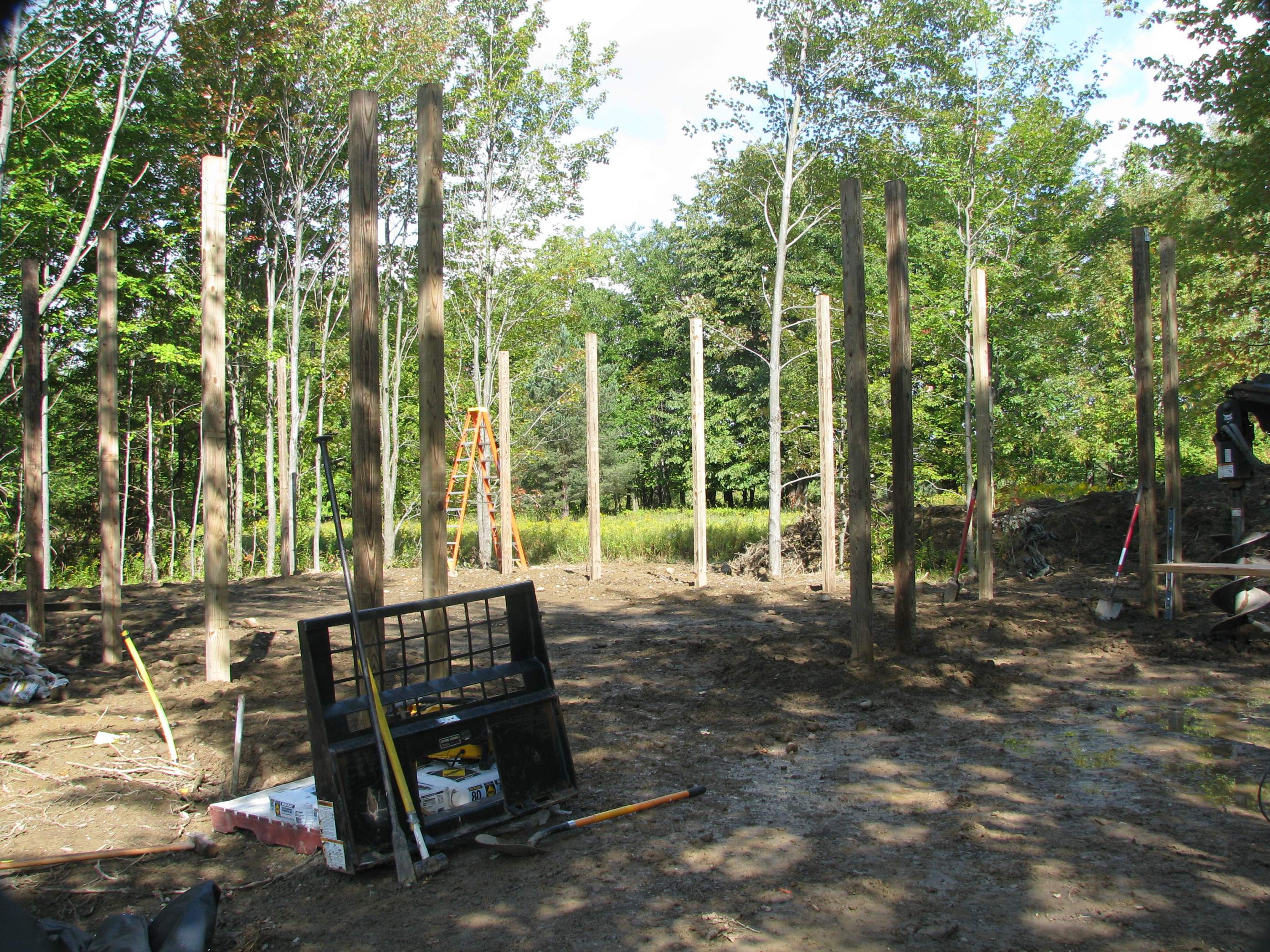

Posts go in...
- 4"x6" posts, 8' on center
- Holes 48" deep
- Put rebar through the bottom of each post
- Used 2 bags of concrete per hole
All holes drilled on day 1, with 80% of posts installed. Finished all posts on day 2...

What was the rebar for?
The holes themselves were about 2' across, the put a piece of rebar thru the bottom of each post that stuck out about 8" on either side.
They do this to improve the concrete/post connection.

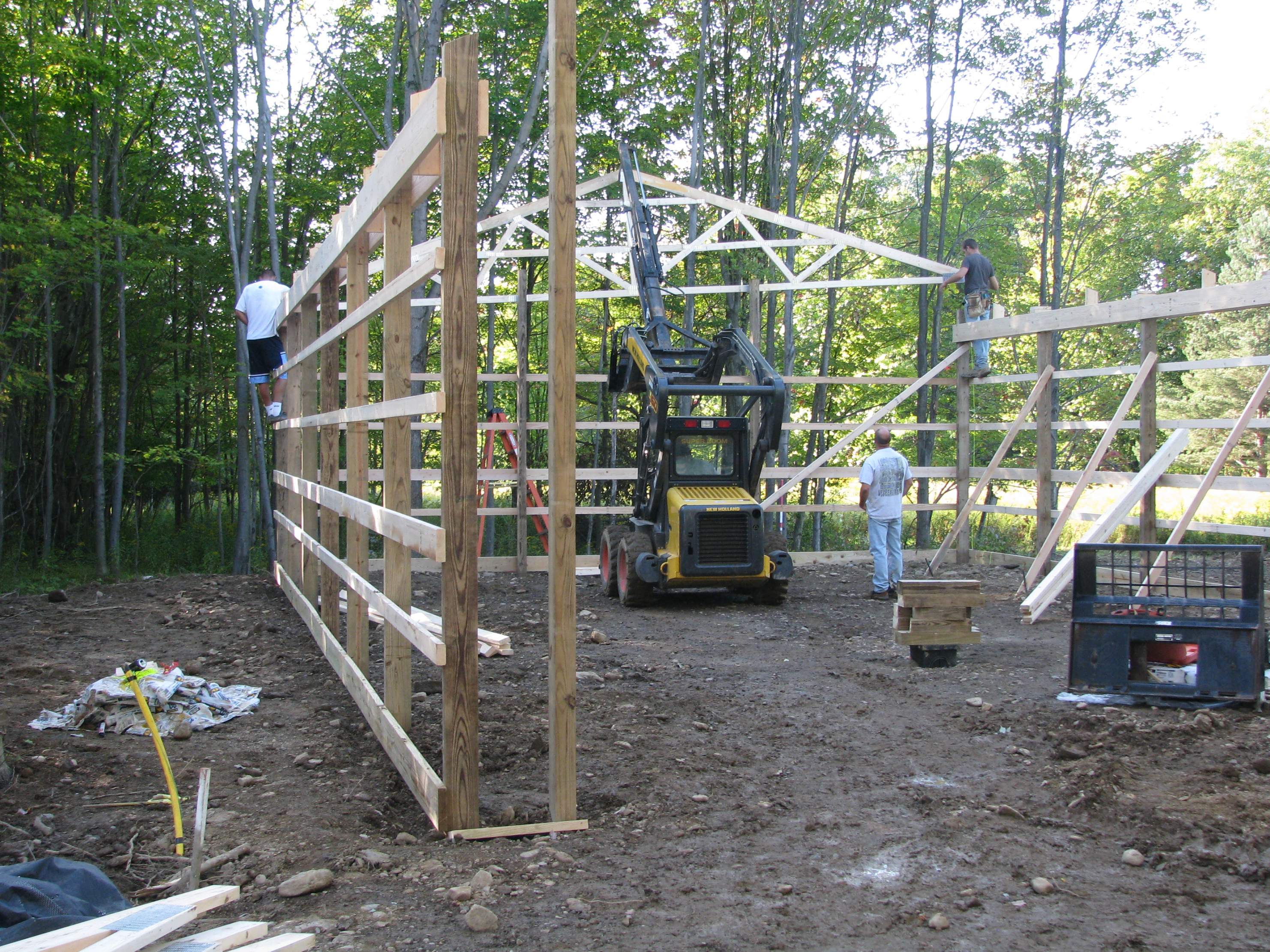

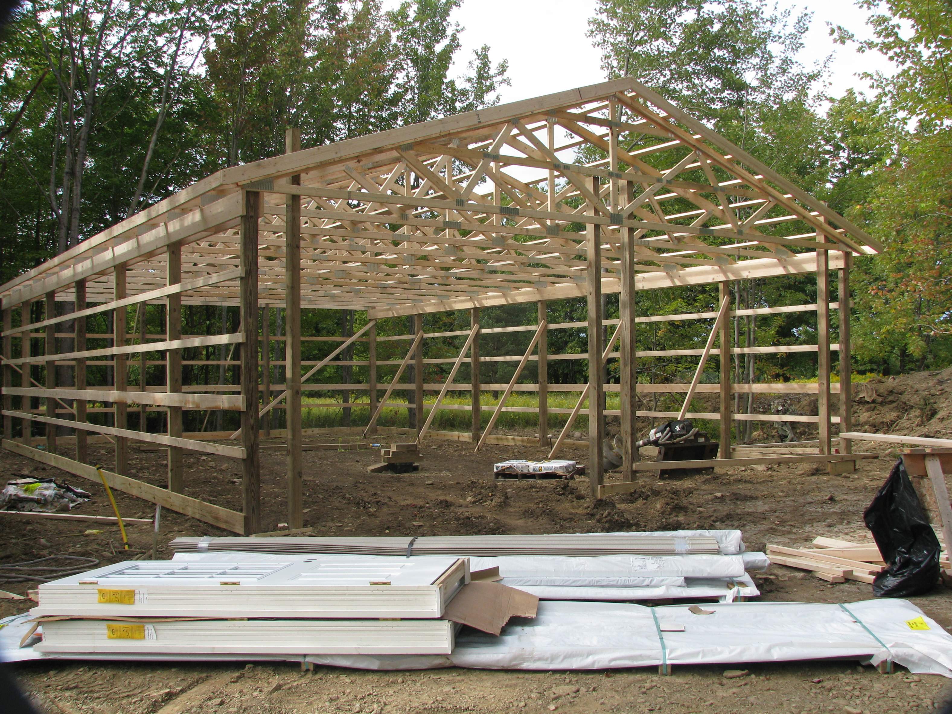

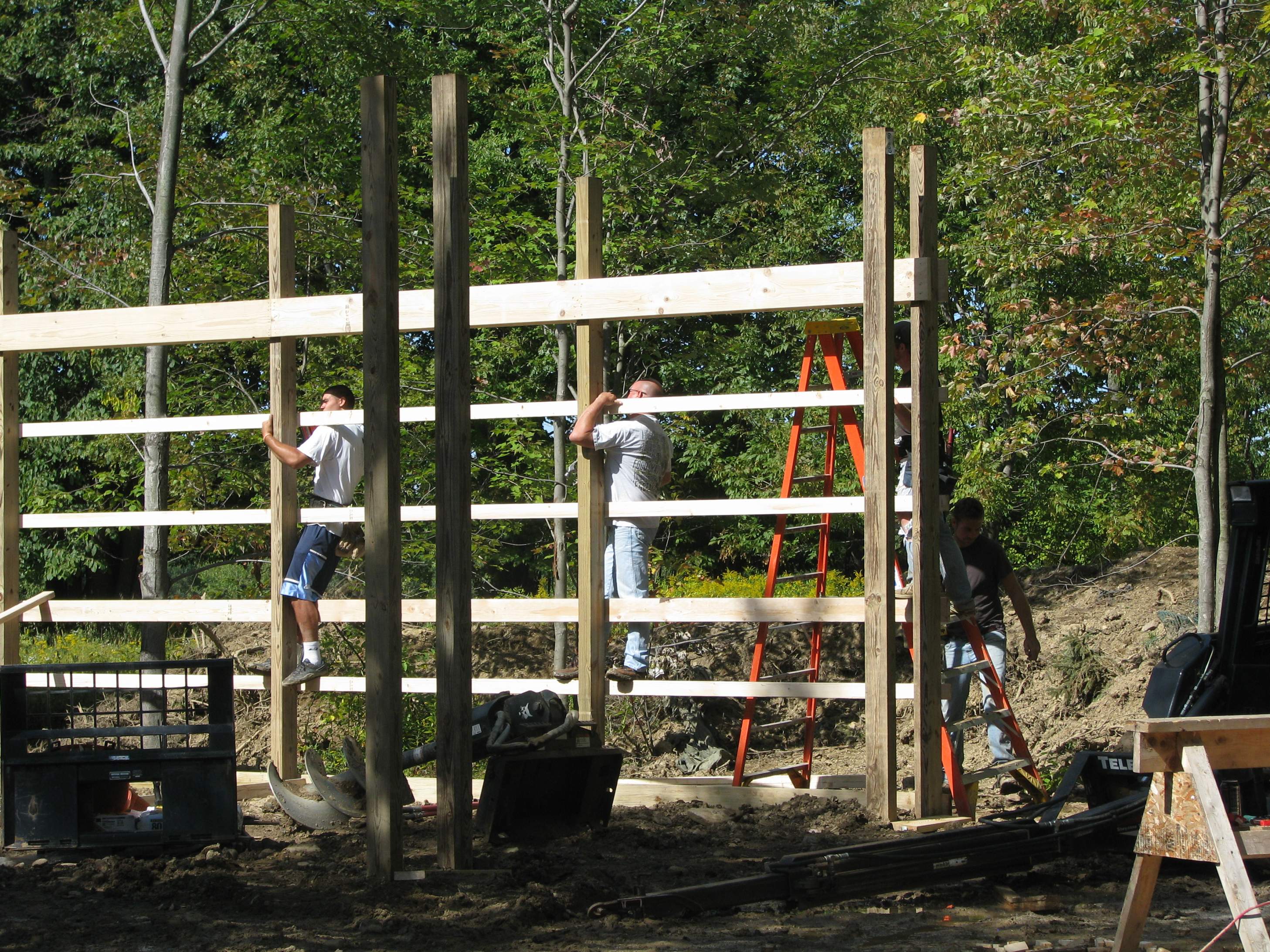

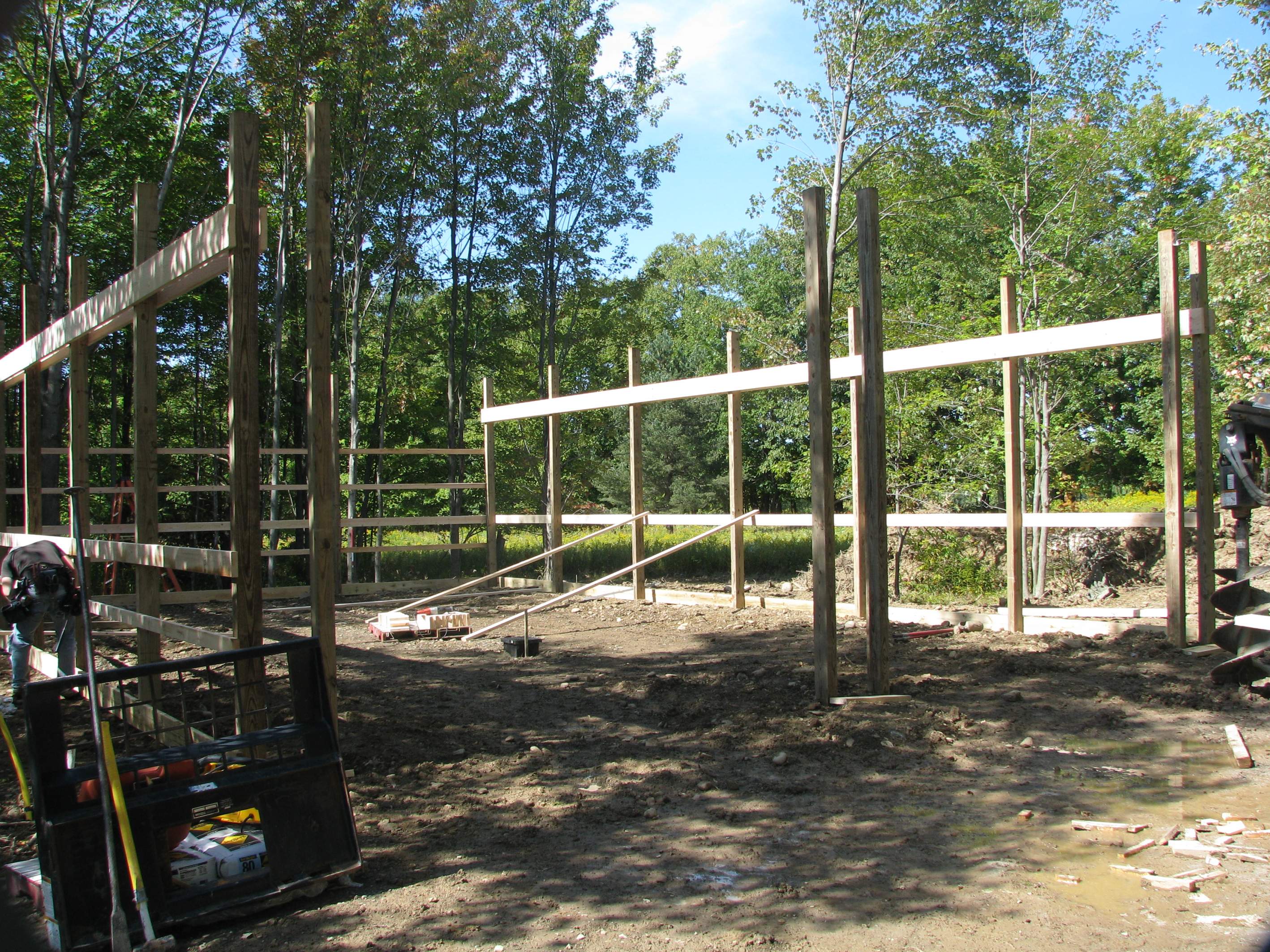

Here are some framing pics... amazing how quickly (and accurately) they put this together!

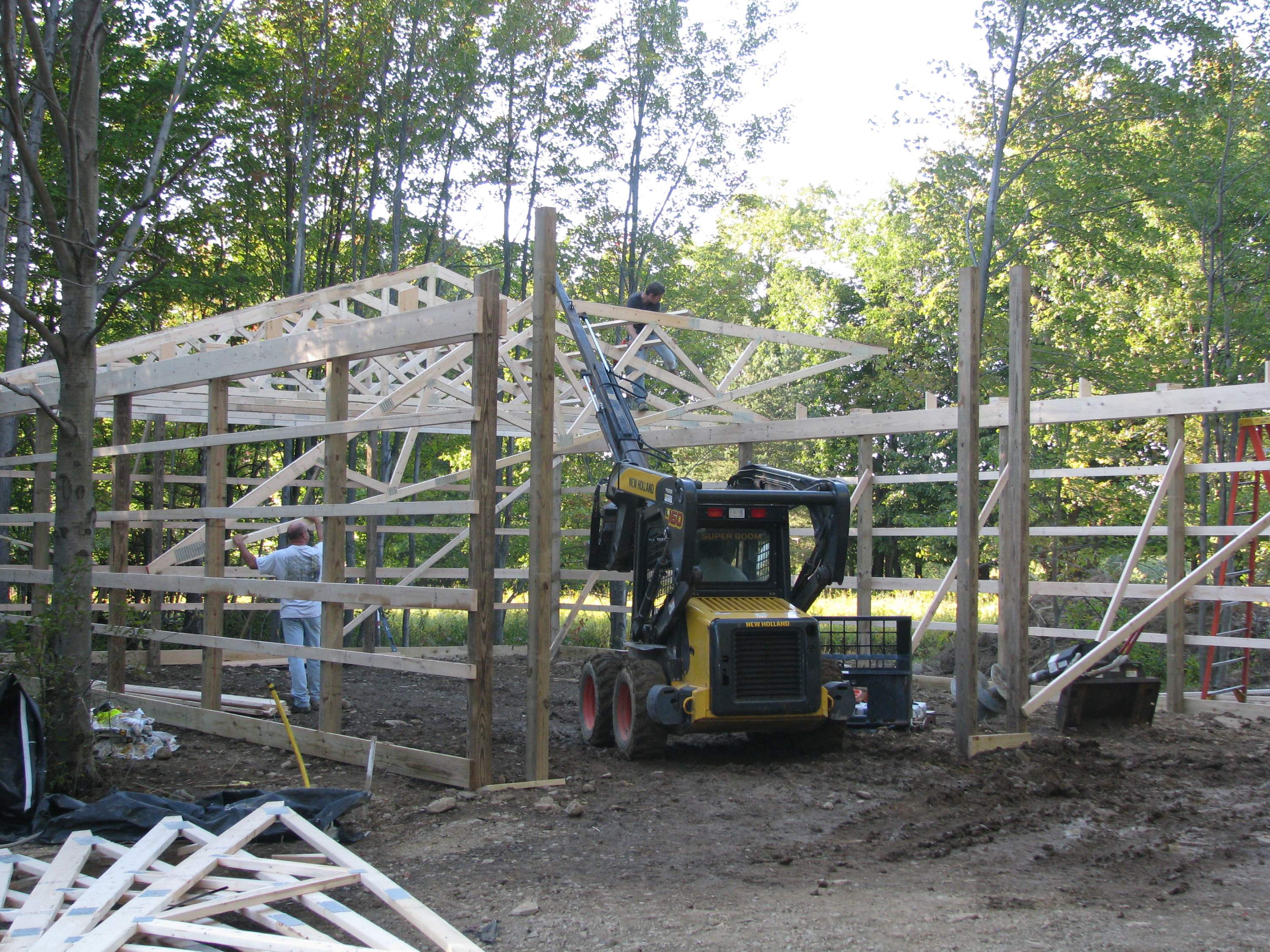

Roof trusses were next...
Their roller trailer made unloading a breeze.
They only needed 3 guys to put up the trusses - one to operate the loader with it's handy boom attachment and then one guy on each side of the truss to attach it! (There's one pic w/a 4th guy - it was the company owner stopping by to make sure work was up to snuff).
