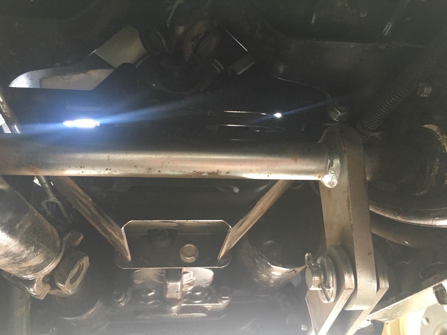

Took delivery of my new SA324 with fel about a month ago so far I love it except the HST fan which I shredded Saturday going to my dealer Saturday to order parts.

i ran across a limb or something that ripped all the blades off the fan before i could shut off the engine.
"YANMAR TRACTOR" is a factory guy that monitors the forum he sent the following parts list that is a fan cover i have ordered these and will install them myself
there is another post on here that has pictures of the parts
http://www.tractorbynet.com/forums/yanmar-new/388161-screening-protect-hydros.html
These are the 6 parts involved in the fan guard kit:
A8330-99730 Cover, Fan 1
26106-080402 Bolt, 8X40 2
1A8330-99740 Spacer 2
0F041-EN0340 Assembly Brief 1
1A8330-99710 Stay Assembly, Cover 1
26106-080162 Bolt, 8X16 6
   / New owner #6
Wow, that is a bunch of money for something that costs about $10 to make and should have been installed before it left the factory.
At least the guard should come with the FEL, since a FEL tractor is much more likely to leave the fields.
so that is over a 10x mark-up to fix a known shortcoming in the basic design.
   / New owner #7
