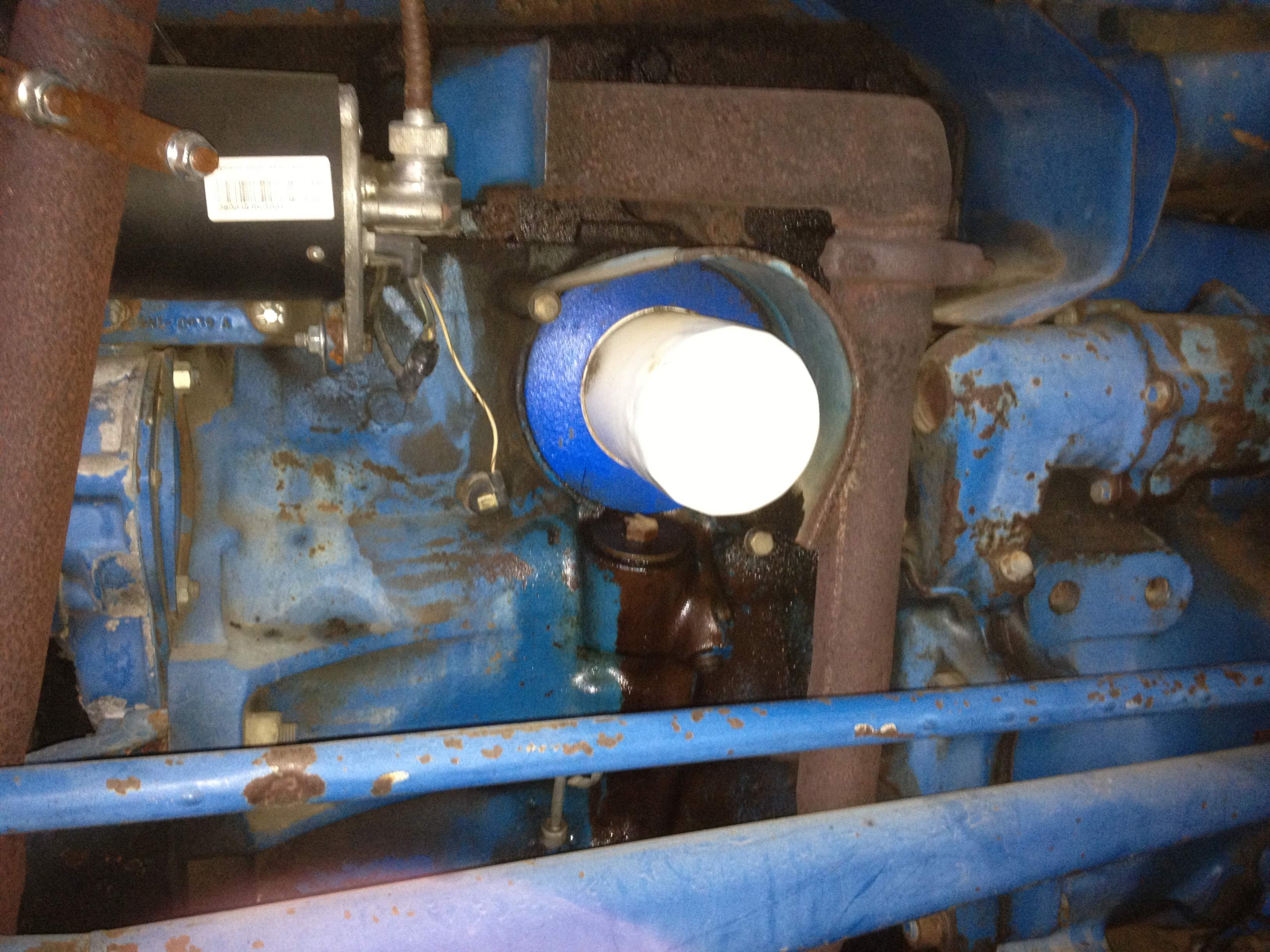

Secondly, at some point in the past, someone added a screw on oil filter adapter to the 2000. This leaks oil (I believe between the block and the adapter) and the filter has been on so long that there are no longer any identifiable markings for it's brand, model number, etc. I took some pictures for you if it will help. In this instance, how can I identify which replacement oil filter to use?

As for oil filter my 3000 uses a Fram PH8A. Yours may be the same, but I don't recommend Fram filters, just use the number as a cross reference to a different brand.

The spin on adapter for your 3 cylinder 2000 is designed to use the same spin on filter as do the later tractors originally equipped with spin on filters.

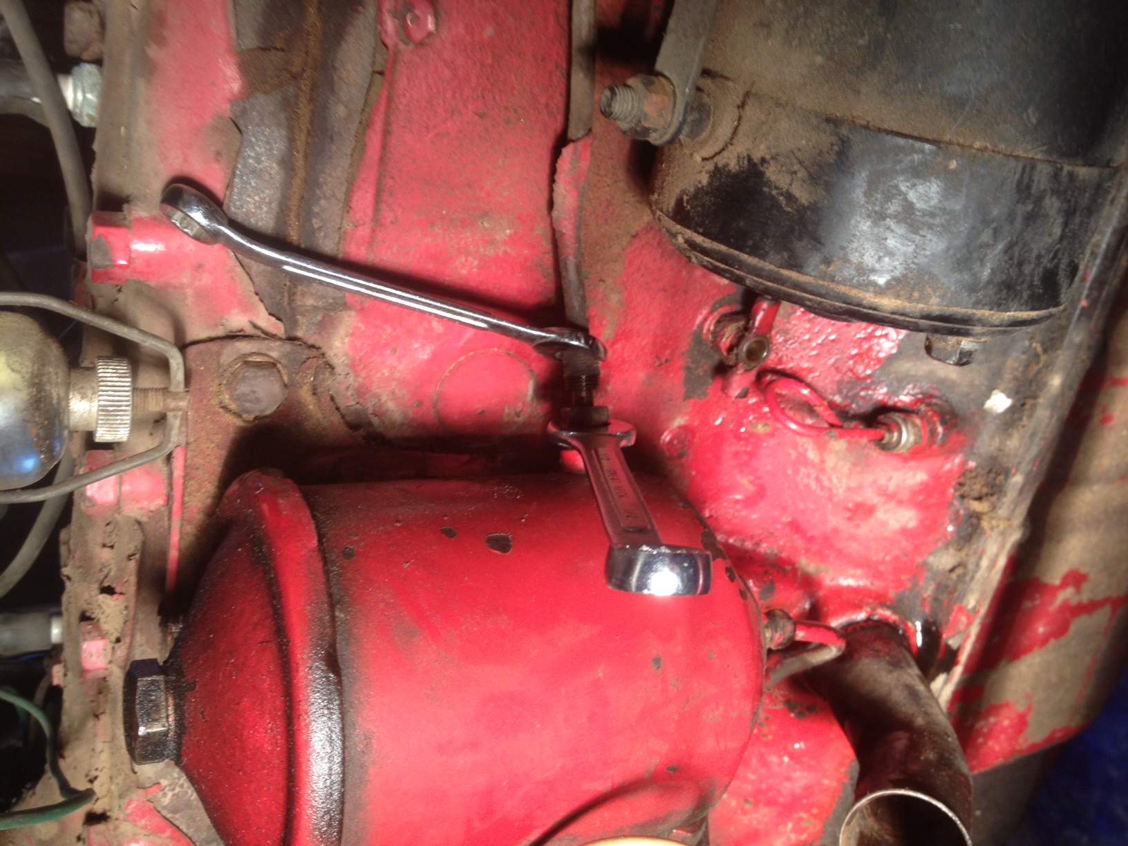

When you change the engine oil in your 8N the first time it is advisable to remove the oil filter canister and thoroughly clean the sediment from the bottom. Likely this has not been done since rebuild if at all. Use two proper wrenches when removing the oil lines from the canister.

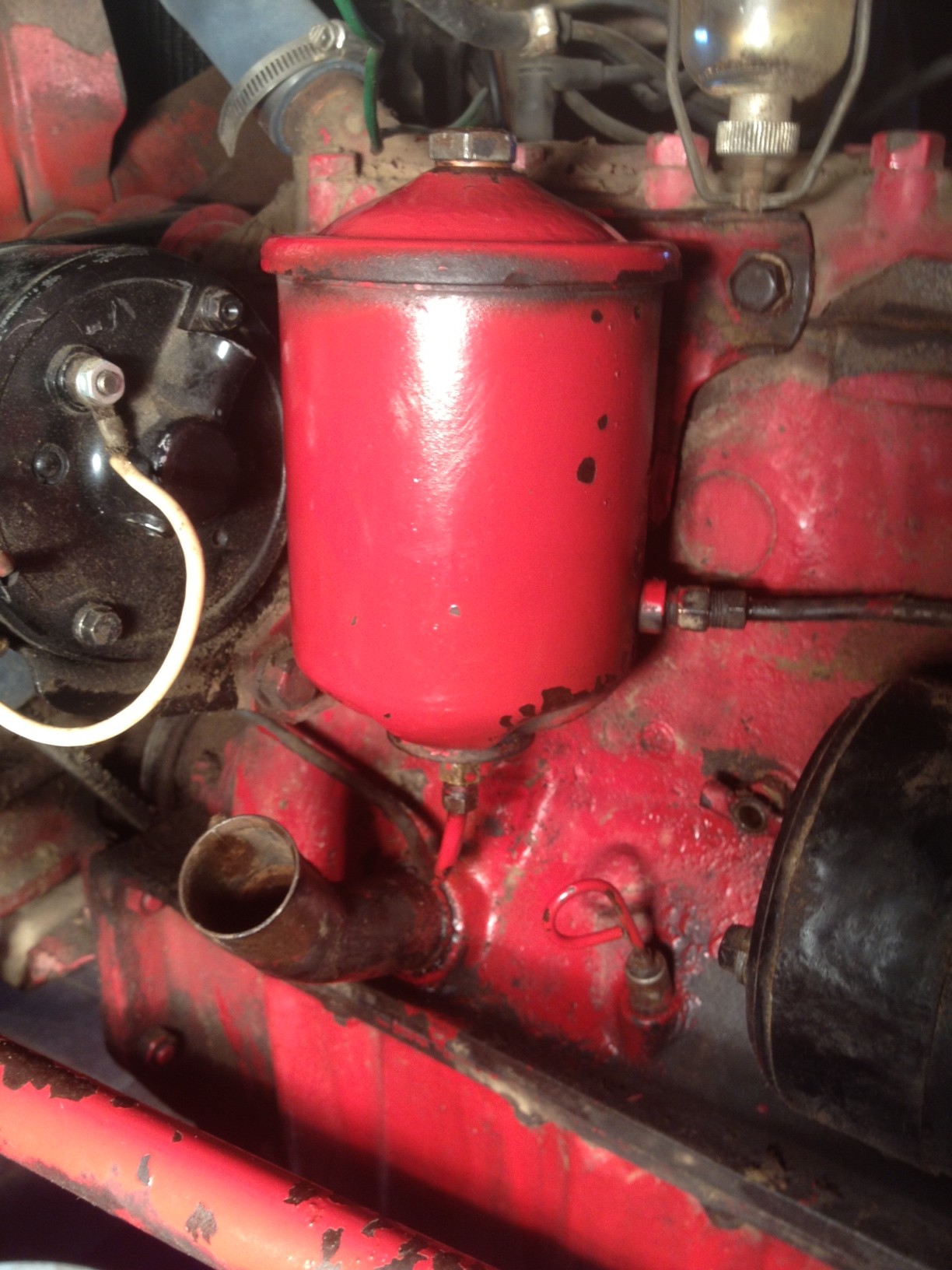

I successfully changed the oil in the 8N today. The biggest challenge was getting the crankcase drain plug off the oil pan. I had nothing except a crescent wrench and a cheater pipe and had to rely on a neighbor and his pipe wrench and cheater pipe. The old oil was foamy and filthy.
Next, I removed the oil filter canister with two "proper wrenches", thanks, SDT:

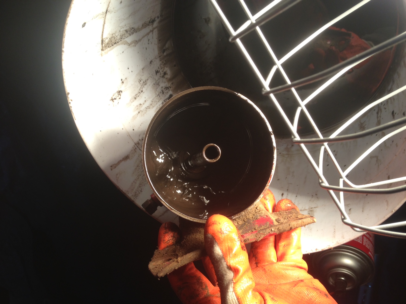

Here is the sludge at the bottom of the canister before cleaning:

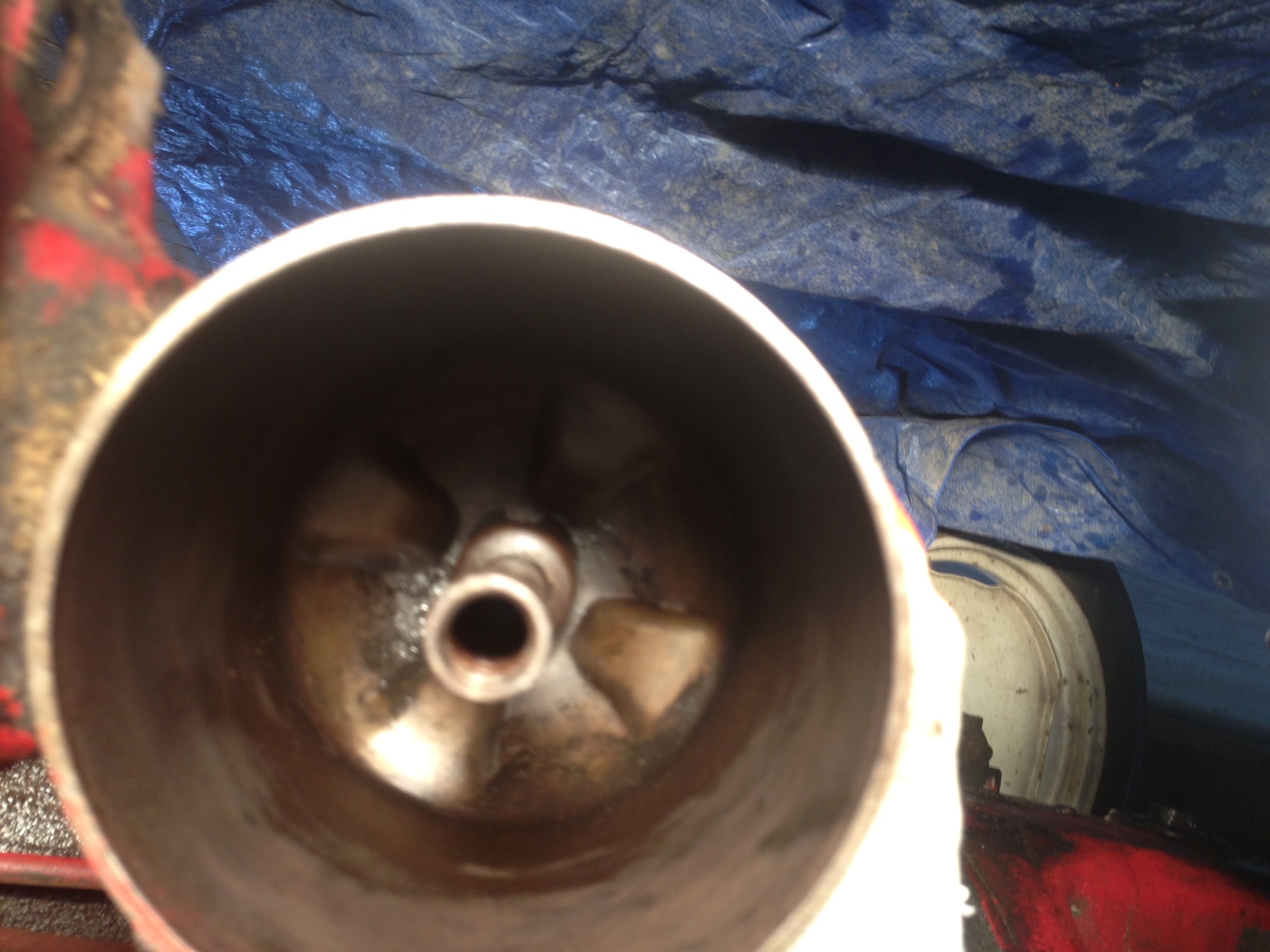

After cleaning:

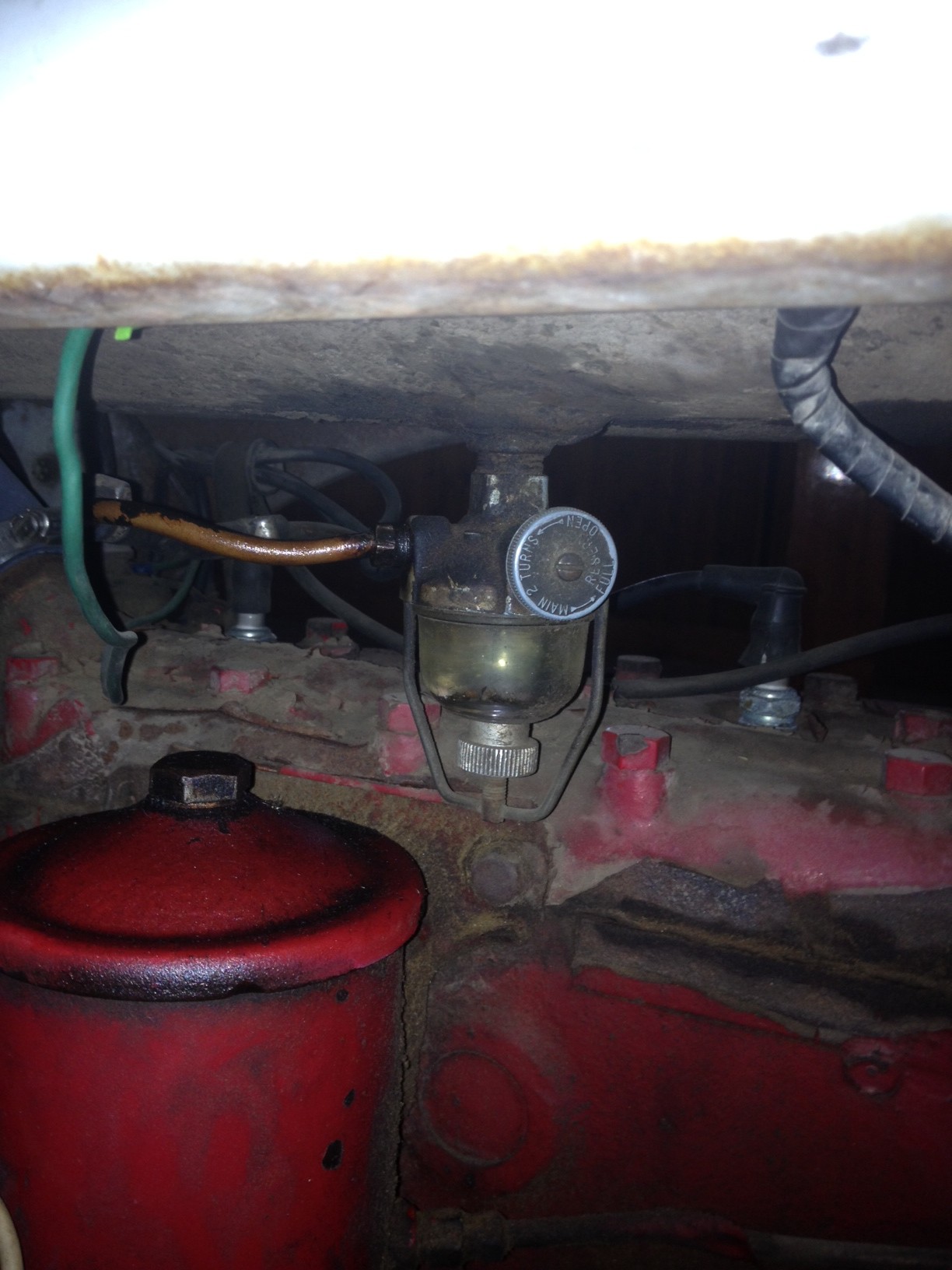

4. Does the sediment bowl in an 8N normally contain a fuel filter? Here is my sediment bowl. looks like it needs some service, too:

there is a filter above the tap in the tank.. size / shape of a finger.. in the top of the bowl is about a 1.5" flat filter even with thop of glass at the oring/gasket level. in the elbow going into the carb is a small rolled screen.
the baffle is there to prevent oil sloshing splashing or blowing out the breather.. blowby.. hard work.. etc.
you can clean the screen in solvent.. or buy a new one at tractor supply.. etc.. or cut up a 1" thick green scrubby pad used for cleaning grills and trap it in there. repop can and screen ain't expensive... unless totally gone.. solvent cleaning helps them usually.
foamy frothy oil usually indicates water and or overfill ( water displaces oil too )

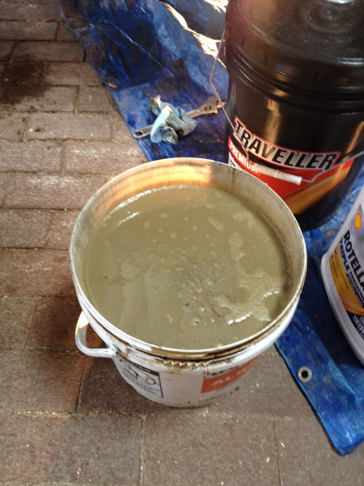

This is an image of the trans and diffy fluid which came out of the tractor. looks like a beige puke. The UTF (134D Ford spec) that I replaced it with was a clear amber. Does old fluid always look this way? I am the new owner so I have no idea about when it was changed in the past.

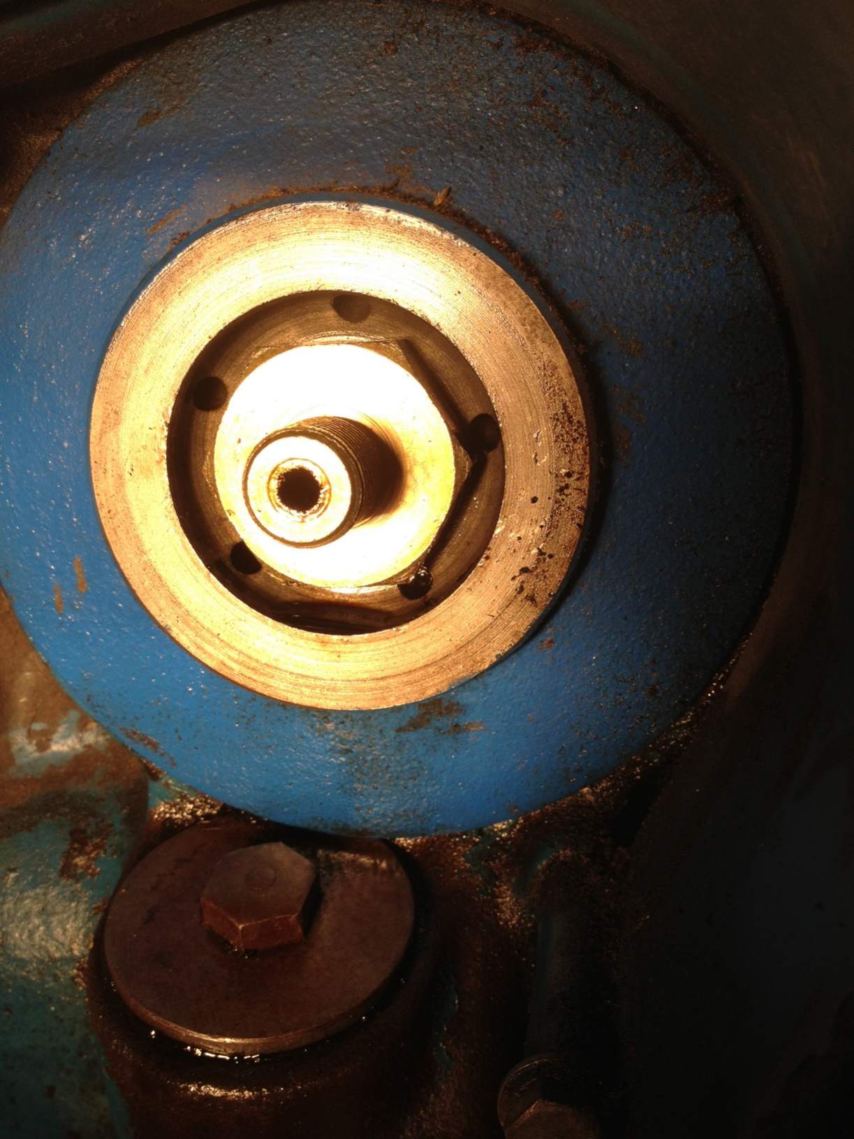

Secondly, I was not able to replace the leaky spin on oil filter adapter because I had nothing big enough to get around the large nut holding it in place which is recessed at the same level as the raised phlange that the oil filter sits on. My 1 1/8 inch socket is my largest and wouldn't get close to fitting over it. The raised nipple the filter screws onto makes it impossible to measure accurately with a tape and, finally, I lack a caliper to measure it. Anyone know the size of this nut?

te emulsion is from water.. I'd reccomend flushing the sump looking at the stuff that came out.
as for the oil filter adapter... my screen is way to small to see any detail on the pic.. but them stem adapters are rarely torqued down super duper tight. I imagine you could spin it off with a chissle applied to a flat near a corenr of the nut quite easilly..
