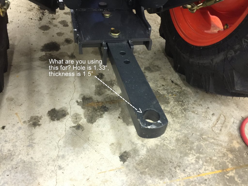

Hello All: Can you please educate me on the uses of a tow bar of this size? How are you using it? I'm getting ready to order from Ken's Bolt-on, so thought I'd ask in case I should add something based on your comments.
I can only see a 1 1/4" shank tow ball or a very large shackle (my 3/4" won't fit, looks like 1" minimum). It seems way too large for a tractor of this size, but then again, maybe I'm missing something as usual.
Thanks, Toukow

Use a draw pin to hook it to wagons, implements, etc...that have a tongue that also accepts the draw pin (I believe the tongue would have what they call a clevis hitch type tongue)
Red Handle Hitch Pin 1" x 7-1/2" | Agri Supply 16338
With traditional ag equipment, ball hitches aren’t used. (There was a time when Allis Chalmers had a ball hitch and locking ring system, but I digress).
At tractor speeds, using a draw pin with a clevis type hitch, one doesn’t care about the slop when the pin isn’t exactly the same size as the hole on the drawbar.

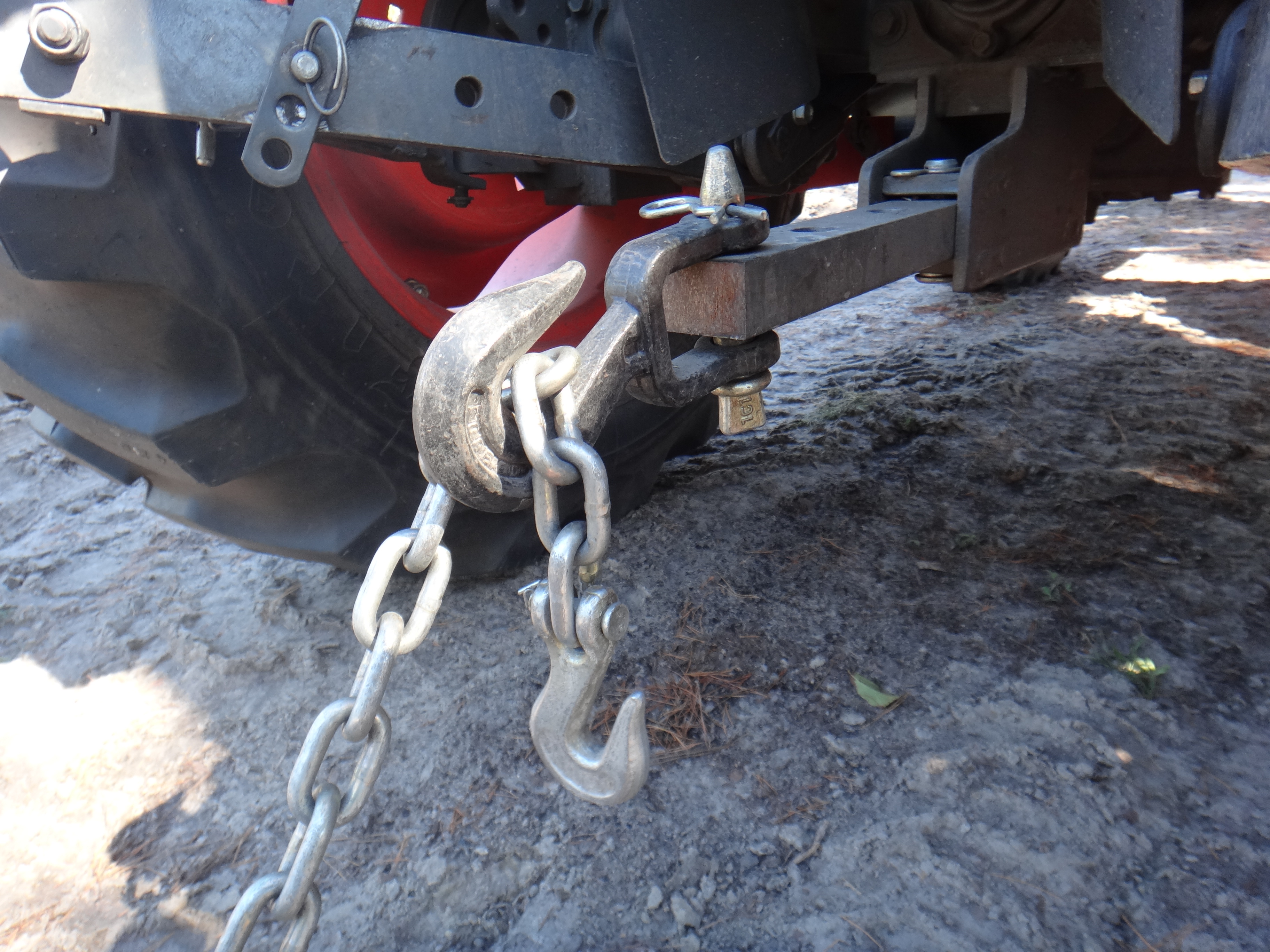

The tractor nomenclature for part in picture is rear/center DRAWBAR.
Tractors are designed to PULL. Drawbars need to be heavy.
MORE: https://www.tractorbynet.com/forums/owning-operating/404017-tractor-three-point-hitch-cross-2.html
Cusor down to Post #14.
To easily attach/remove a tow chain you need a pin clevis grab hook, not a bolt on grab hook. You may need a shim/coupler to make clevis pin fatter.
Tractor Supply Company sells clevis hooks. I presume TSC is in Seattle too. TSC sells shims too.
DELETE THE FORD IN YOUR T-B-N PROFILE. SUBSTITURE KIOTI.

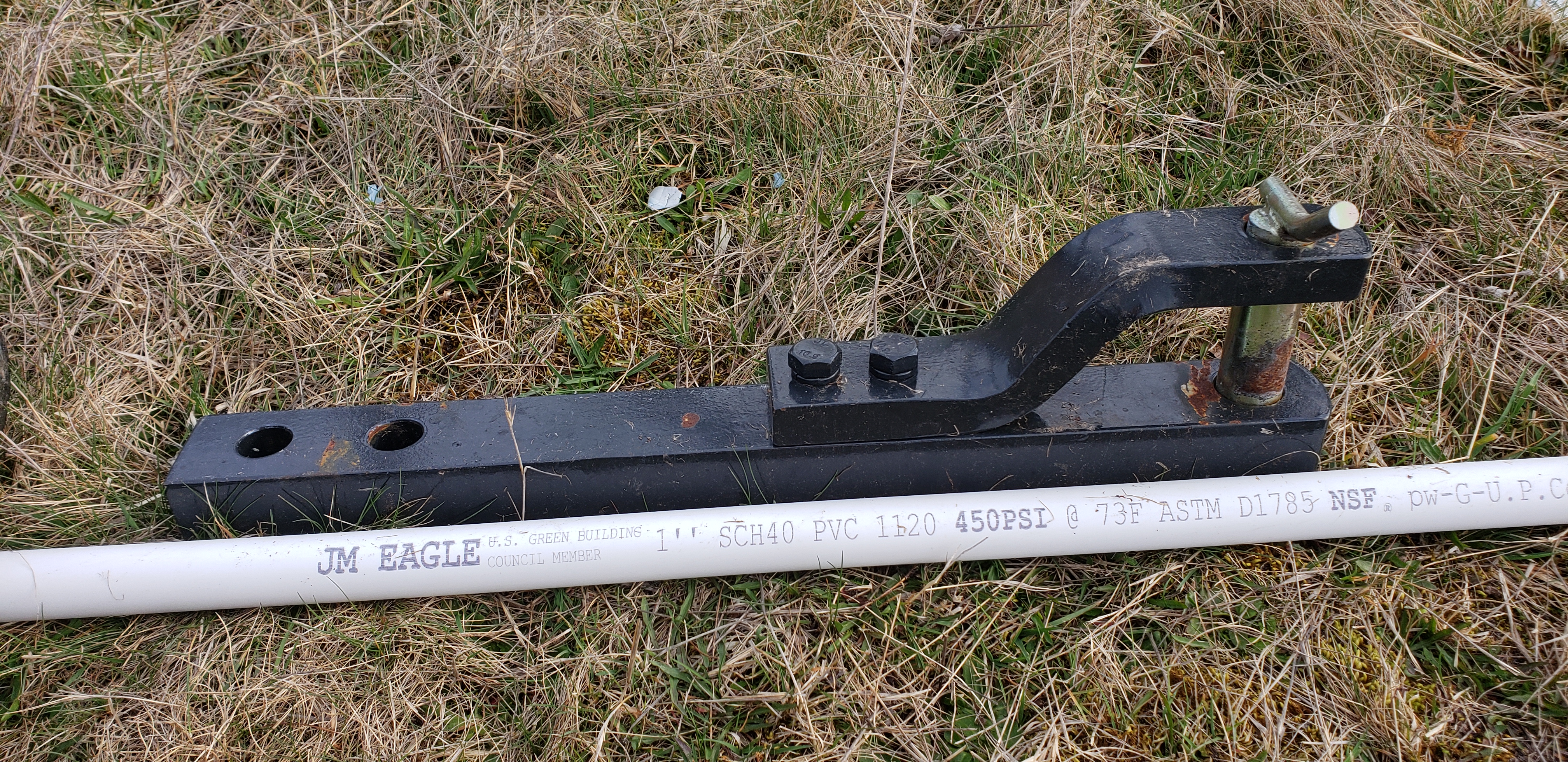

The thickness in part is due to leverage and the length of extension from mounting point under tractor and keeping high tongue weight loads without bending. They are commonly use to RIP stumps out and pull other heavy duty loads. The tractor may have low hp, but good low gearing and torque. Weight and heavy duty are a tractors friend. No need to make that part lighter.

A short piece of 1" galv pipe nipple cut to the thickness of that draw bar will just fit in that hole so a 1" pin will fit and have very little slop. That's what I did and it works. Bob
That looks useful! Is there a particular term for the piece bolted on top, or does it usually come as a complete assembly? I have some 1.25" Dyneema rope with eye which would work with that setup. Thanks!
