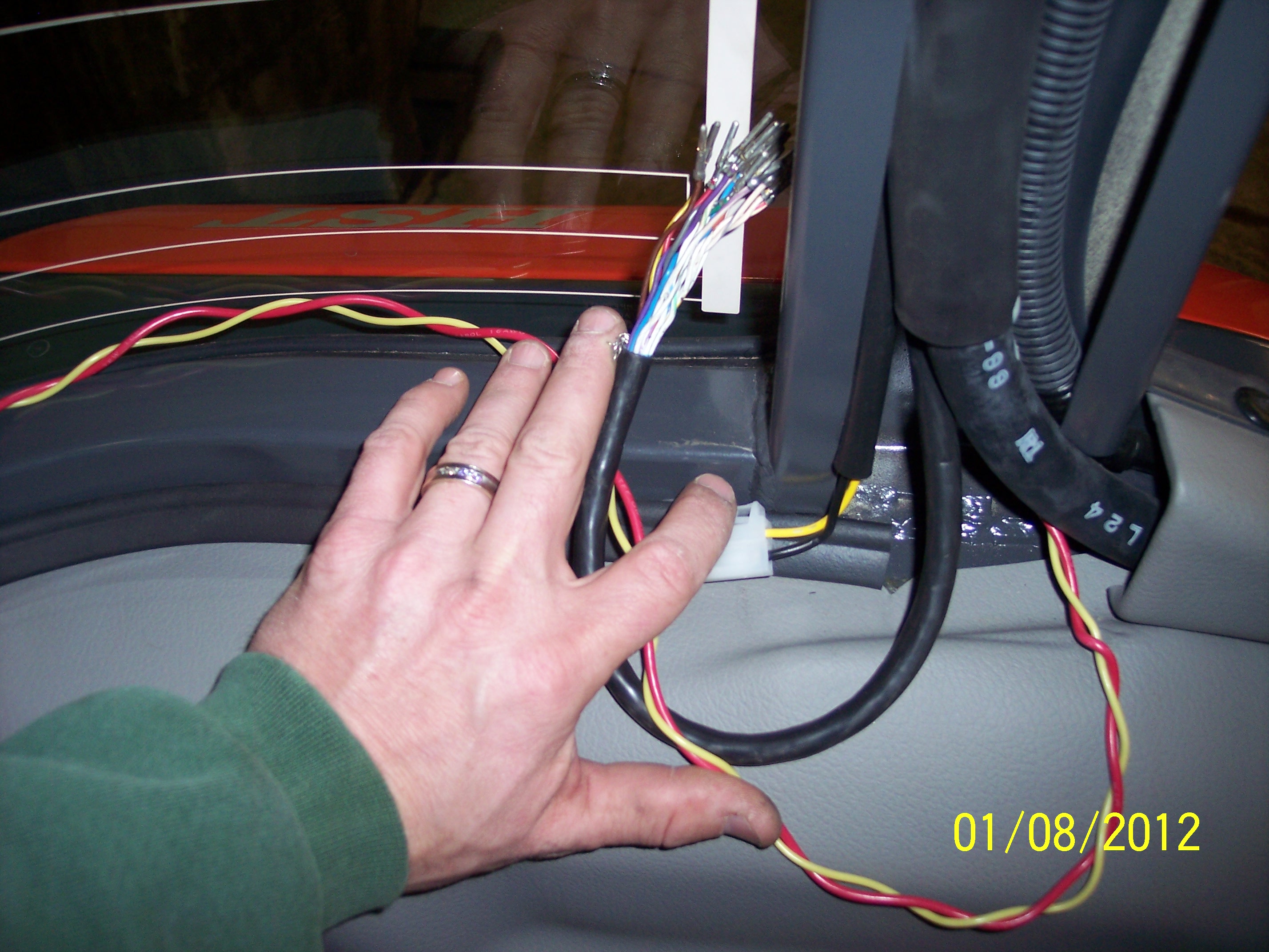

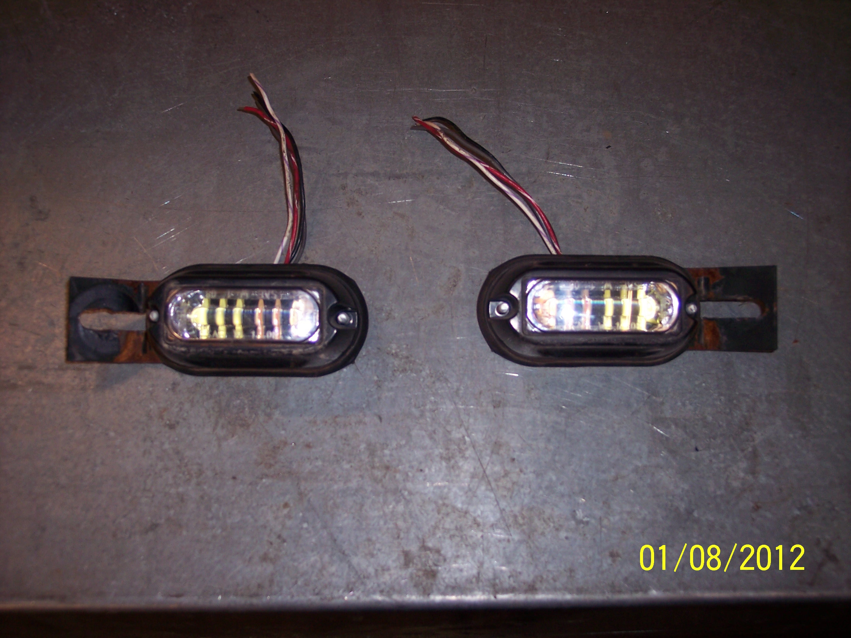

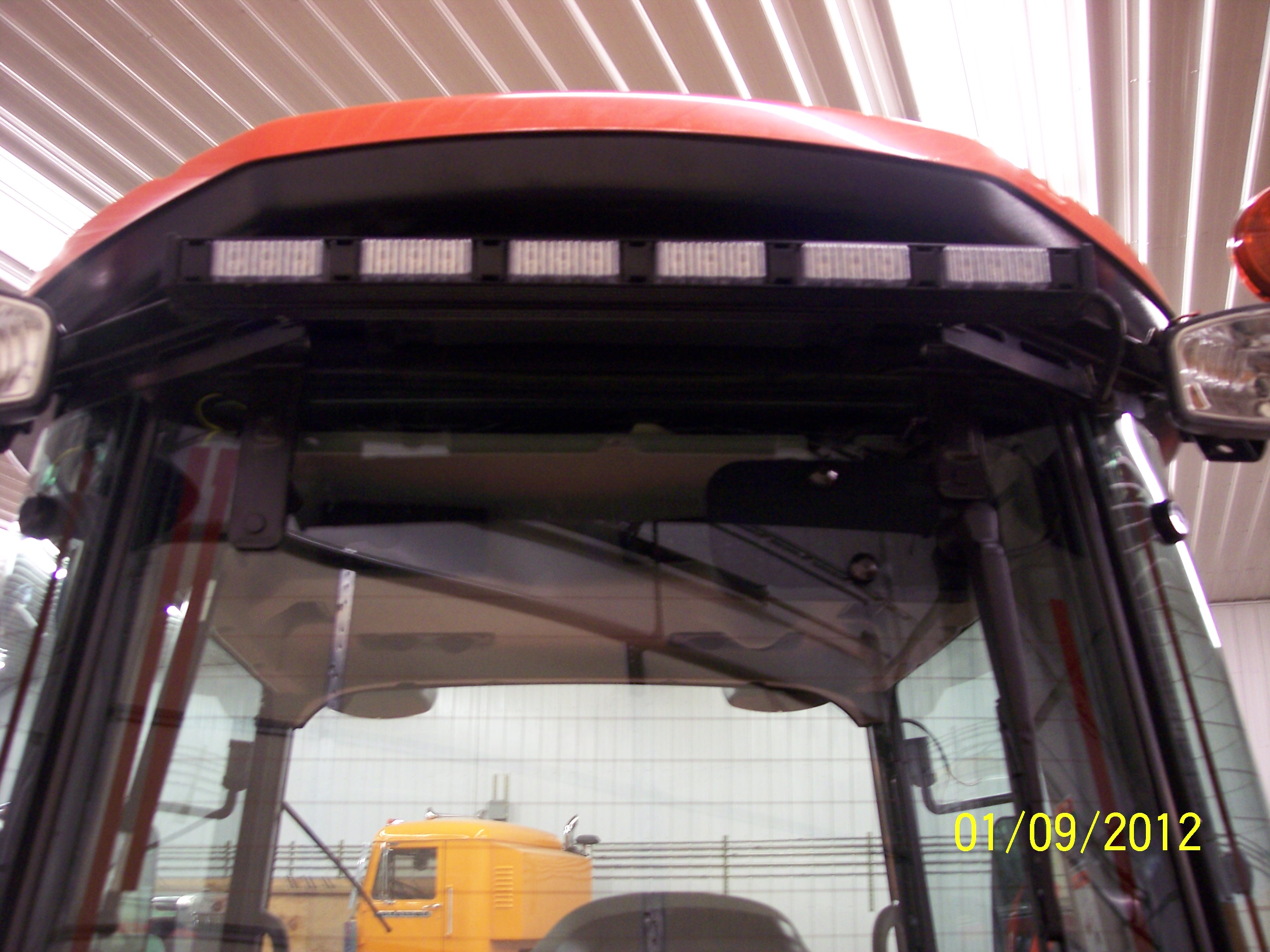

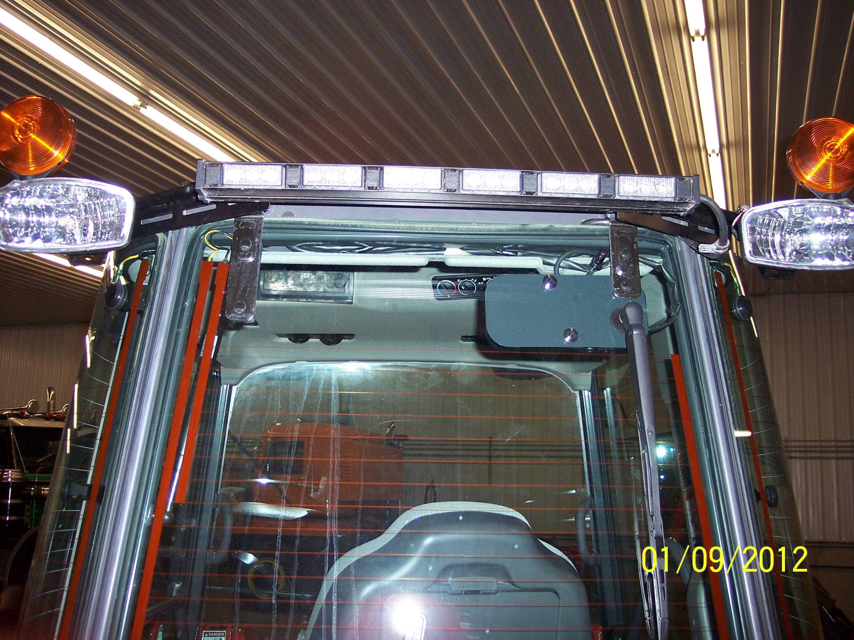

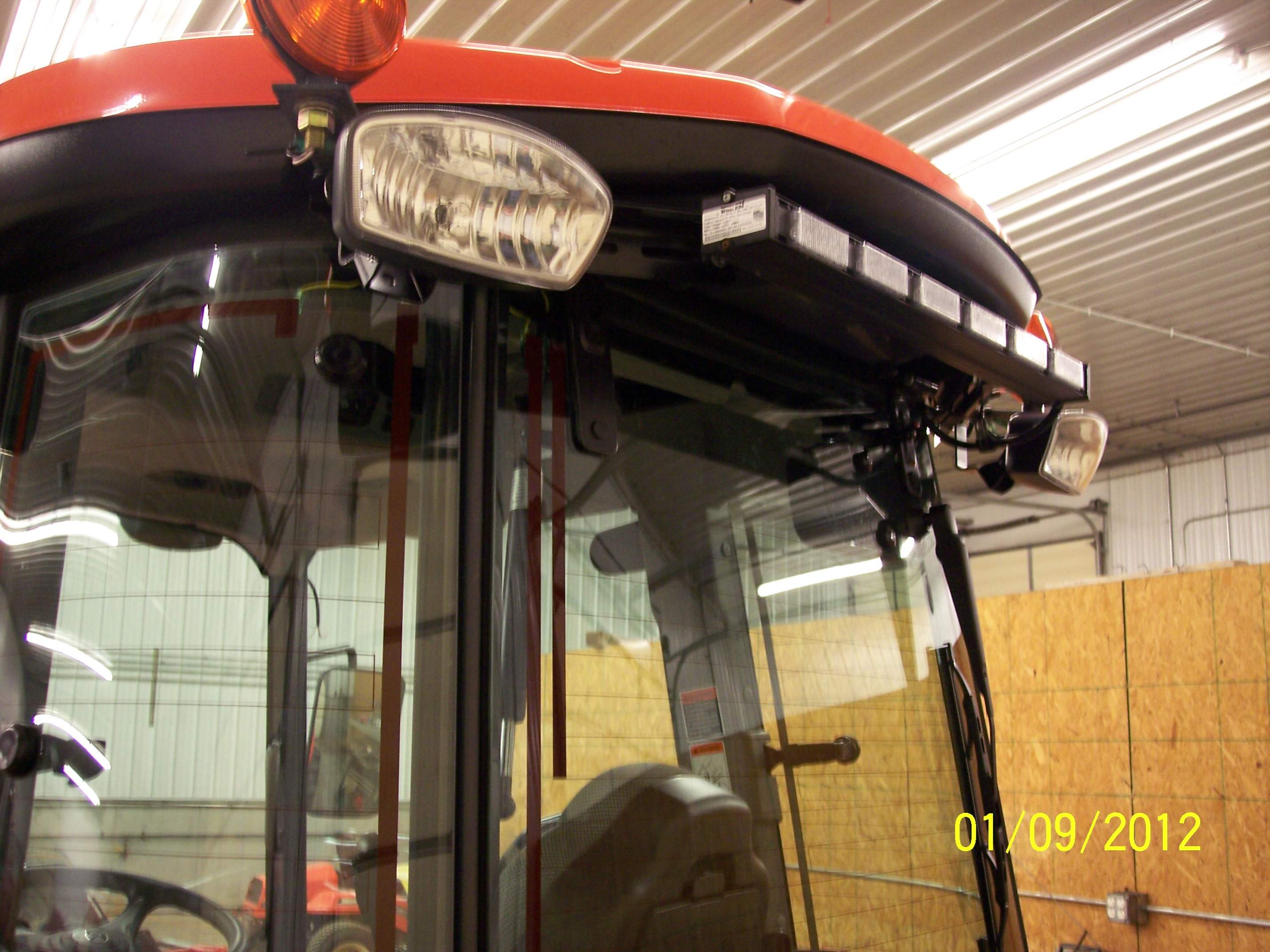

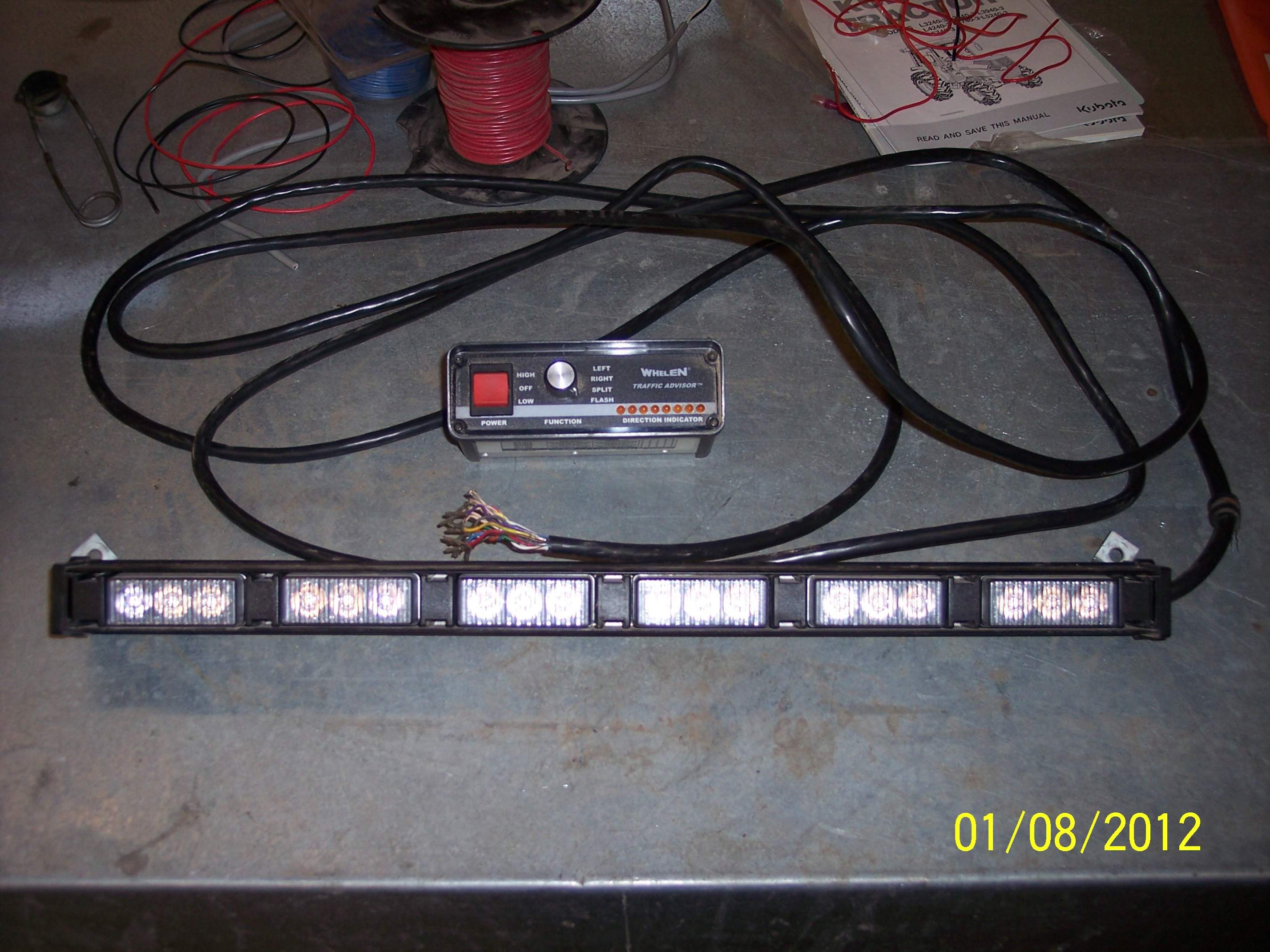

I transferred my Whelen Lindz6's and traffic adviser from the B3030 to the L5740.

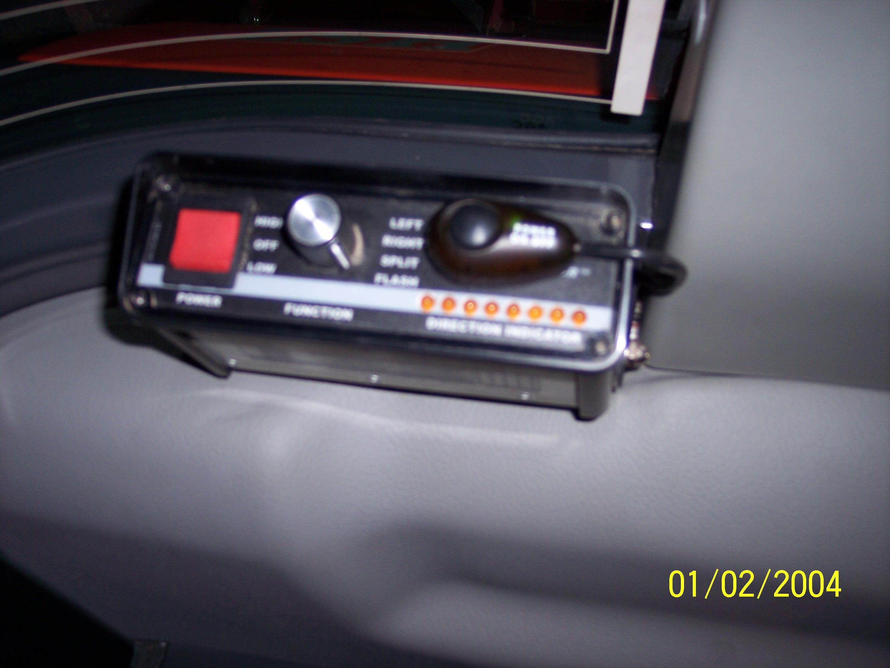

The controls.

   / New/Old strobe lights #3
Got a dimmer switch so you don't blind drivers?

   / New/Old strobe lights #5
That controller has a high or low switch. I have the same controller for my lightbar in my F-250.

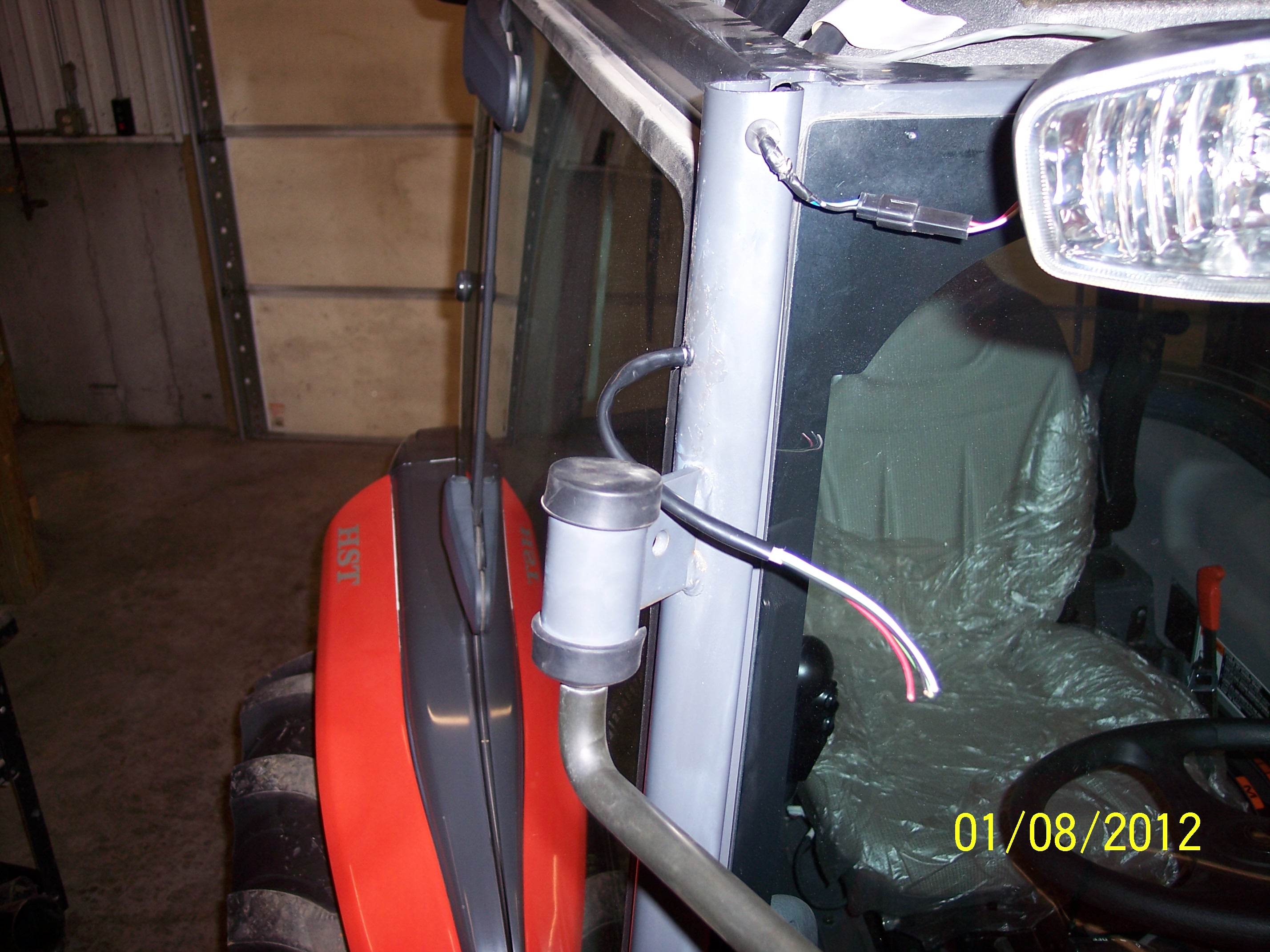

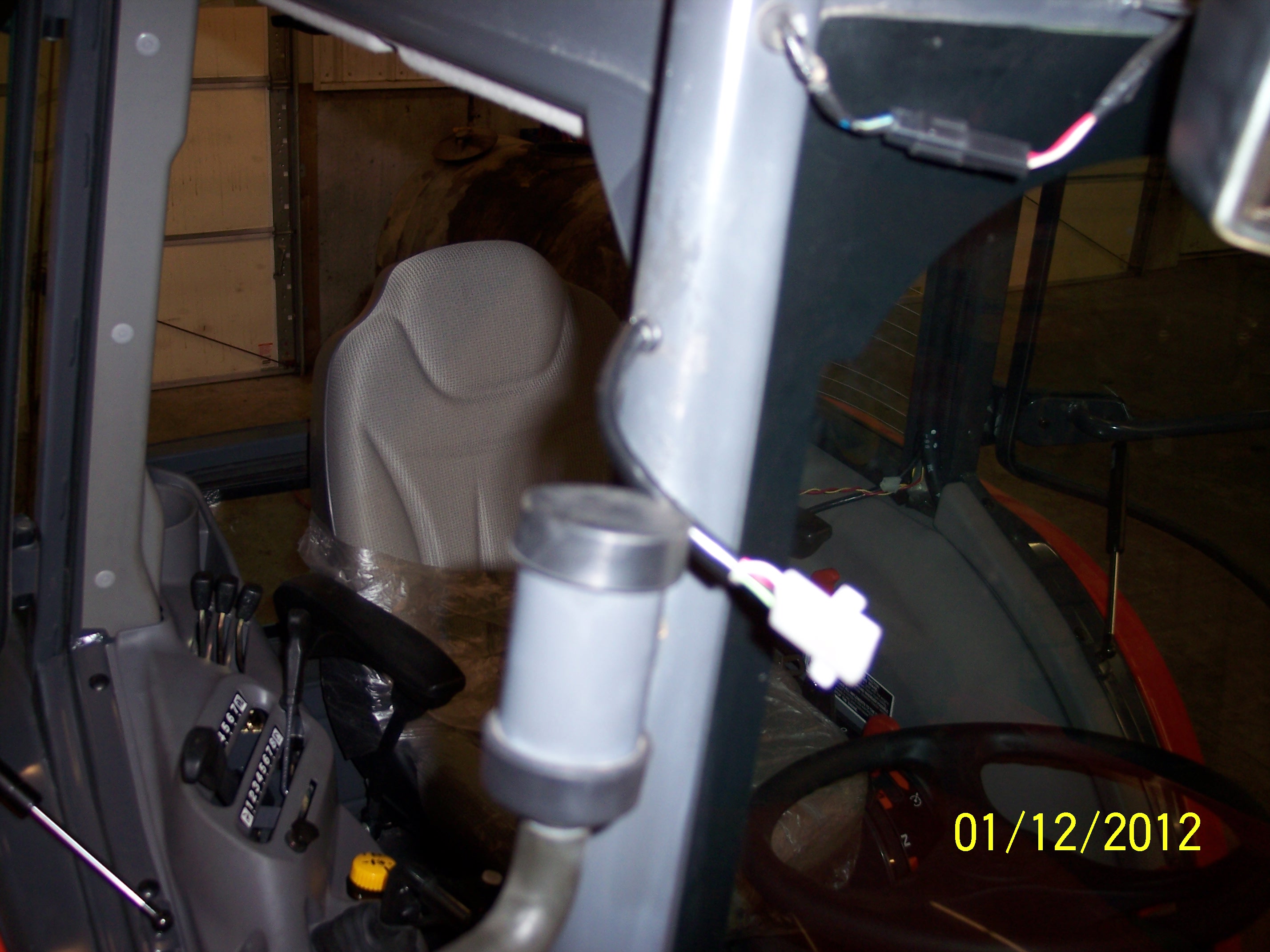

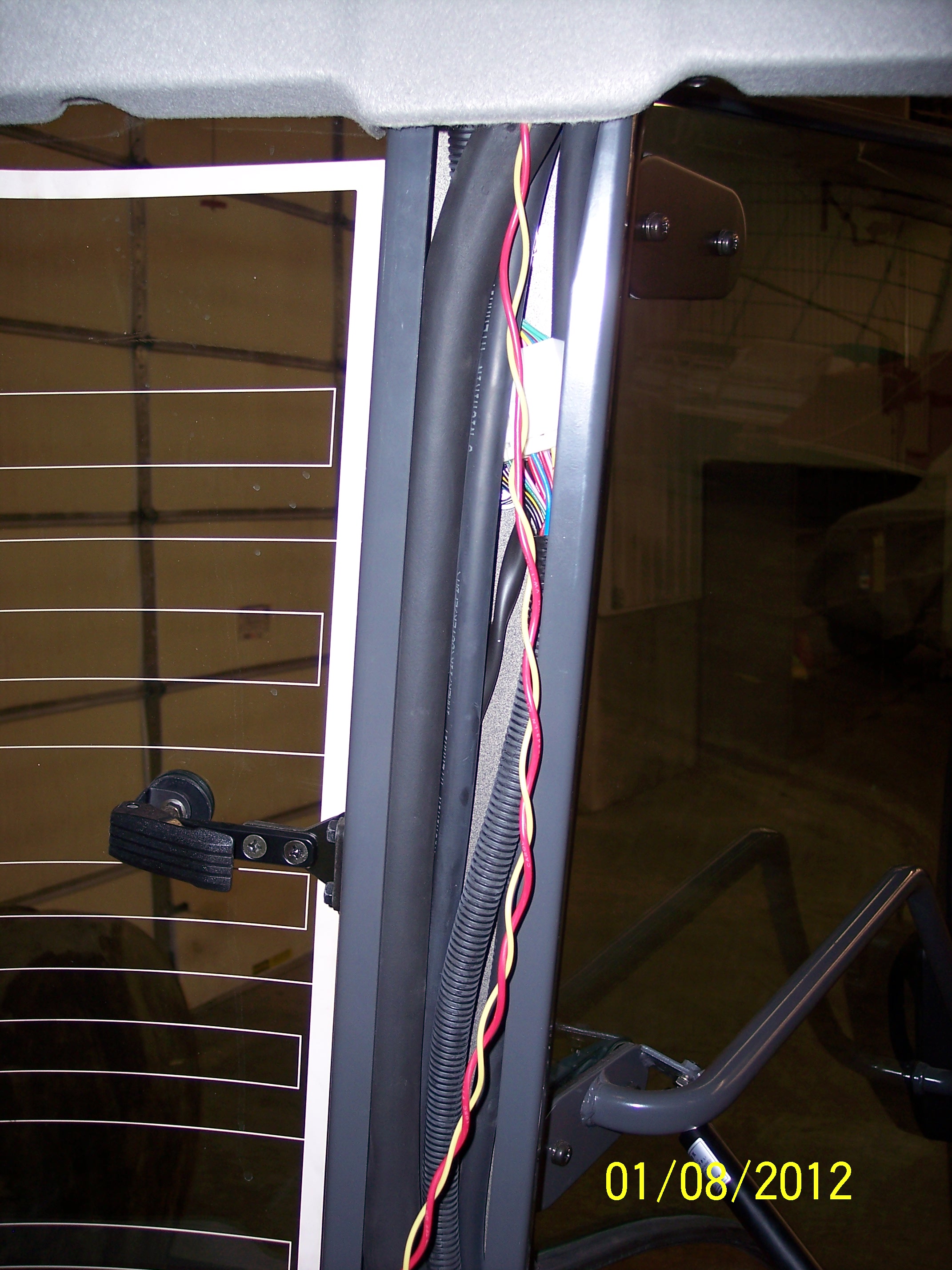

Why didn't you put the molex connectors inside the cab, to protect them from the weather?
EDIT: Nevermind, looks like the wires from the LINZ6's were too short for that.

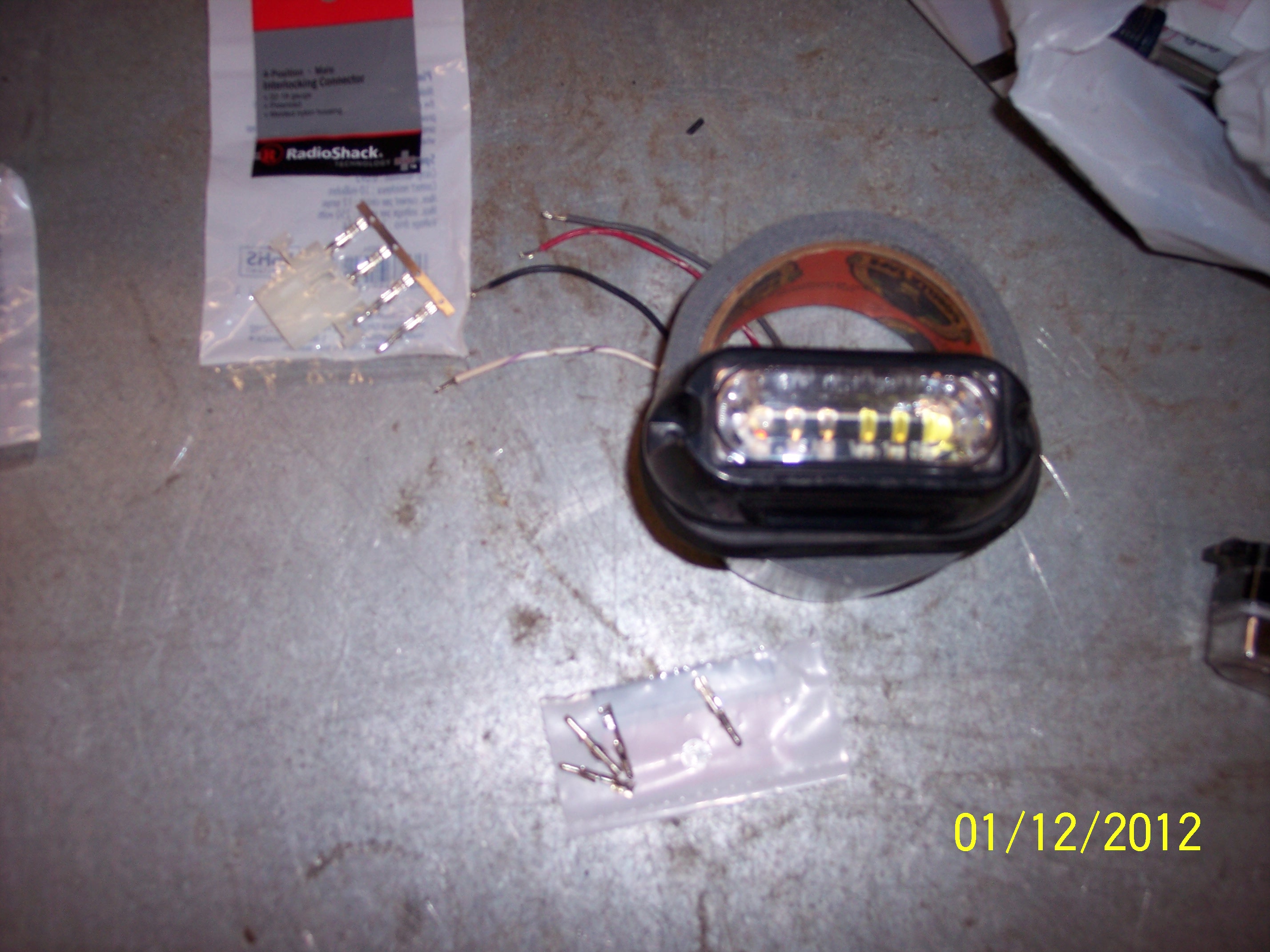

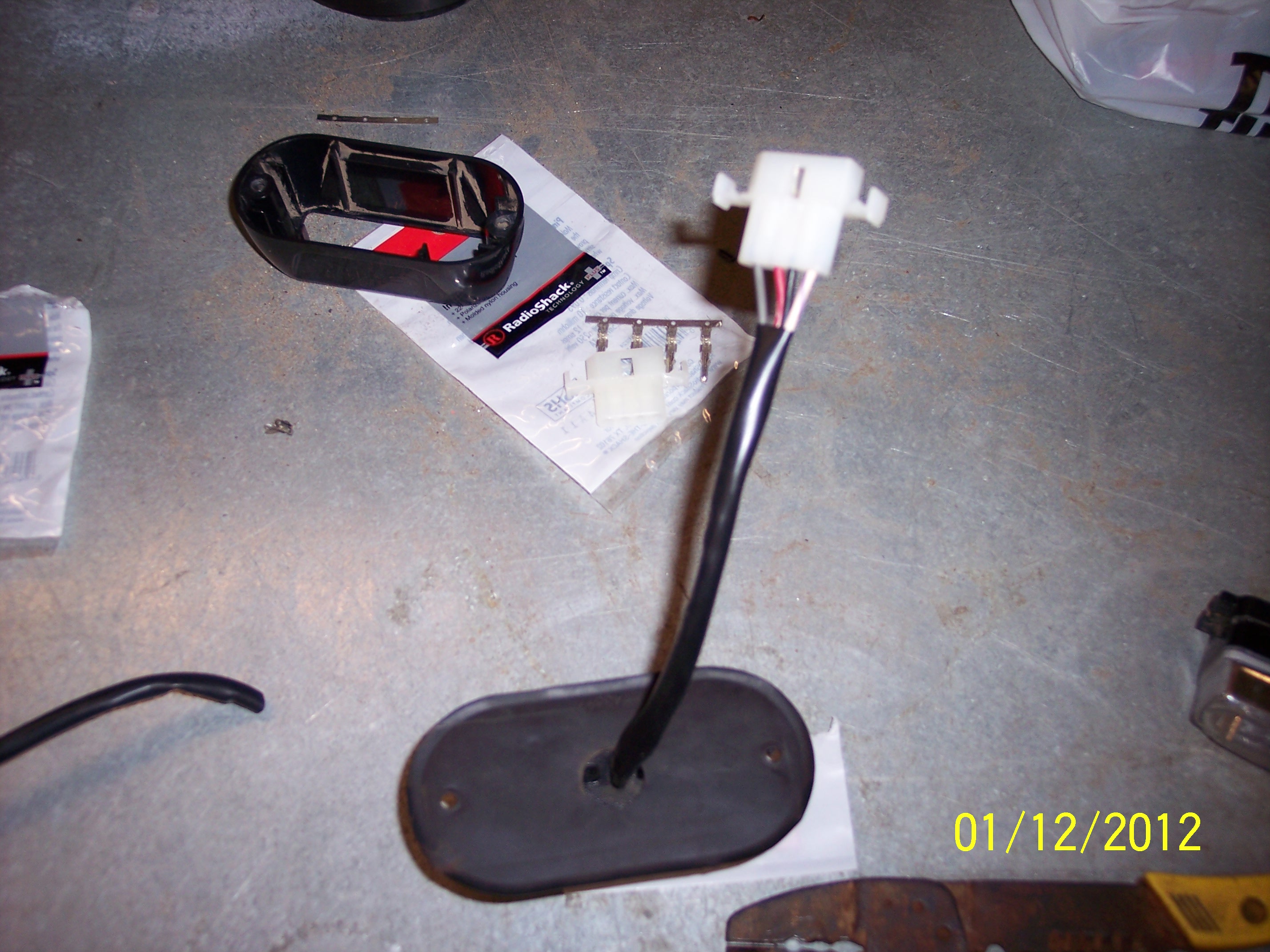

I did on the B3030 and it was a real pain to remove them. I might as well just used butt connectors. Also the connectors won't go through the little hole and grommet. So I did it this way this time. I'll just have to see if I have any issues. If so, I'll just have to order some Weatherpack connectors.
