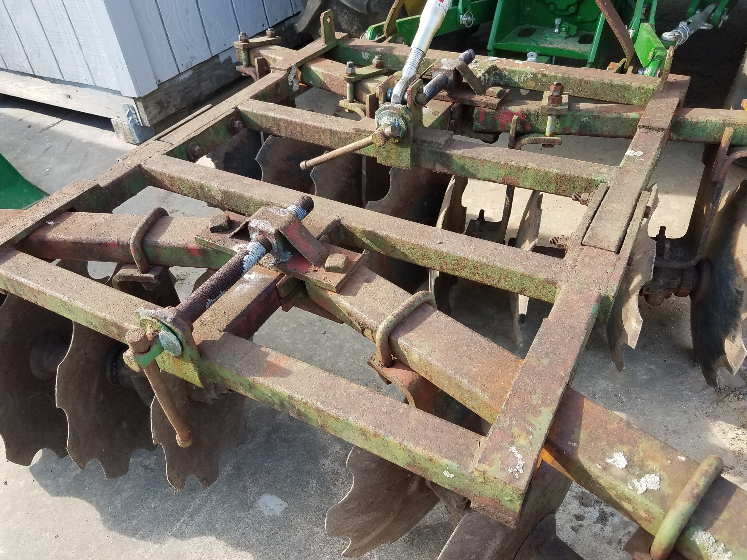

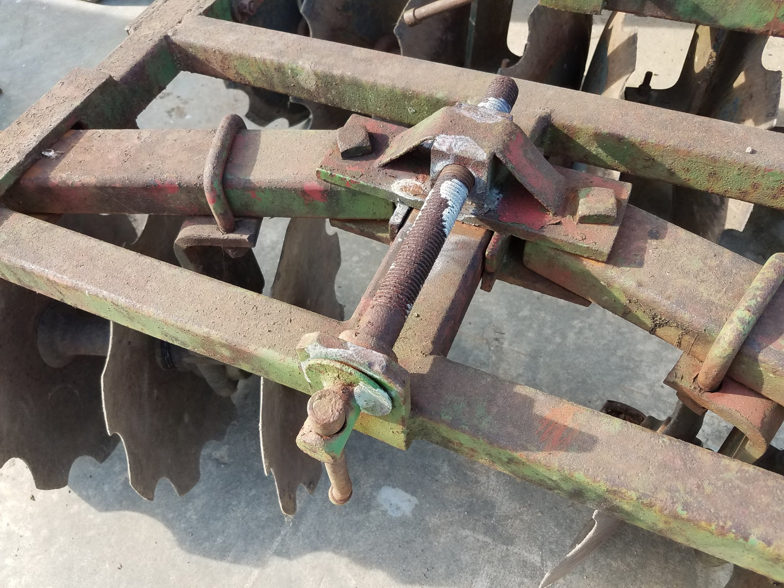

I just got gifted the attached disc, it is good condition but needs a bearing and a couple of parts, can anyone tell me the maker and or model so I can get the right parts? there is no data plate on it any where and it appears to have several coats of paint, (red-green-blue). thanks much

Agri Supply inventories a huge number of generic Disc Harrow replacement parts. If you measure carefully Agri Supply can likely meet your needs.

lift pins are not cast, everything works perfectly but want to be able to repair if needed, not going to work big fields just home garden and deer food plots. retired from the USMC and going to move into the woods away from the political craziness.
thanks for the help!

I would like to see a better picture of the front of the disc, also like someone else said Agri Supply is about a sure bet for parts, once you determine round or square axle and what size 1" or 1&1/8"etc you will be able to get parts, also a lot of times NAPA or a local bearings and drive store will be able to cross reference bearing numbers.

Have one like that. Haven’t used it in years but it works well. Well greased they last a long time. Pans, spools and bearings were readily available at the local coop. Agri supply a source too.

DITTO on Agri Supply!
They have hundreds+ of disc replacement parts, and are absolutely GREAT folks to buy all sorts of things from!
