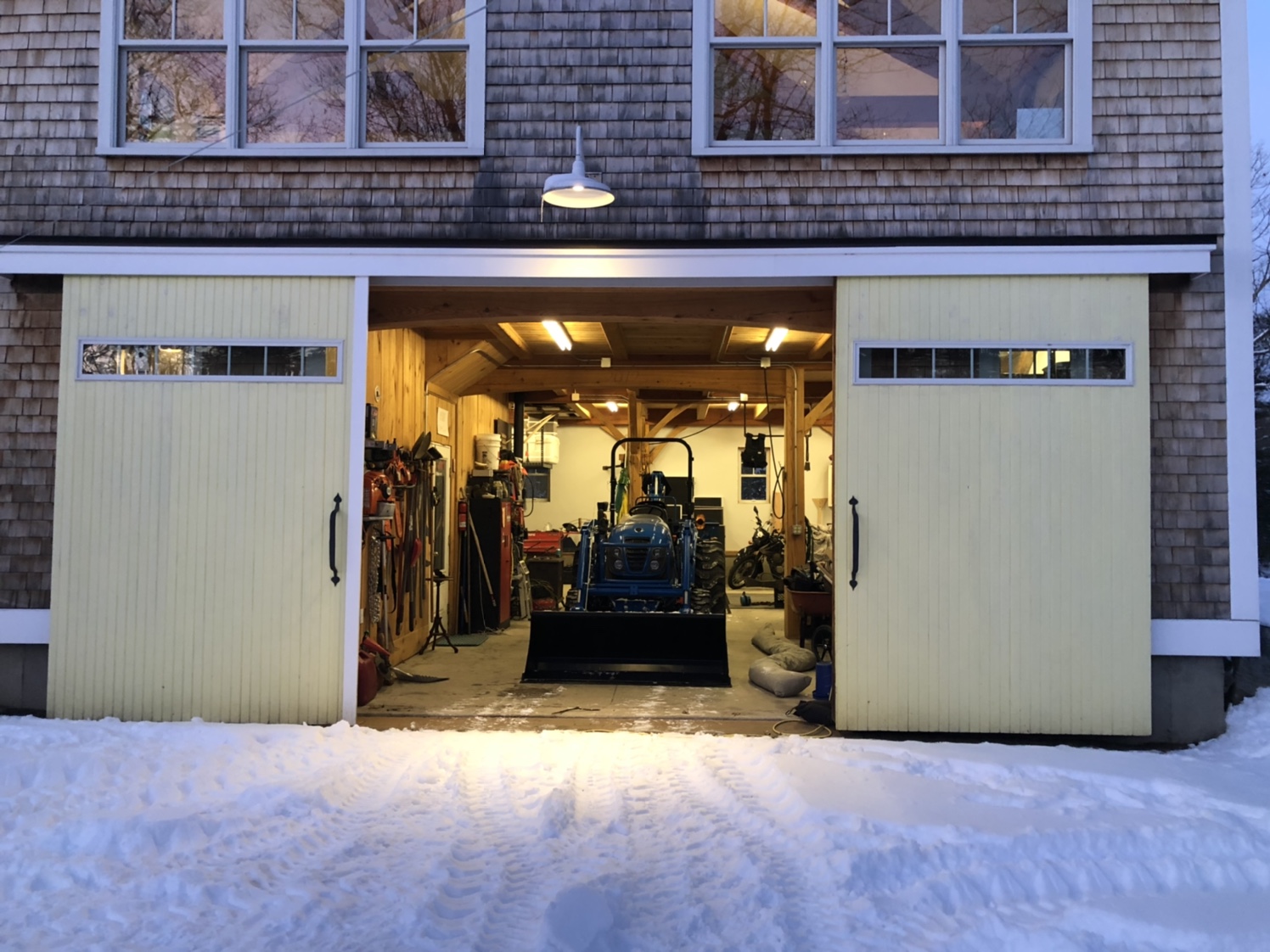

Put to bed for the day. Got a few hours in today on her. A bunch of projects lined up for the weekend.
Still have room in the shop, but not much!
/ New MT240HE #12
That looks really good! I see what you are saying about the handle. You made up my mind... well worth the $$. Looks solidly built.
Fits in there really nice!
