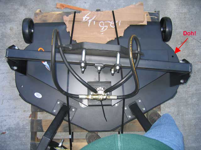

While unloading my new 48" finish mower deck yesterday I noticed something funny: the U shaped arm that connects the quick attach plate to the deck is installed on an angle. I think it's assembled incorrectly. Looks like someone bolted one of the brackets into the wrong holes on the deck. I assume it's supposed to be straight.
Here's a pic looking straight down at the assembly. Note the arrow where I think the bracket (on the right) should be bolted to.

For safety's sake, I'd use the front holes if possible -- and if it doesn't cause clearance problems with the tractor.
This would place the center of balance such that the back of the mower should always drop down when you lift it up with the lift. You certainly wouldn't want the blades spinning with the back of the mower higher than the front....
My old 60" deck doesn't appear to have an extra set of holes...

I think you're right. Any of the other pictures I've seen of these decks so far have the right angle brackets lined up with the spindle cover. I don't recall having seen any other pictures with three holes on each side. But what an oversight! Does anyone look at this stuff before it goes out???

My 60" is mounted towards the front or in the front mounting holes. You would think someone at PT would have caught that one? Hope this helps.

Pretty sad that nobody at PT noticed such a glaring and obvious assembly error!! I hope you take the recommendation to send the photo to them.
At least it won't be difficult to fix. Did it seem to put undue stress on the crossbar tabs, such that they would now be bent or out of alignment once you reassemble correctly?
I've got those same three holes on each side of my brush hog, with the rear pair unused. I've also got the oval metal labels on the PT and all attachments.

Front holes are for the 425 and the rear holes are for the 2425.
