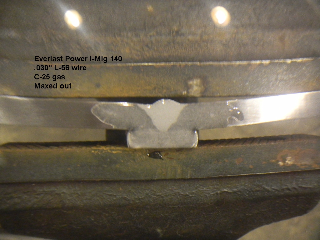

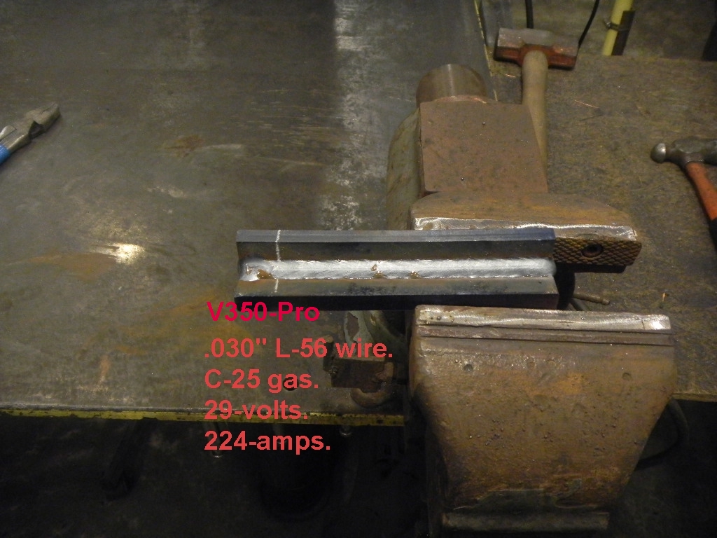

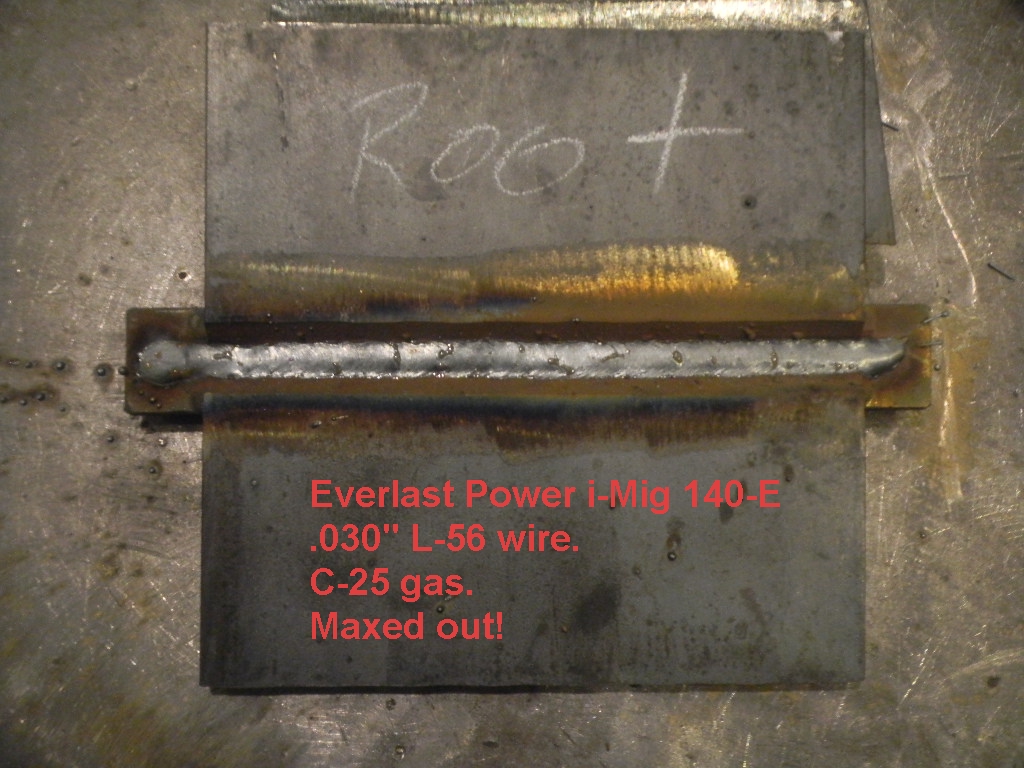

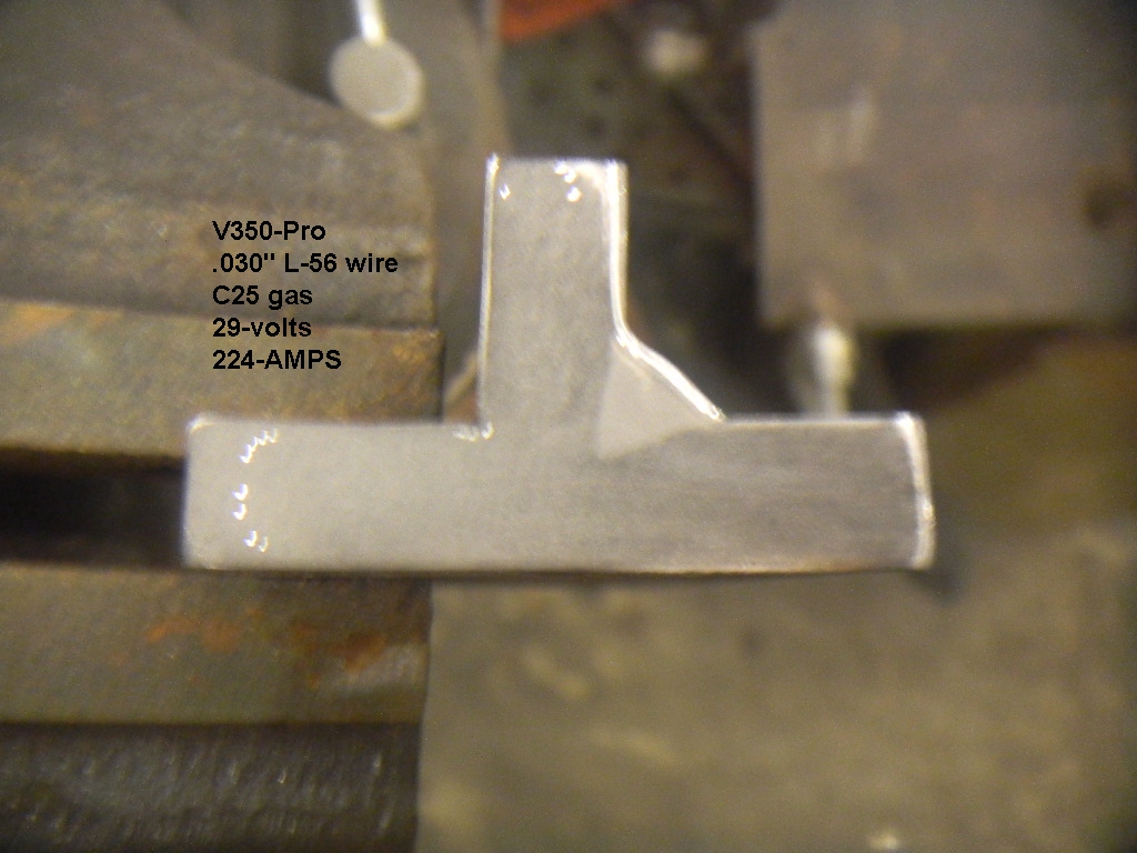

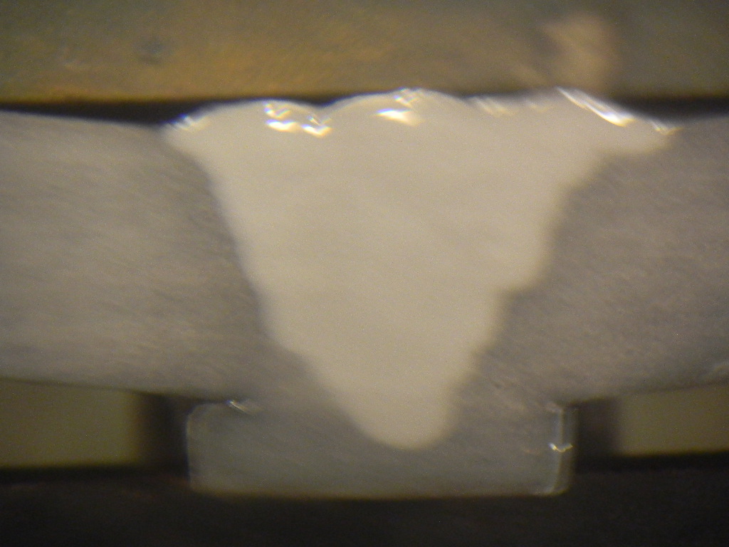

When it comes to Mig / wire welders, there is no substitute for power!:thumbsup:
