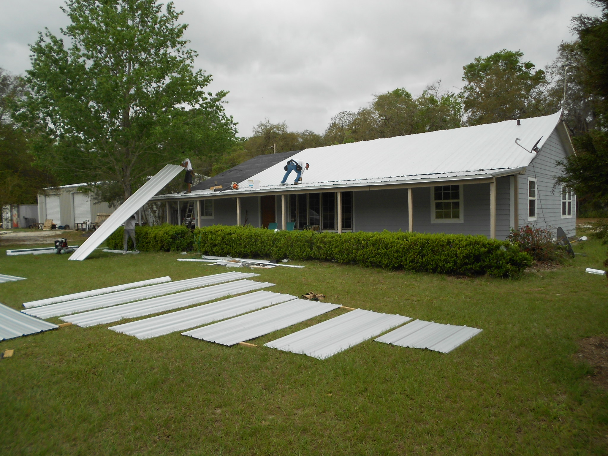

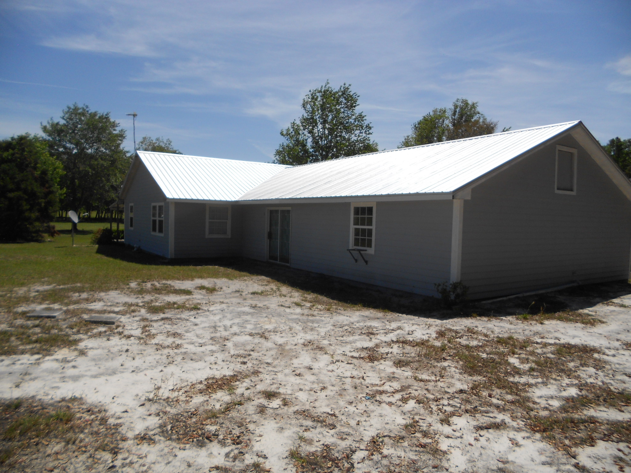

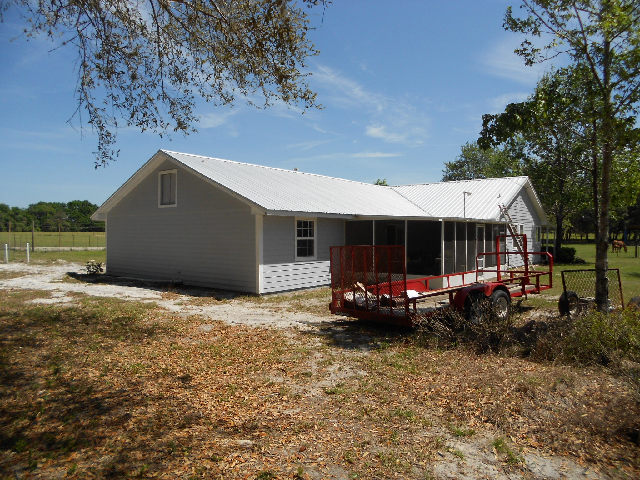

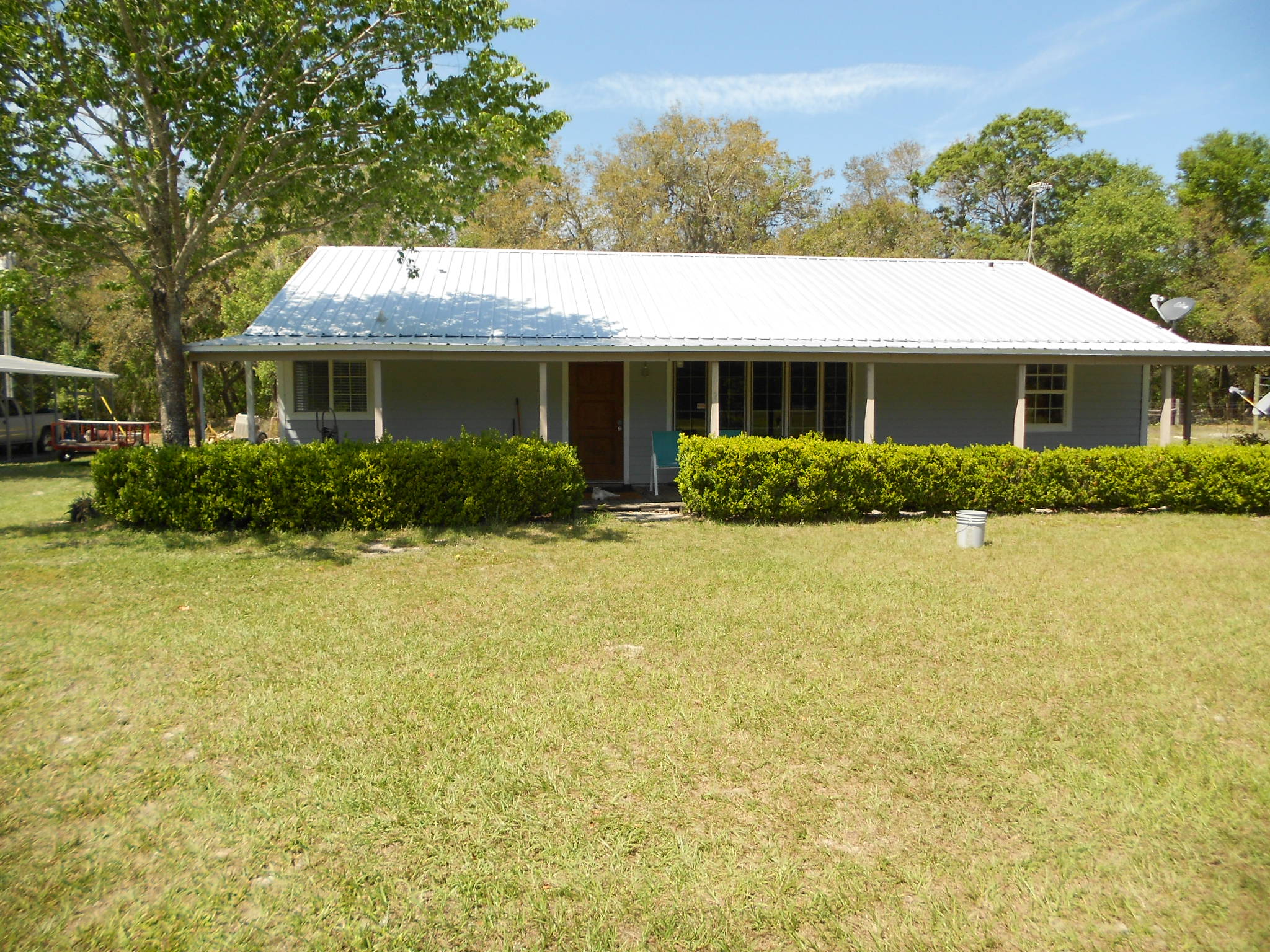

They finished my new roof Monday and it looks great!
Here it is legal to put metal over old roof/shingles if roof is solid. (gets inspected before starting and after finished)
They put it on over Rhino Roof synthetic underlay.
They cut a vent in both ridges and my house is cooler already!
My roofer makes his own panels (Roll former) and had to get state approval/Certs. on his machine.
He fastens roof in the ribs and has engineers approval to do this. Said it helps prevent leaks.
Came out to $260.00 a square.

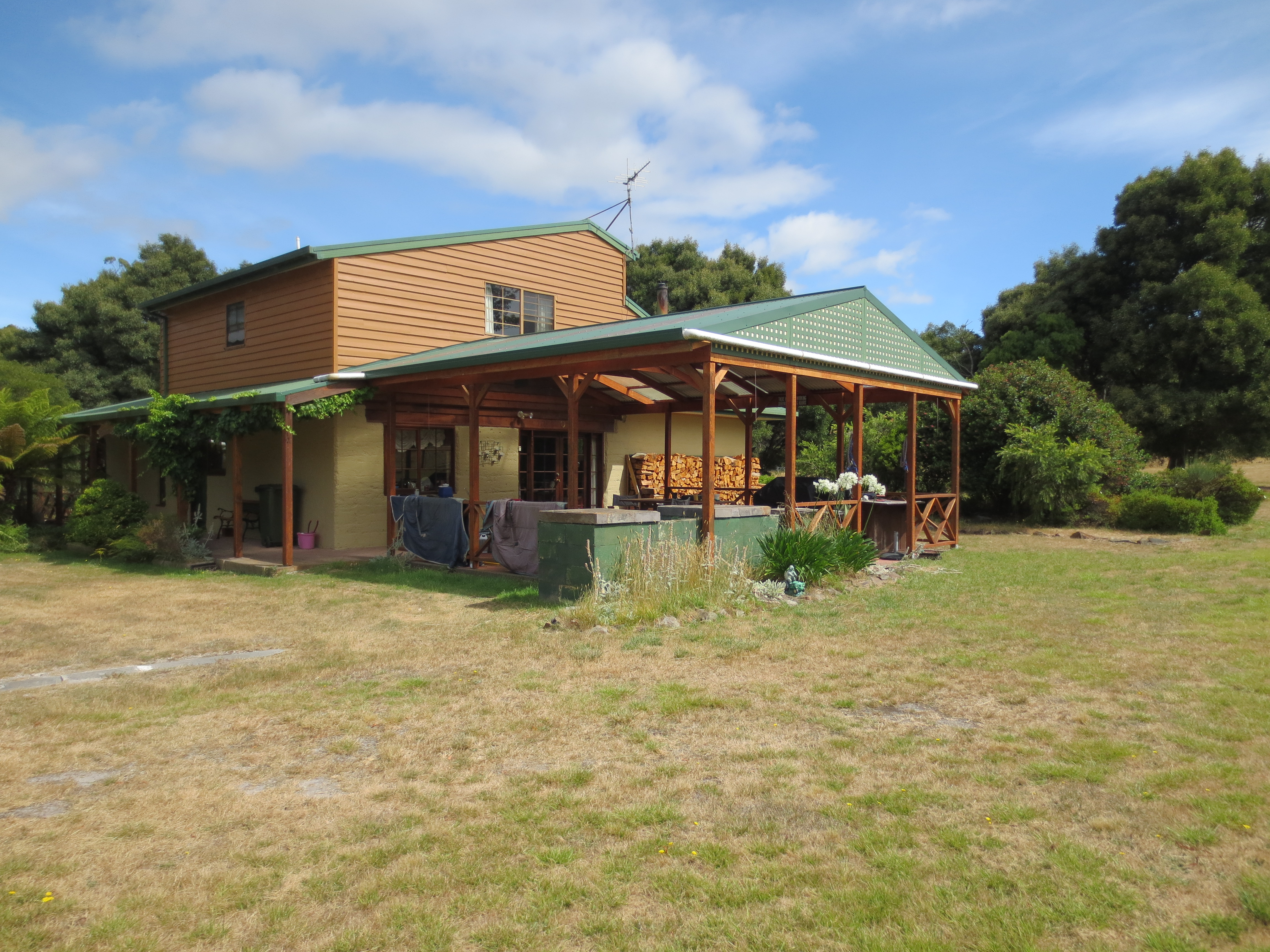

... I wonder if those things attract Hurricanes or tornadoes? :eek:

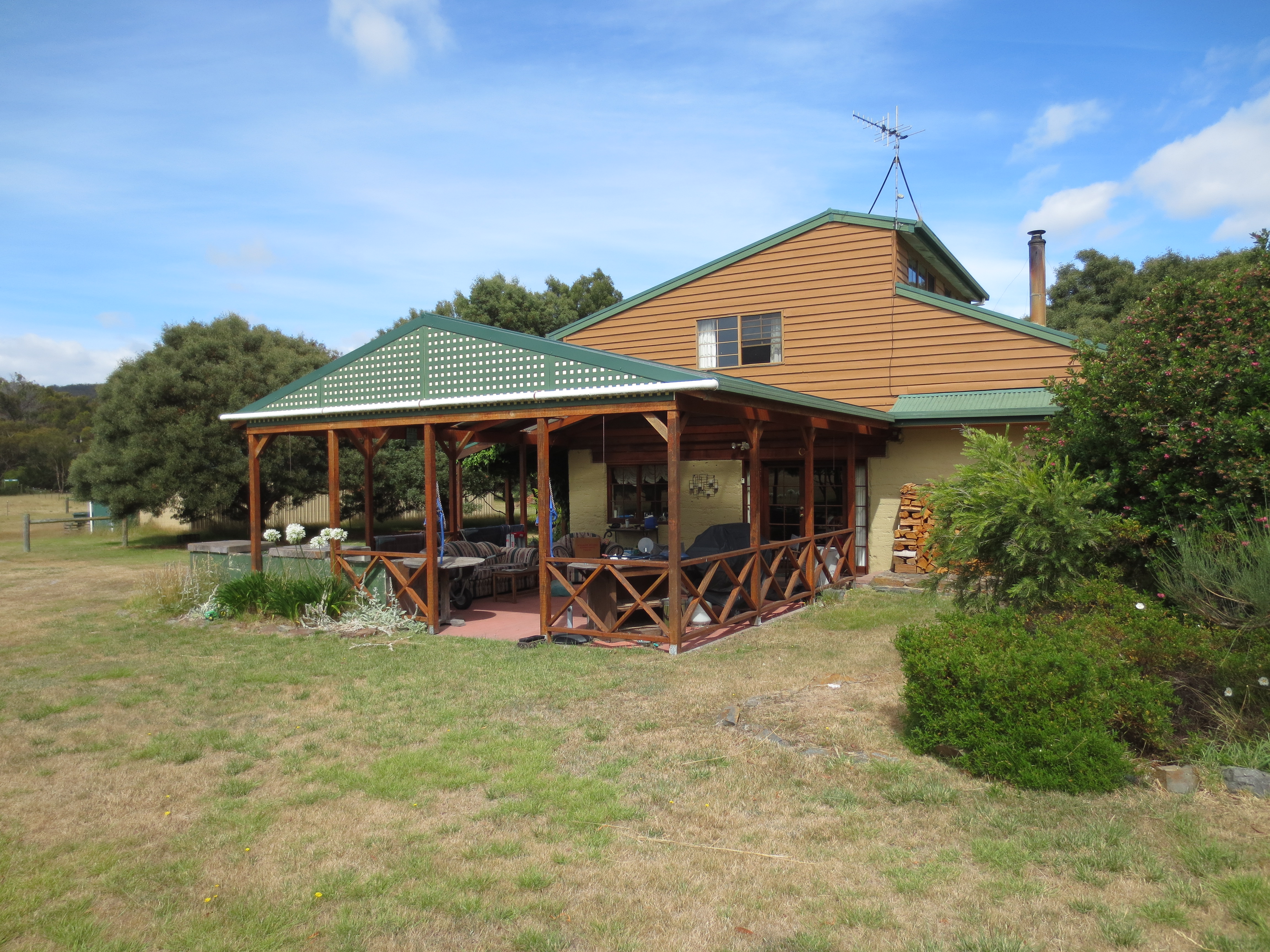

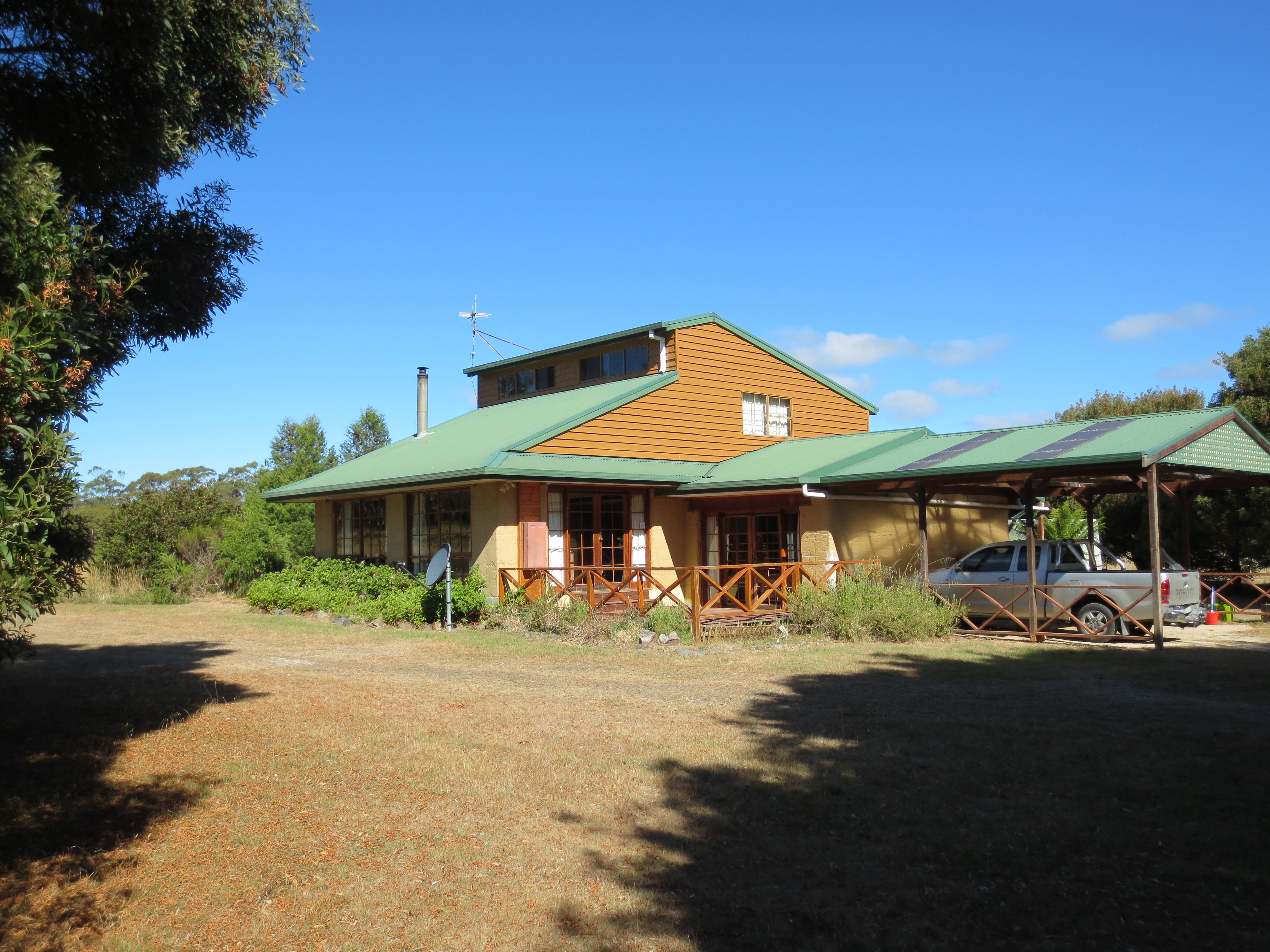

There hasn't been a hurricane (cyclone) or tornado here, and I've had my 'colourbond' roof since the house has built in '94. :thumbsup:
