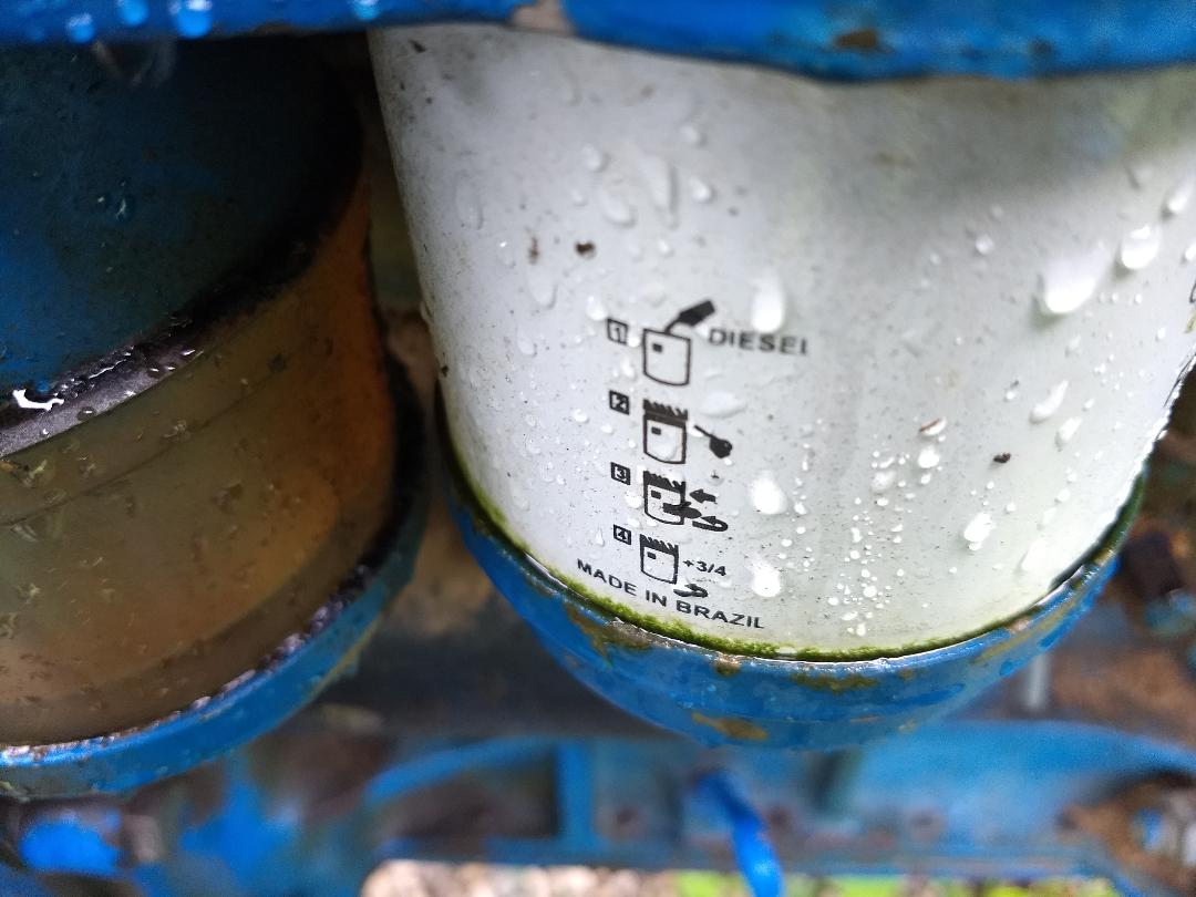

See attachment above. The left container is the fuel separator and the right is the fuel filter. I could not get a better picture due to the superstructure of the front loader.

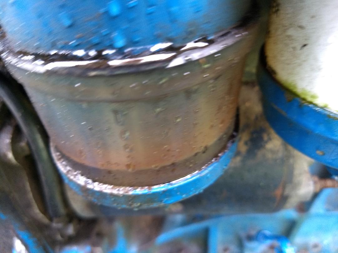

I sent two photos. One of the separator and one showing the separator left of the fuel filter.
Single picture. The previous thread merged the two photos. Sorry

llooks like the filter number is to the right of the directions ... just look on the side of the canister.
42013 (A51691)
