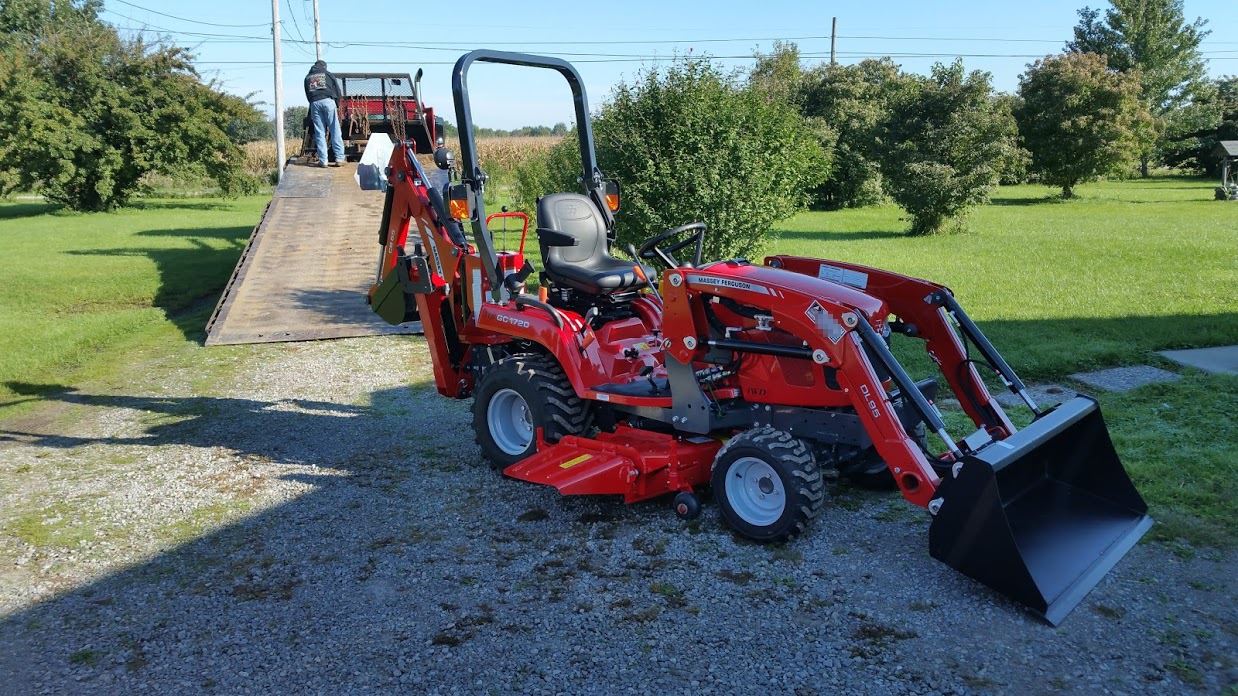

Hello everyone,
I took ownership of a 2018 GC1720 about two weeks ago-it had 2 hours on it. The weather has been wet here in Ohio, so I haven't had any time to really enjoy my tractor and test it out. I only have about 6 hours on it and that's mostly stationary idling or learning the backhoe controls-save for 20 minutes running a box blade up and down my driveway.
I also purchased my tractor with the 60" drive over mower deck-the Massey Ferguson 2326. It cuts like crap as is. I need to adjust it, yet. Its all out of whack.
I have searched and searched but I can't seem to find any help on how best to tuck my rear hydraulic lines out of the way when the backhoe is off-or how to route them when the backhoe is ON. I didn't pay close enough attention when I took the backhoe off the first time. When I undid the bungee cord the links fell down and everything kind of went everywhere. I have the tucked up and secured with another bungee when the backhoe is off.
I just don't like how it is. I'm afraid that I'll accidentally hit the 3PT lowering lever and just rip them off or something. I removed the PTO protective shield in an effort to get some room. I'm still not happy with it. When I connect the two lines that need connected and plug the other, it seems like I'm putting too much of a bend and stressing the coupling. I think this caused the fitting top weep some fluid when being used. I wish I had checked the hose situation prior to purchasing the tractor.
When I hook the backhoe back up, if I connect the hoses and let them go whatever they want to and alleviate the line bending and pressure at the coupling, they want to hand way too low. If I snake them in there to stay up and out of the way, I feel like there's too much pressure on them being too tight of a bend.
Anybody have some guidance on how best to deal with the hoses? I'm pretty paranoid that I'm going to sheer them off or pinch one.

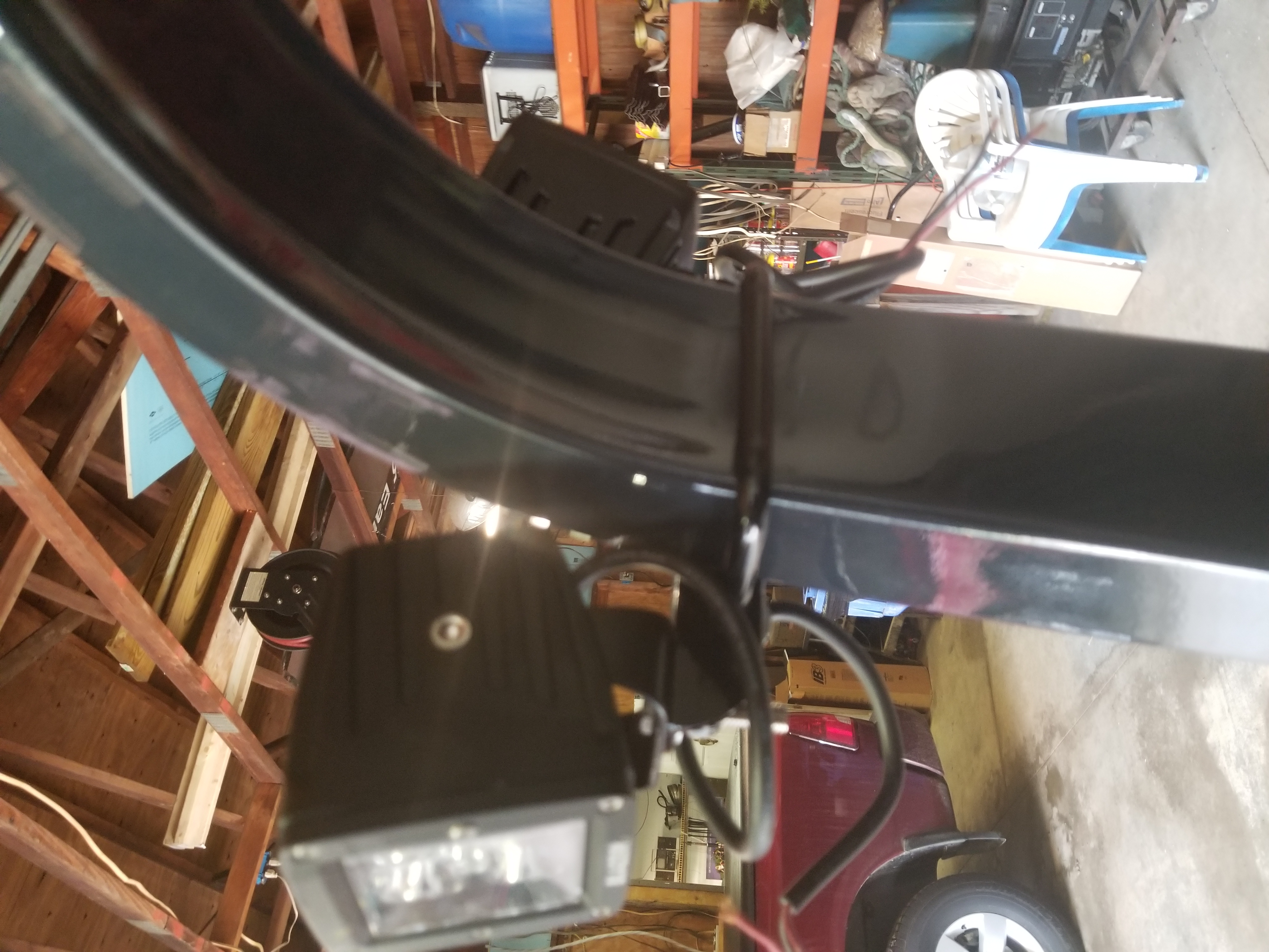

Has anyone mounted a lightbar to the ROPS on one of these? Any specifics about how it was done would be greatly appreciated. 20180928_100214.jpg

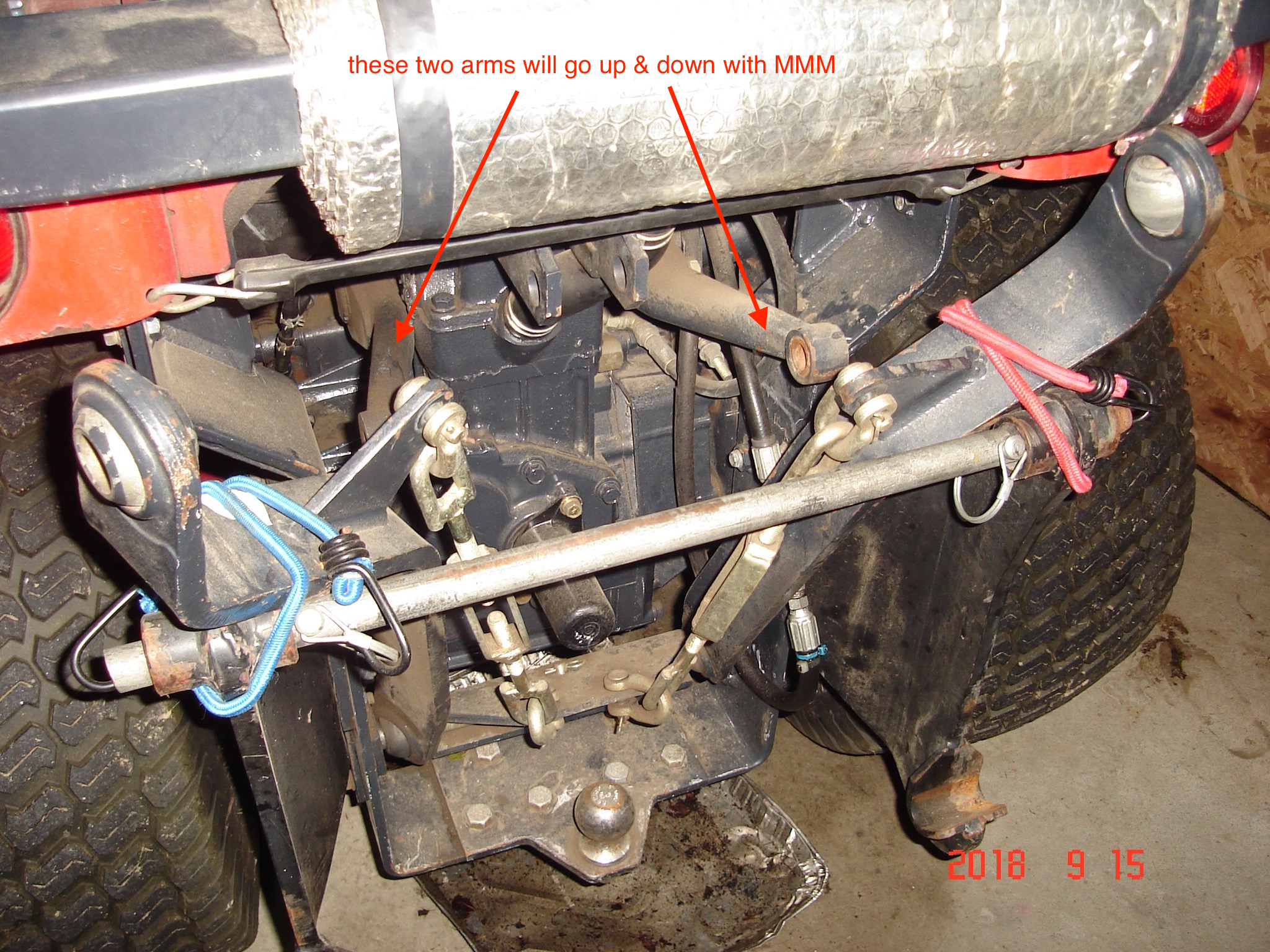

A lot of folks have had issues with BH hoses -- some incorrectly marked with colored tie-wraps, some not marked, and then there's the "What do I do with them when the BH's off?" questions. Everybody seems to figure out their own system. There are a lot of different models, going back to the 2300 series; there are differences in each model, but there are also similarities.
Do you have three hoses that go to the BH? If so, two (one male connector, one female connector) need to be hooked together, as they form the return line for hydraulic fluid when the BH's off. They're supposed to be color-coded, but....
I've devised a system to keep my hoses out of the way when using the MMM -- this needs to be done or, as you guessed, when the 3PH arms go up & down as the MMM is raised & lowered, they can potentially hit those lines or the 3PH apparatus.
I'll post a pic of what I did below, using a piece of 3/4" EMT tube, some bungees, and a piece of #10 THHN wire to keep hoses and 3PH stuff up & out of harm's way. This keeps all the 3PH stuff up, but far enough away from the back of the tractor that the lift arms don't hit anything.
You can see the 2 hoses connected for the return line in a loose loop hanging down on the right. What you can't see is that 3rd loose hose-- it's hanging behind the ROPs, held up & out of the way by a hook bent into the wire.
One thing you might also do (unless M-F has changed things with these SCUTs) is to add some extensions to the BH hoses. This will make it MUCH easier to hook it up and take it off. I put 18" extensions on mine, so now I can back up NEAR the BH --but not right on top of it-- and easily connect the hoses. Then I use the BH hydraulics to position the BH to mate up with the tractor mounts, then back up the tractor to meet the BH.

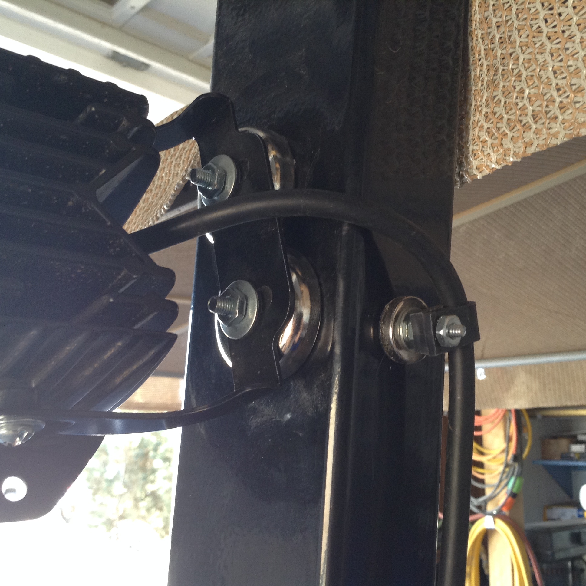

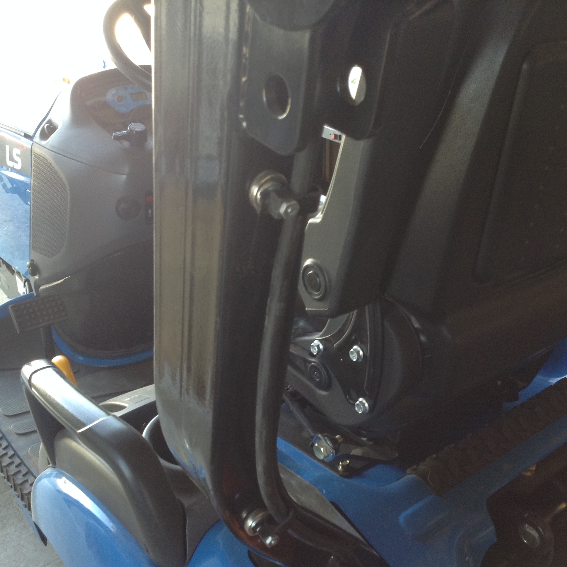

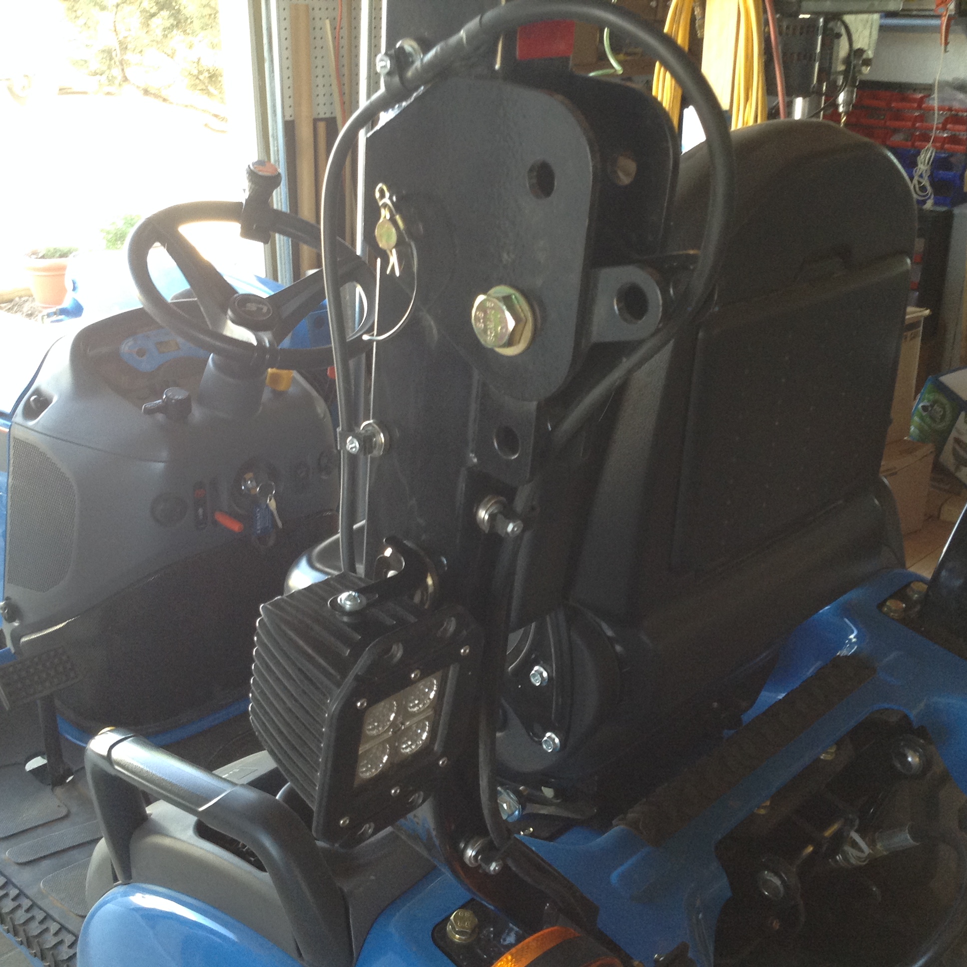

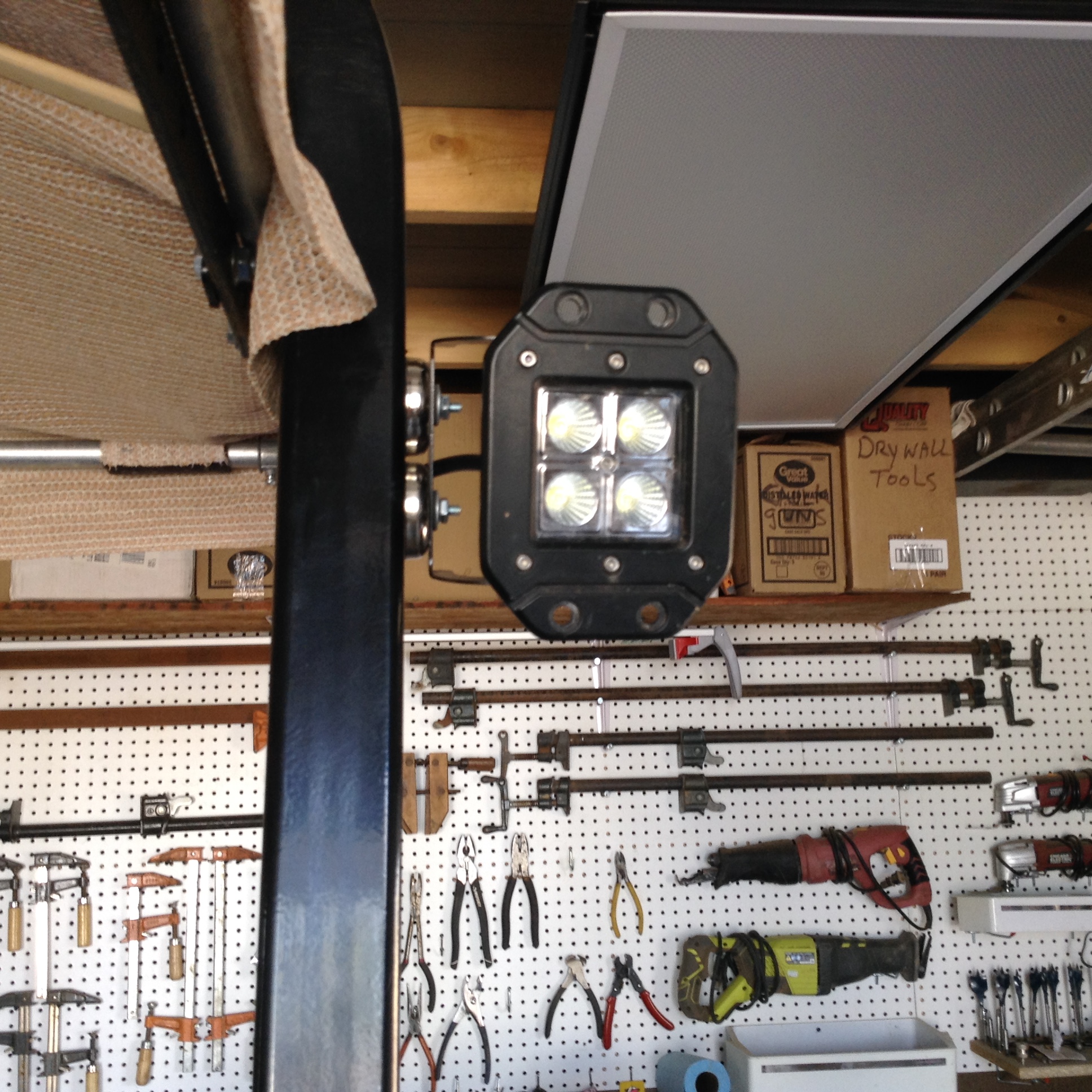

When I wired my extra work lights, I wanted to make them 'relocatable' for the task at hand. I mounted the lights using 30# magnets, then quite a few smaller neodymium magnets with cable clamps on them. Got the magnets off eBay....about $20 total
Like the magnet idea...

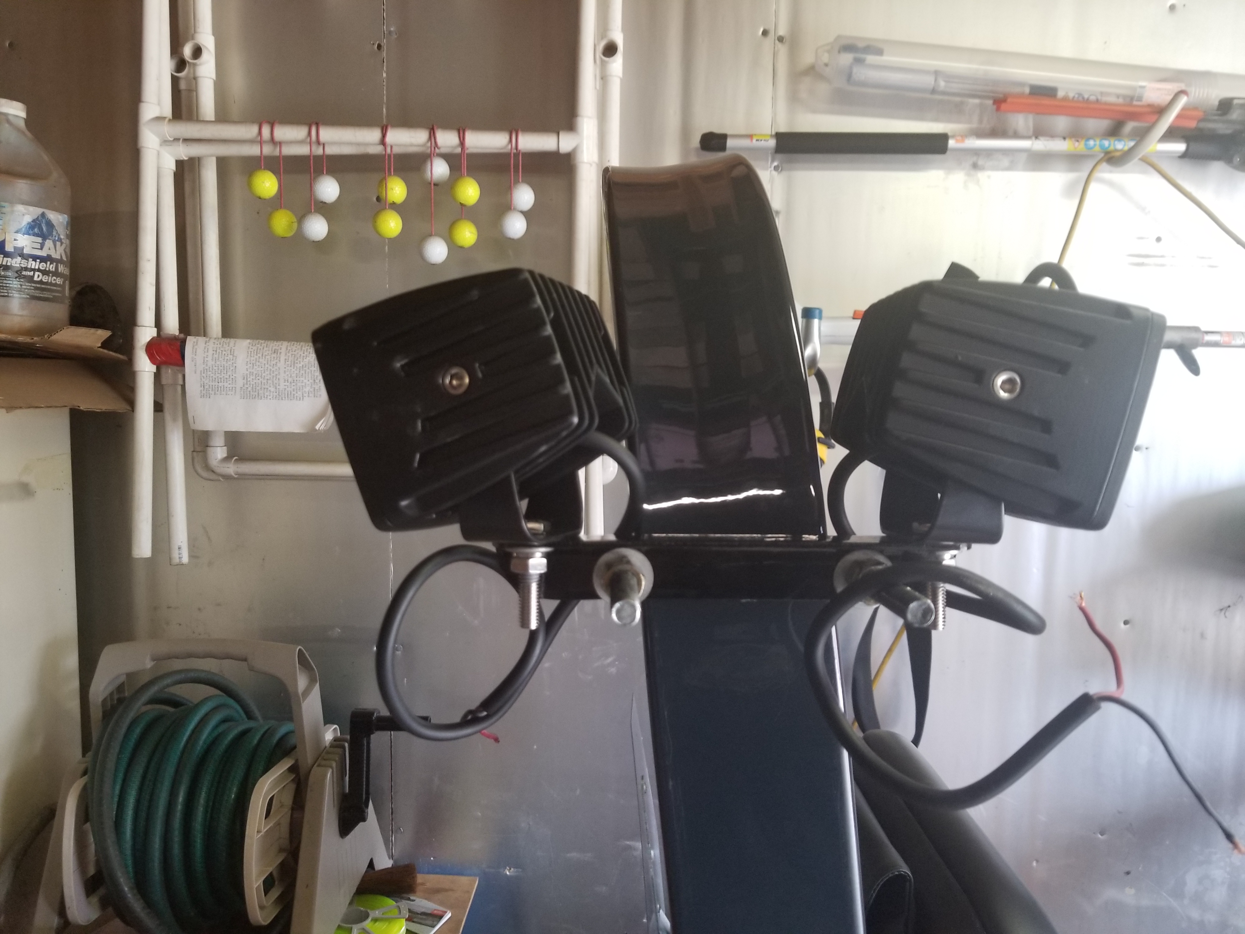

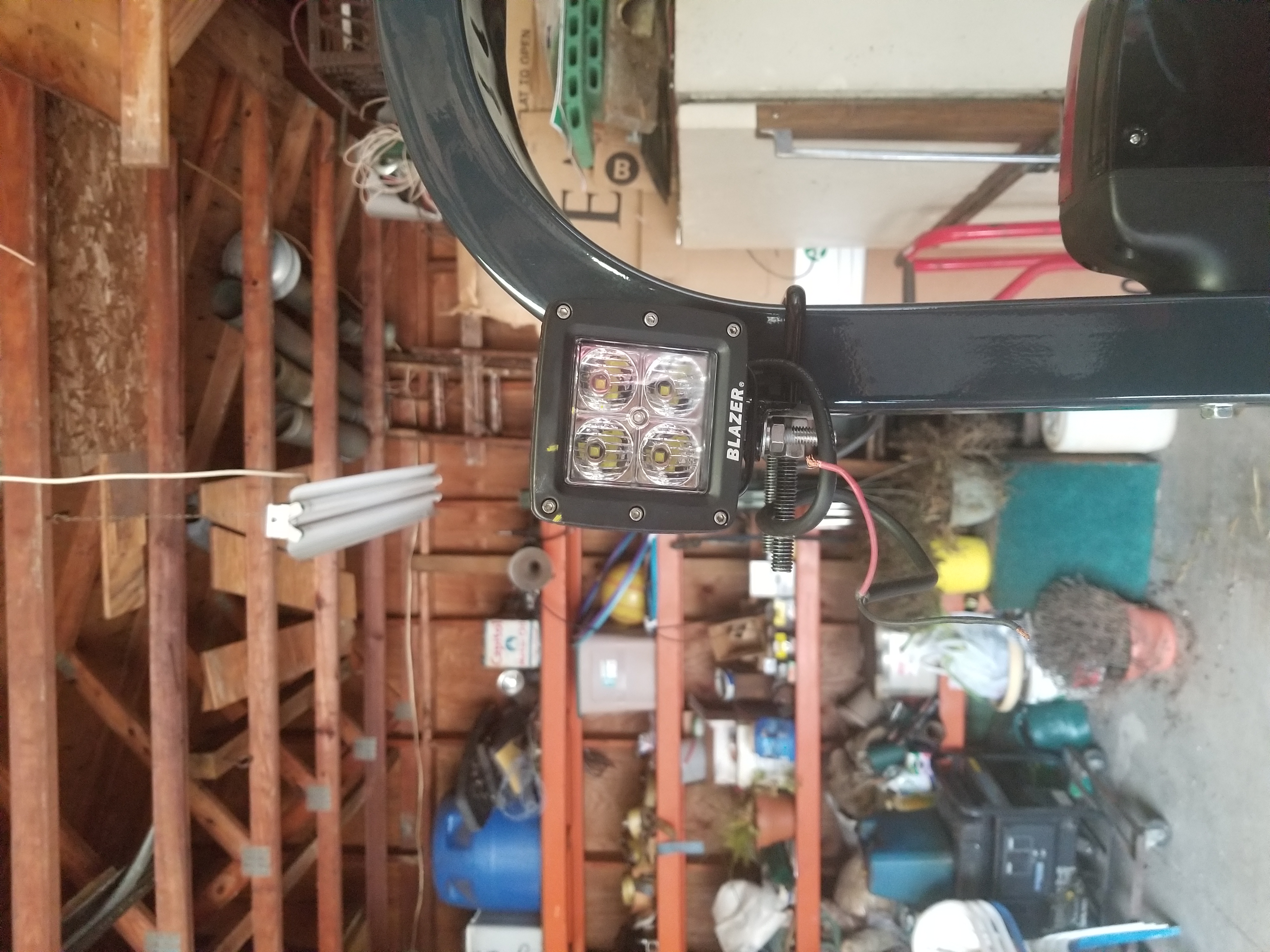

Here's how I mounted mine. Just a couple inexpensive LED spotlights, a square U-bolt, and a piece of angle iron.
Make sure you mount it far enough back so you don't bang your head into it if you hit a bump.
Actually, since I did this pic, I moved the lights to inside the ROPS to protect them from obstacles.

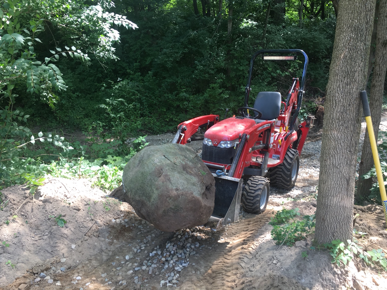

Also, how in the heck is that little tractor lifting that huge bolder? Wow!!
