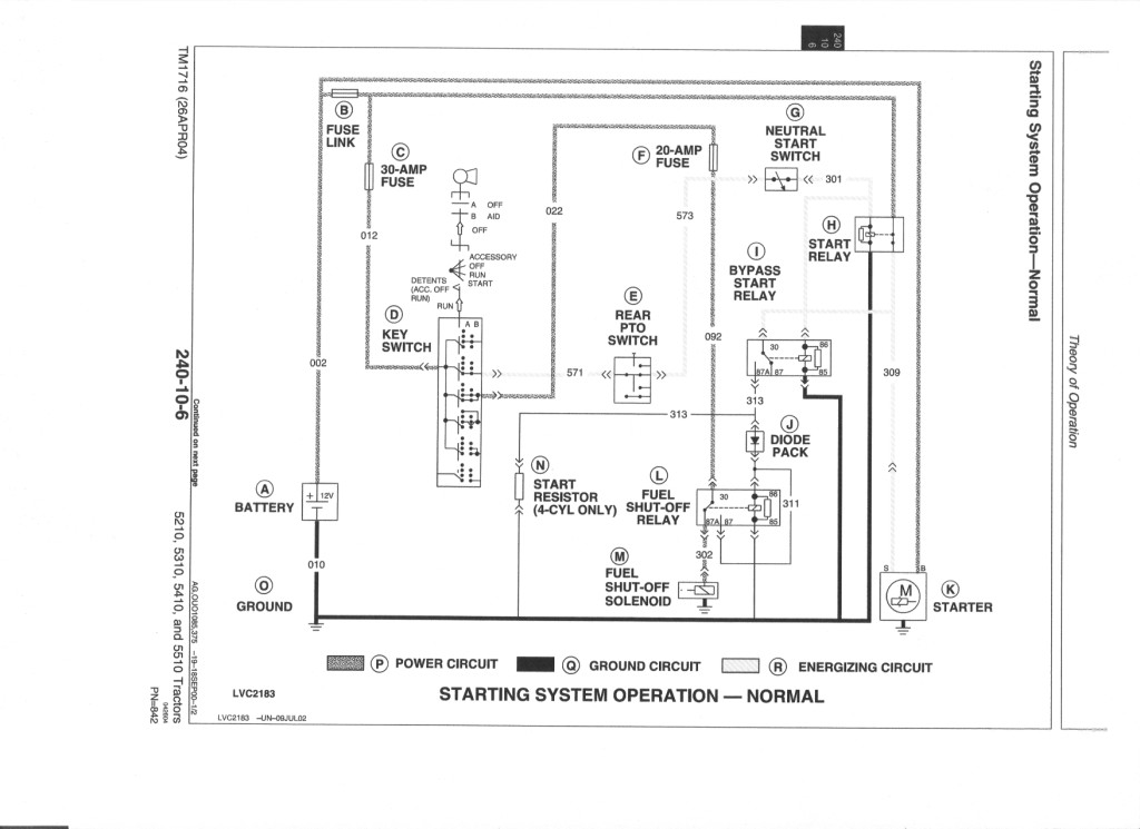

   / New member with a 5103 #3
While the 5X10 is not the same as the 5103, here is a picture of the starting system for the 5X10 that might help.
   / New member with a 5103 #6
Check all the 30 amp fuses. Over the years other members have indicated that the manual does not match up with the fuse box. Since you where bush hogging, you could have pulled the wires off for the 2 safety switches. Disconnecting while running would not stop the tractor.
Did some checking of some old posts and I think the starting system picture I supplied you with should be close to yours.
After you get it running you might check the seat switch as I do NOT think it plays a role in starting the tractor.

   / New member with a 5103 #10
Hopefully this attachment will help you locate the safety switches.
