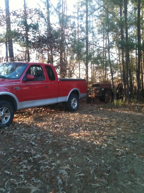

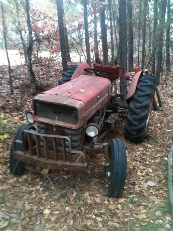

That's how it sat for 12 years.
Coming out of the woods after a 12 year nap.

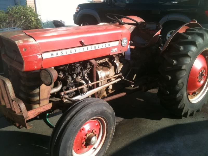

Cleaned up and washed off! First bath in OVER 20 years(Dad never cleaned it:laughing:)

Dang Levi,
She shined up good. I don't think the one I'm getting will do so well. I wish you well on the restoration.

It's a testament to just how durable these old tractors really are. After 12 years of sitting out in the weather, they still shine up like a new penny. Try that with one of these new tractors with plastic everywhere. :)
