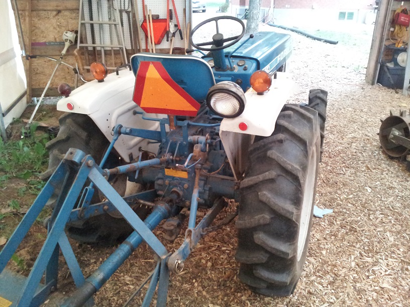

Well, we needed a second tractor in the same hp class as the Kubota L3200 to help with various tasks around the farm so we didn't always have to swap 3pt implements as well as for manure spreading. Been looking around for a while at various options and finally found this Ford 1710 and fell in love instantly.
Has about 700hrs on the meter, one owner and never had a loader so the front end is in great shape. It has always lived in the garage and the paint shows. Hopefully it gives us a good many more years of service. No remotes yet, but does have a good working 4wd.
With it came a very nice condition Ford 951 5' mower which will be handy for mowing the headlands and when things get away from me:eek: Front end of the tractor is a bit light with the mower on the back, but we will eventually make a better weight bracket for the front with a grill guard.
One additional bit of interesting information: According to the serial plate the tractor was made in the afternoon on the day I was born...felt like a sign.

That is a very nice looking 1710. I too recently purchased a 2 WD 1710 with 790 hours. Mine is in great mechanical shape and sheet metal is also good but it will get needed new paint and decals. I am currently in the process of building a sub-frame for installation of back hoe & FEL. I hope you have a good experience with your new toy.
   / New Member of the Family, My Ford 1710 #3
Nice looking 4x4 !!
Looks like you don't need anything. I can't see the muffler unless it is horizontal. If you get new weights for it keep me in mind. My 2wd needs some and those OEM types are perfect. I don't like it when the front end comes off the ground.
Thanks for sharing the photos.

Ya, it is a great little tractor and nothing was needed prior to using it in the field...even the oil is clean and new.
You are right about the muffler. It points straight forward from the exhaust manifold which helps with clearance issues.
I actually borrowed those front weights from a neighbouring farm who has a Ford 1900, but who doesn`t use them anymore. I think shipping though would be a little too much ;)
