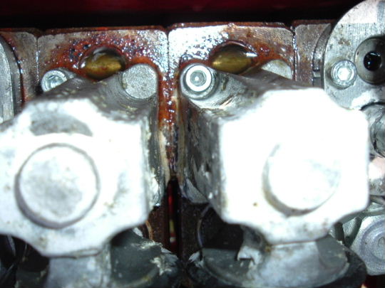

Greetings to all TBN members. After 2 years of reading TBN forums and countless hours at tractor dealers, I finally purchased a LK3054XS TLB. I felt for the price that this machine was what I needed. Heavy enough for hard soil but light enough for sand. Overall satisfied with the Kioti product but I have some issues with dealer installation of backhoe and associated hydraulics that are developing. Also the 4 post ROPS need to be looked at for proper fit. The dealer installed all the parts supplied but I noticed that it looked a little slanted to one side. After he gave me the installation manuals to read I finally found the reason. It came with 2 Plate FIX Front ROPS RH. It was missing LH one. Installing this way has bent the front ROPS Pipe. Or else it was bent in transit? Will take this up with Kioti engineering (Robert Kemp). I guess I'm just a fuss for perfection. I have documented the installation process from crate to delivery on dig-cam. I think the dealer was a little annoyed by me doing this but at 21k I felt justified. I imagine that any machine needs fine tuning,but how much? I wonder if Kioti has influence over its dealers?

I think my questioning of my dealers knowledge of this product fulfiled itself when tractor was delivered with front wheels on backwards. Called dealer and asked if it was normal for the air valve to be facing inward towards the tractor. His reply was that it must have been the only way they can go on. Manual shows cross section of wheel and how it should go on. Also states that if not attached as illustrated, transmission parts may be damaged. Reason for contacting Kioti is to verify faults in backhoe control valve assembly. 3 to 4 leaks arround 2 center valves and right top 4 way valve assembly. Could it be the seals were dried out or not seated properly when assembled. Dealer said its O-rings that need to be seated under pressure... Back and forth...Need expert opinion to have things fixed. Hence, Kioti engineering, if they ever get back to me. Still its a GREAT machine..

Thanks Ken for pointing this out. I found the tire rotation arrow and yes it's going the wrong way now that I reversed the wheels. My dealer is about 35 miles from me. I guess it's time to buy a trailer.
