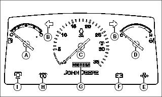

   / New Member - New JD 3203 Won't Start #7
3203's don't have glow plugs, thus no glow plug light.
Well, they use an intake heater and the 3203 does have what Deere refers to as a "Cold Start Indicator Light" (shown as Gage "H" in the attached picture)
If this is a new tractor, still in warranty, go with richamor's advice to call the dealer. I'm suspecting you have an intermittent short in the seat safety switch.
