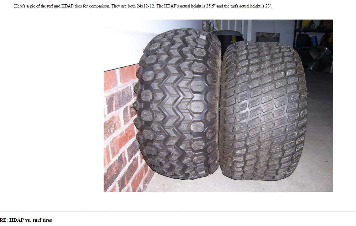

so i borrowed an X748 to see what happens and it went up no probs .. its about 100kg lighter but main advantage are the Carlisle HDAP tires .. awesome grip!!!
So if your yard is marshy don't get the turf tires .. the treads fill up with mud and they become useless .. get bar tread or something like Carlisle HDAP ..
   / New member looking for advice. #7
Here's a comparison of sorts ;
