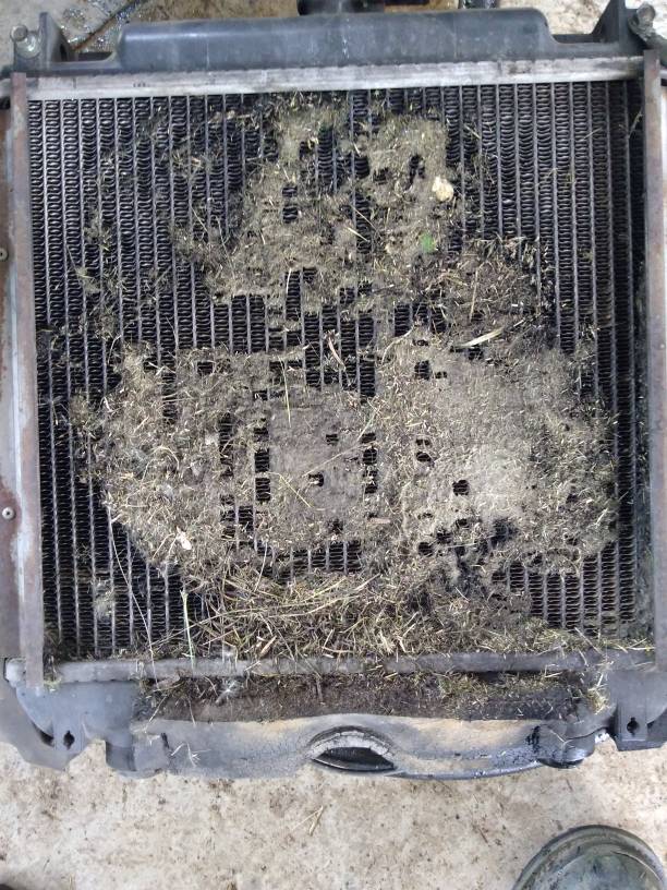

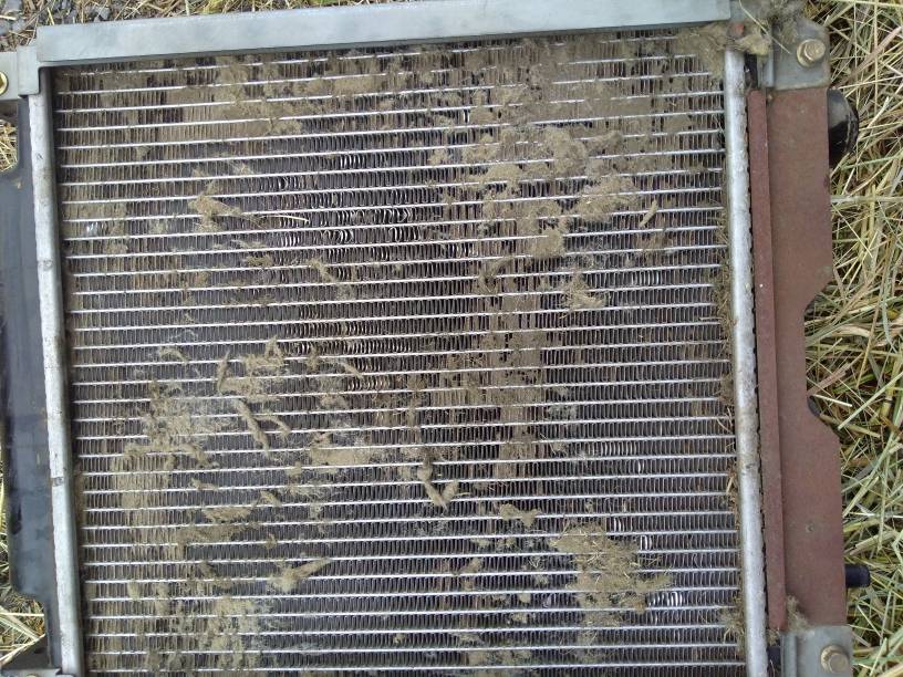

Here is what the radiators on our Kubota BX2660 and B7500 tractors looked like before I cleaned them.
They had similar symptoms which went away (and worked much better) after I cleaned out the radiators.
The B7500 also had a bad thermostat that was stuck open.
Aaron Z
   / New Member/Issues With My 1995 Massey 231 Getting Hot #5
Yeah, those pics are a great example of junk accumulated on the surface of the radiator.
The plugging up that I refer to is not visible on the surface. It is packed into the core internally.
If you cannot see thru the radiator, front to back, its plugged up. The light bulb procedure makes it obvious.
If you have another heat exchanger in front of the main radiator, there can be surface debris in between them. Examples of an extra radiator might be an A/C radiator, transmission cooler, hydraulic oil cooler, an inter cooler if you have a turbo. In this case, see if the auxiliary cooler can be detached and moved or swung aside so you can access the main radiator. Many times this can be accomplished WITHOUT unhooking the fluid hoses.

In my case, I had both. The surface junk cleaned off easily with a regular hose. The junk in the corps took an air hose or pressure washer to get out.
Aaron Z
