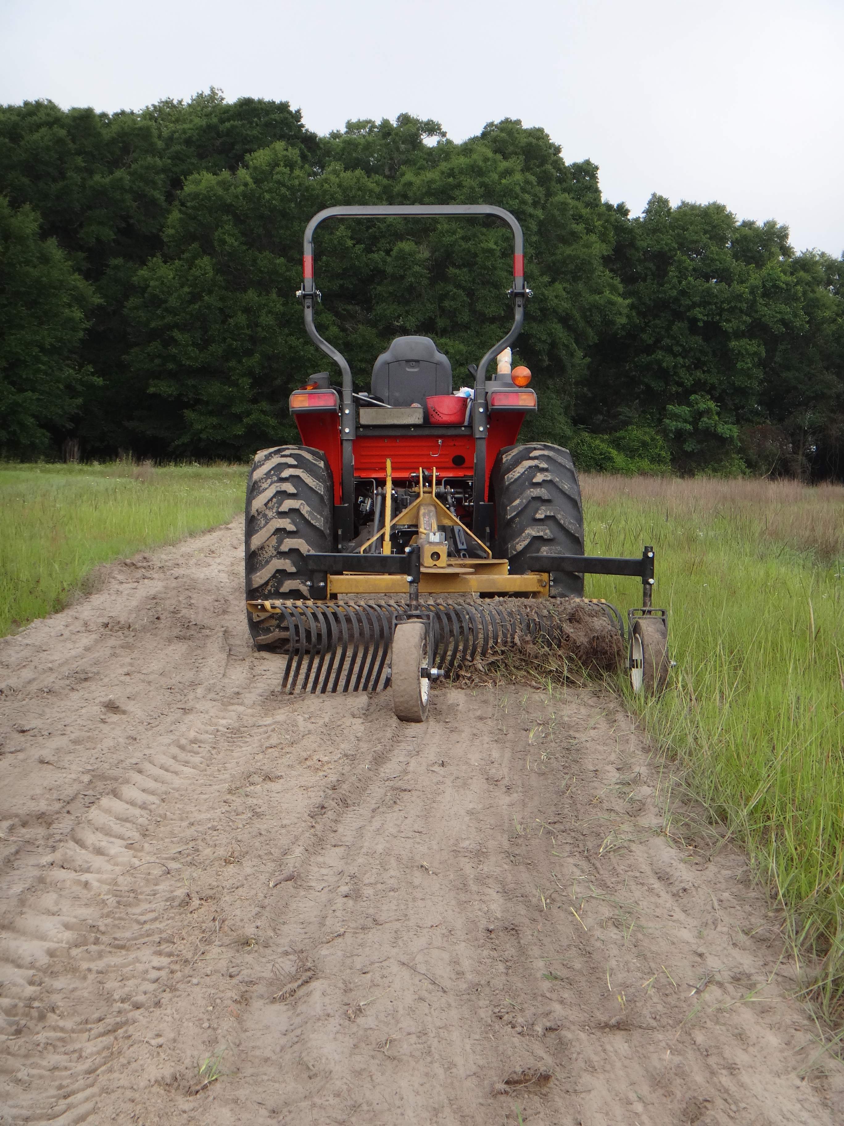

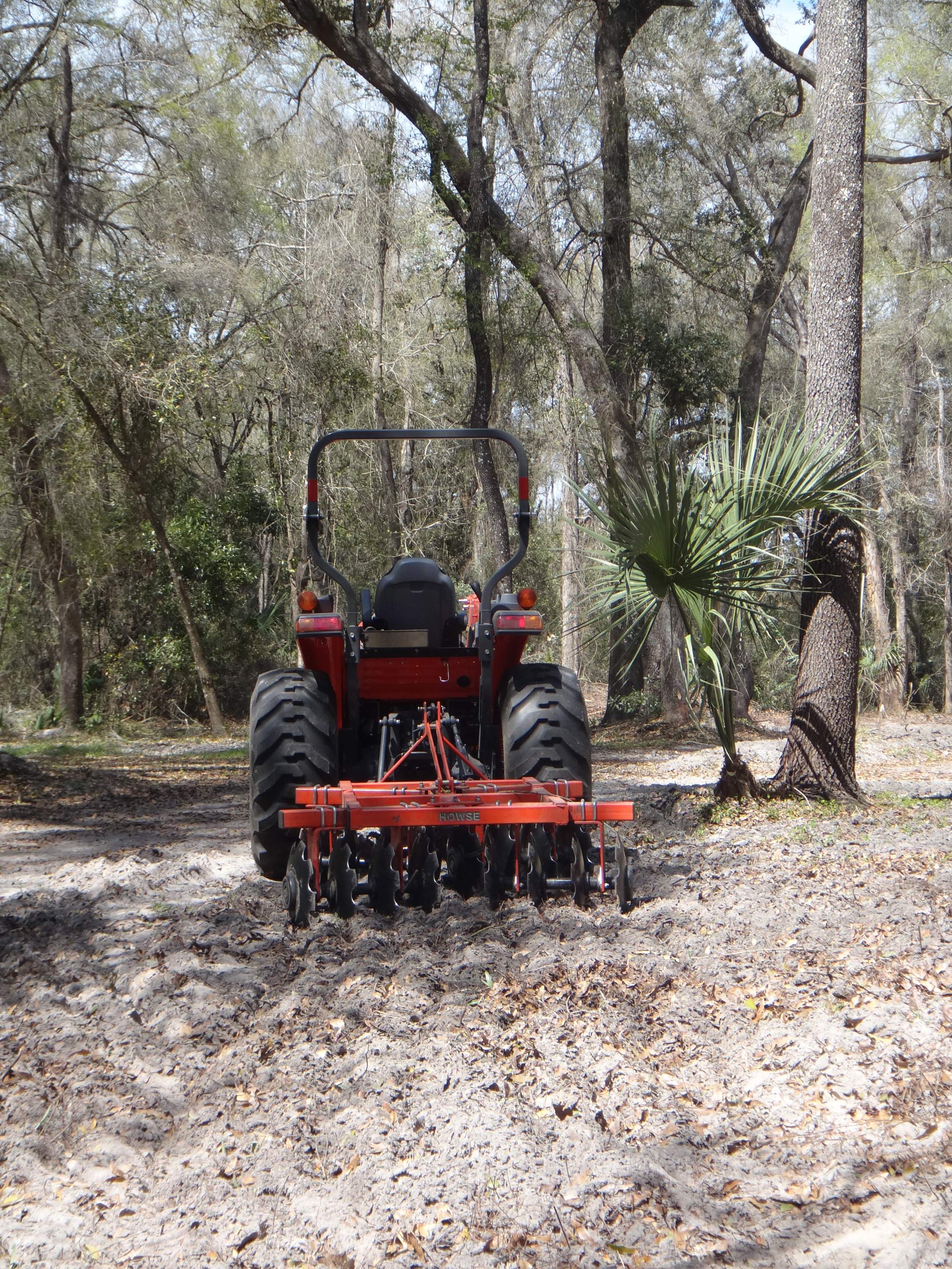

Shooting from the hip, for 50 acres, I guesstimate you need a 35 - 45 horsepower tractor with a Category 1, Three Point Hitch; Front End Loader, R4 tires, Four Wheel Drive and weight of 4,000 - 5,000 pounds without wheel ballast.
Implements: Ratchet Rake for the FEL and Disc Harrow with 20"- 24" diameter pans for food plots.

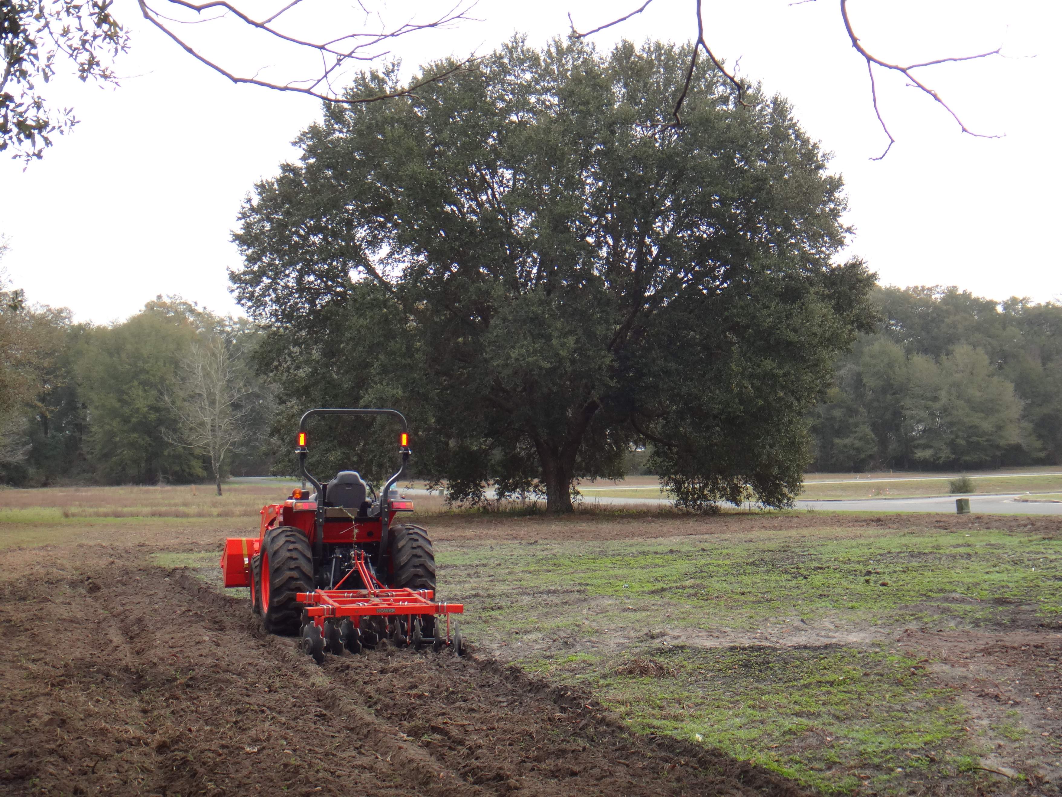

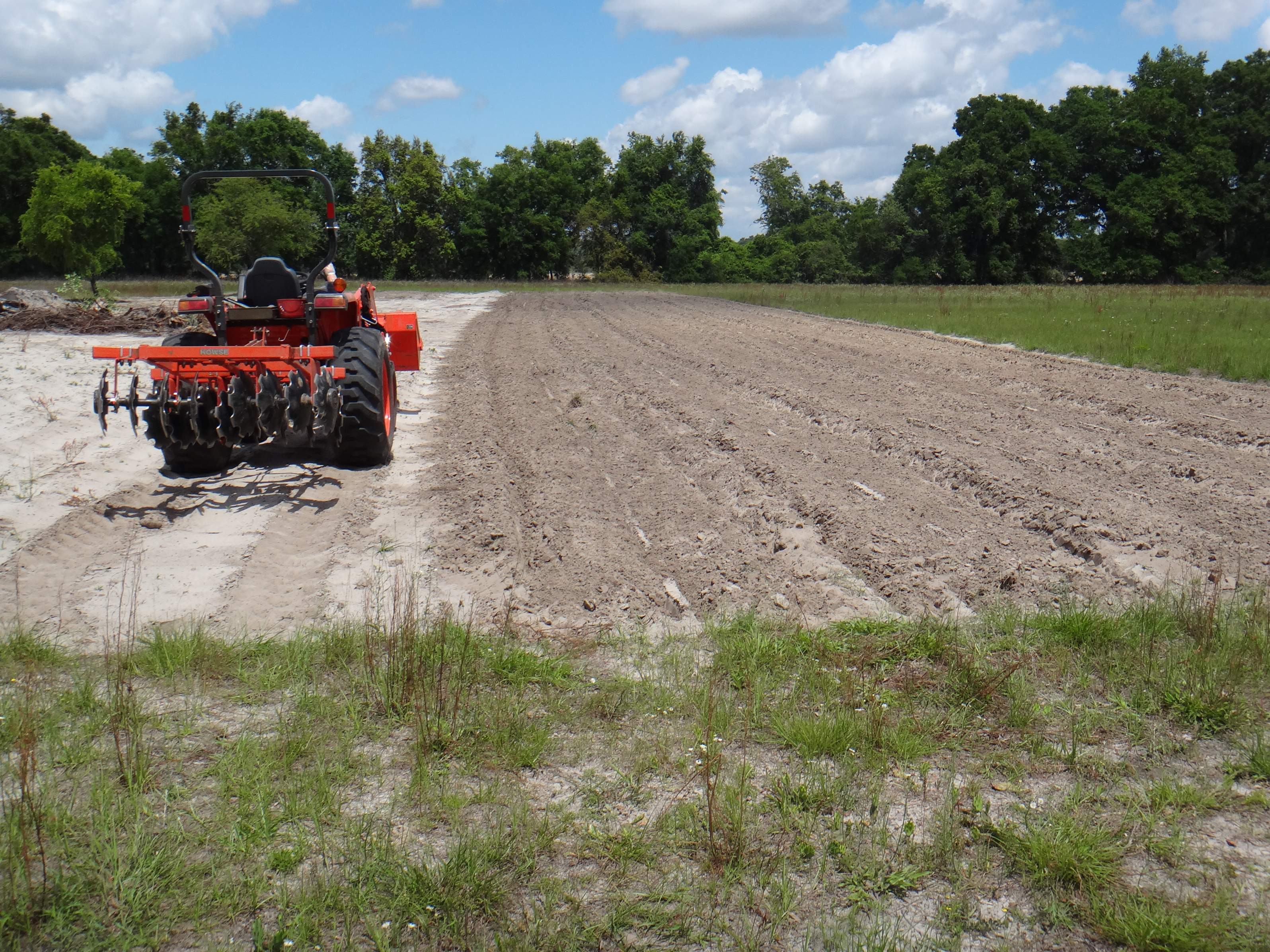

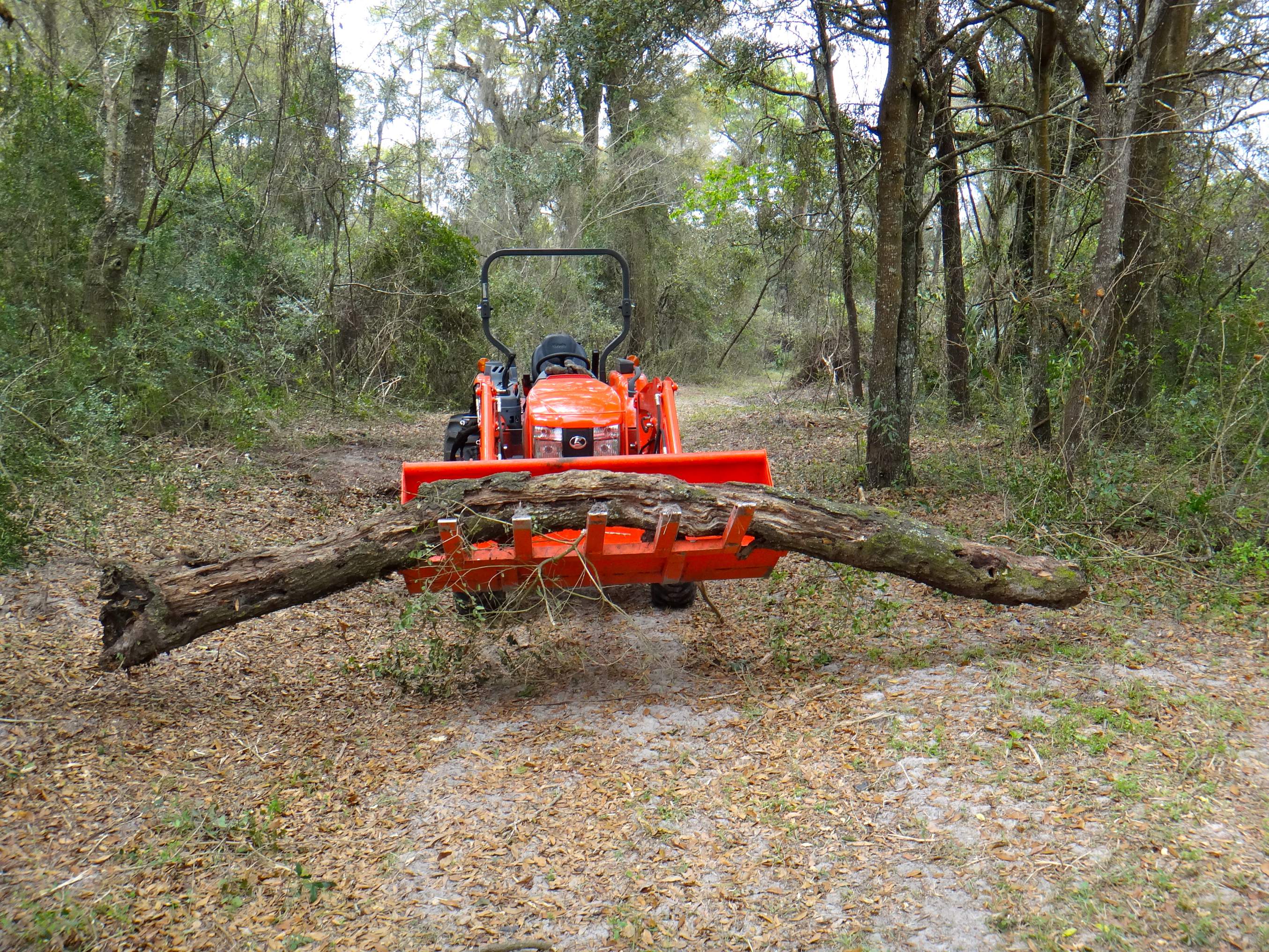

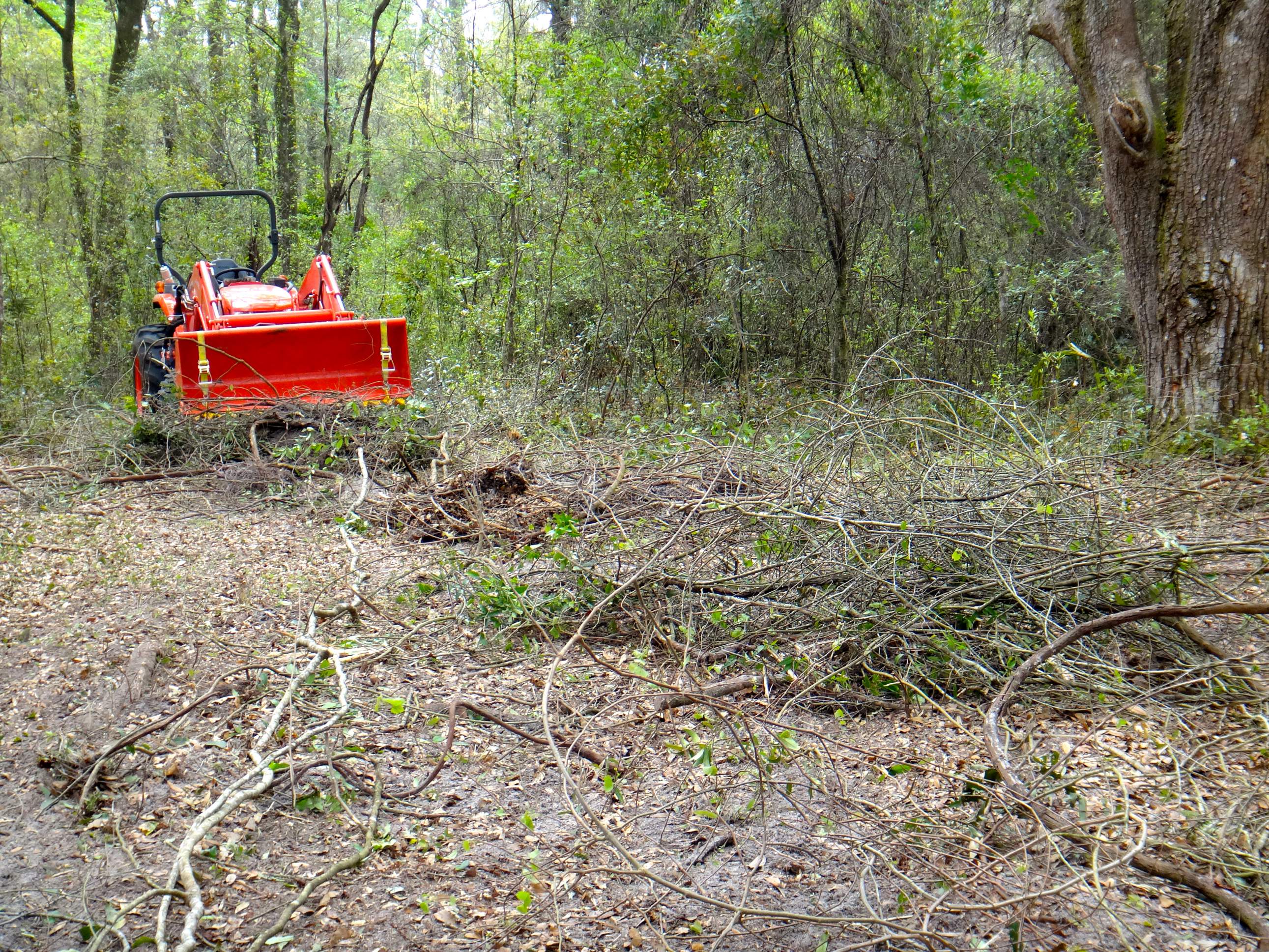

I am on my third tractor, second new tractor, in five years. An experience shared by many authors on T-B-N.
I started on a borrowed John Deere/Yanmar 750 - 20hp, then I bought a new Kubota B3300SU light frame tractor-loader - 33hp/25hp PTO. After 420 enjoyable hours decided that I needed more tractor and now have my dream machine, a new Kubota L3560 heavy frame tractor-loader - 37hp/28hp PTO.
The L3560 is hardly any larger than the B3300SU, it has hardly any more horsepower, but it is 2,000+ pounds heavier than the B3300SU, much more capable and much safer due to the weight and wider stance. For fifty acres you will get a heavy frame tractor-loader sooner or later. It is cheaper to start out with the right frame from the beginning, besides being safer.
The L3560 is quieter, vibrates less, and has standard features that make it much easier to connect implements to the Three Point Hitch.
You do not want to operate a tractor at the margin often. At the margin tractors are unstable and the law of averages will catch up to you sooner or later as your operating hours increase. Light tractors are always unstable on slopes. Operating close to the margin stresses the machine, which will require more maintenance and repair.
Keep an open mind as you continue to research.
