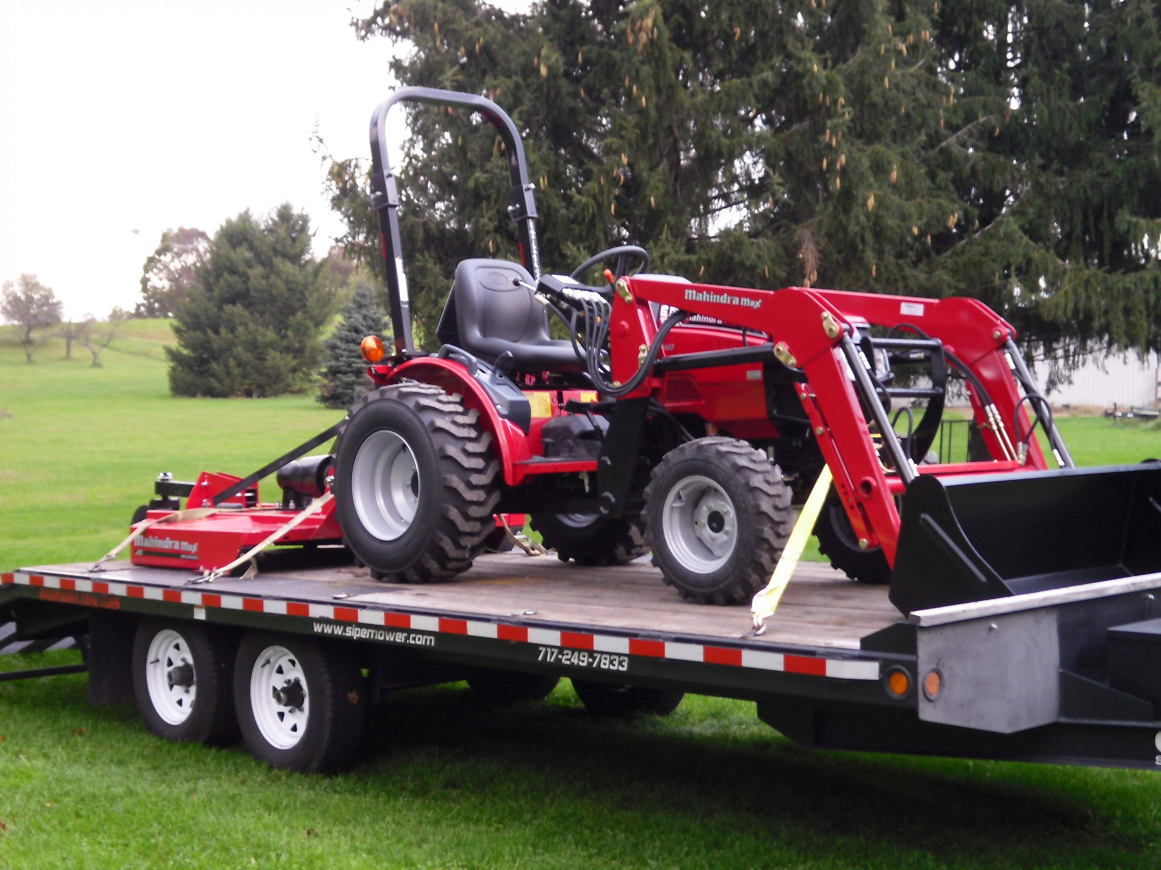

Quick impressions since we had our new Max 28 delivered last Wednesday (it's at our new house where we have no internet yet so sorry for the slow reply):
I'm happy with the tractor, I lucked out and it was 80 degrees and sunny the day it was delivered so I got to mow until dark in shorts and a t-shirt, and even got to test out the headlights. Then the next day a front came through and I got to mow in 20+ mph north winds with the temp dropping into the 40's by the time I finished. Normal Missouri weather pattenrn for October.
The tractor itself was flawless. I'm 6'2 with size 14 feet and found the seat, foot controls and steering wheel comfortable. I mowed with the FEL on, haven't attempted to take it off yet primarily because I dont want to take up the extra space in the garage and I don't want to leave it sit outside. Had no problems navigating to mow with the loader on. I went over all the bolts on the tractor and wheels after 8 hours of mowing and didn't find any loosening up, they showed me all the spots to grease at the dealer but I know I need to rely on the manual to make sure I hit them all and haven't done that yet. Very happy with how easy it is to maneuver the tractor, we have a big garage with a single door and it was no problem to get the tractor in and to one side so I could still pull in my truck. I agree the seat belt is a pain, it's way to easy to lose sight of and I had to get off the tractor to find it a few times, plus just forgot to put it on a few other times. A better solution is needed. The oil dipstick location I can live with as long as oil use doesn't become a nagging issue, and based on everything I've read it won't be.
The RFM not so flawless. The dealer sold me a Farmline brand (said it was much cheaper than a Mahindra) and I lost one of 3 bolts on one of the two covers over the belts in the first 45 minutes of mowing. Have had to keep tightening those things up every time I stop, would appreciate suggestions on how to make them stay tight. Also hit a relatively small rock and one of the blades started hitting metal making a really loud noise. Neighbor came over and helped eliminate the noise with a 2x4 and sledge hammer, but showed me there was also a chip out of the blade, his impression is that the mower is cheaply made overall. There's also alot of grease coming out on the top which is a concern.
Also bought a rear blade but haven't played with it yet, hopefully the off-brand on that won't be as much an issue as the RFM seems to be. I (of course) played with the FEL but didn't do anything productive with it, it seems very easy to control and solidly built.
We'll be back at the house this weekend, hopefully I'll get to go through the owners manual and check out some more stuff.
I have seen the bolts in the deck replaced with studs and then nuts with the plastic locking inserts used with a lock washer to stop the loosening and keep things tight. The venting of oil from the gear box on either a RFM or rotary cutter is normal. You may want to switch to synthetic gear oil to eliminate this somewhat. The synthetic will also tolerate high heat and keep on lubricating better than dino oil or grease.
It also sounds like you are using a RFM for what a rotary cutter was designed for. A RFM, regardless of brand name is not going to like being substitued for a rotary and will have a very short life span. If you bent one or more of the blades on the RFM as you alluded, I would suggest stopping by the Dealer and purchasing replacements. I have never seen anyone straighten a bent blade good enough to prevent stressing the spindle causing a short life span and eventual replacement. I would also suggest walking over the area you are cutting and removing all the large objects prior to mowing with either a RFM or a Rotary Cutter.

If by a rotary cutter you mean the same thing as what I've always referrred to as a brush hog I definitely do not want that, the yard I'm mowing looks much more like a golf course than a field. It hadn't been mowed for a few weeks and we had some rain so that's why I didn't see the rock I hit, but it was pretty small (maybe 6 inches round and half that deep) so I didn't think the blade should have chipped, though I understand some rocks are more solid than others and it probably just depends on the angle I hit it at. I think you're right that should get some spare blades, thanks for the advice and the info on the bolts and and gear oil.

A rock 6" round is quite a rock to hit with a finish mower. I wouldn't fault the finish mower for having a chip in the blade.

I'm not familiar with the Farmline brand so I cannot comment on the FM. A quick way to keep those bolts on, however, is an application of blue (not red) Loc-Tite (thread locker). If you don't have any already in your shop, get some. The blue will handle most any vibration-related issue of fastener loosening. The red is even more secure, but often requires heat to break the bond.
I understand that you certainly want a finish mower to do the best possible job on the lawn. I have to tell you, however, that sooner or later you will want to get a rotary cutter. That's because an RC is SO useful. It allows you handle coarse field grass with ease and helps to tame the "wilder" sections of your property which may be covered with brush, briars and even small trees about an inch or two in diameter. They are designed with the expectation that rocks and stumps will be encountered.
