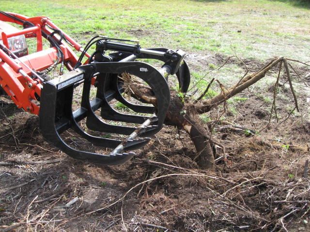

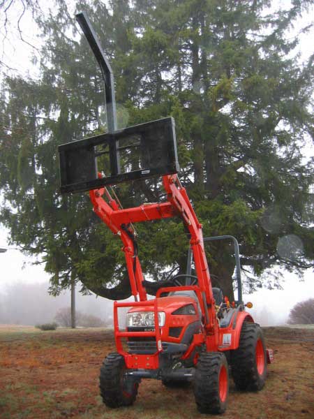

I have a 60" bucket on my Kubota with a 18" wide Andy Tatro grapple. I have had no issues with it as have several other TBN'ers.
The one problem I see with the Dehner Arm is that it has no teeth to grip with.
I have both a grapple on my CUT and a 4-n-1 on my dozer. Each has their strong and weak points. If all you are doing is brush work then the grapple wins. If you hare moving and spreading dirt then the 4-n-1 wins. Either will handle manure cleanup.
One more thing, the grapple detatches by removing 2 pins and disconnecting 2 hoses. Try that with a 4-n-1.:(

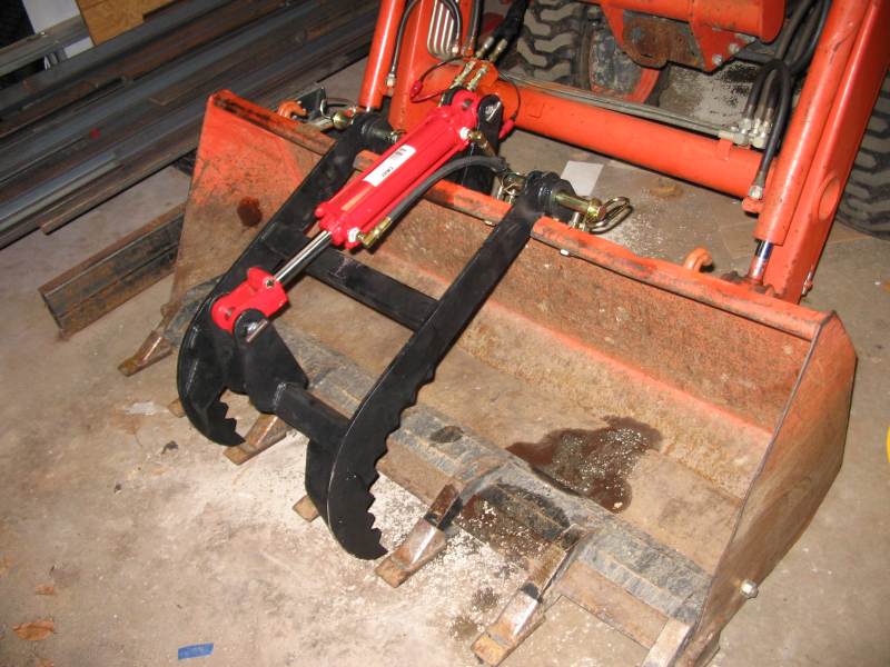

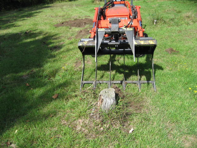

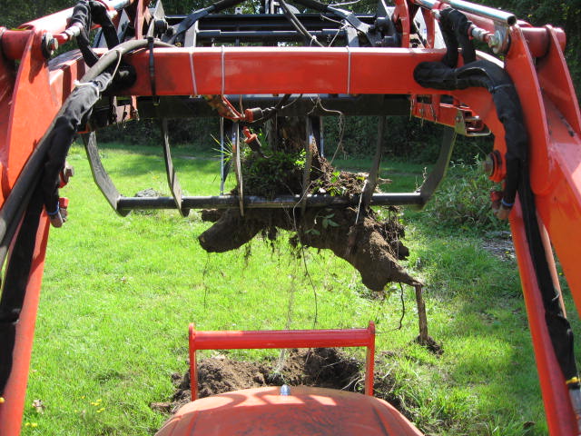

MikeB44 said:

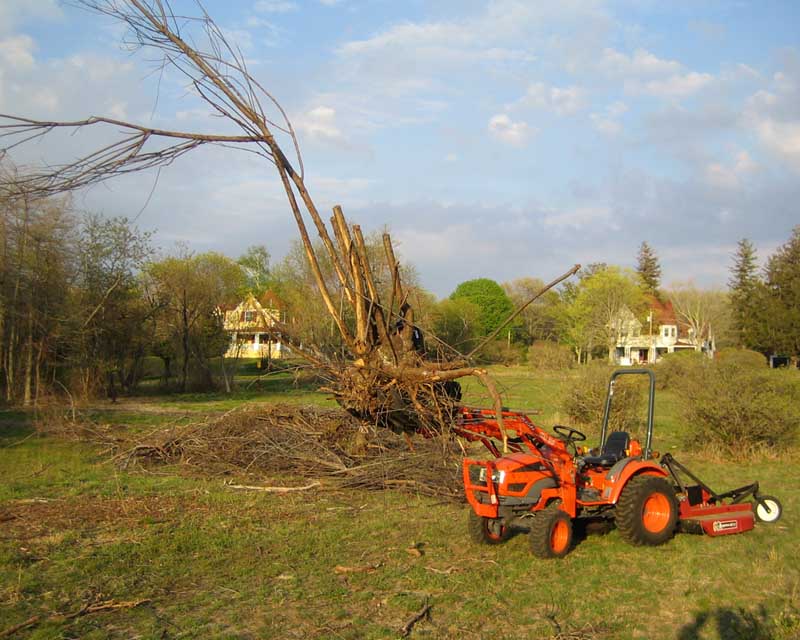

In mentioning a single arm grapple to the ATI dealer, he said that I needed 2 arms (cylinders), otherwise odd shaped stuff would fall out of the bucket (like grabbing near the root ball).

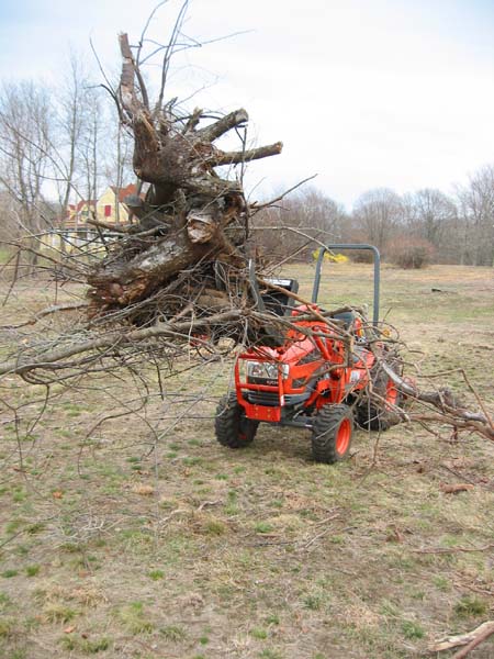

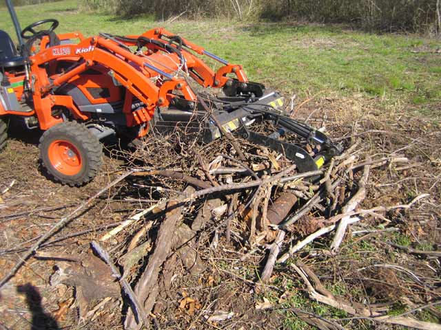

Baloney. A single arm grapple does fine. See photos. There are some advantages of longer arm or double arm grapples but the short (or narrow) single arm grapples have advantages too. I don't have any trouble grabbing and lifting a root ball with my single arm grapple. Indeed, with the single arm I can do some things that a longer arm or double arm grapple cannot. For example, with a smallish tree or stump that is too big to just lift out of the ground, I can put the lower jaw tines under the tree, push forward then close the jaws so the upper jaw actually cuts through the side facing roots from the top and allows the tractor to effectively unroot the tree. Couldn't do that effectively unless I had the two "incisor" teeth of a single arm grapple.
I've never had a situation where I wished I had a double arm grapple. The root ball example is not an issue. Instead of picking up the root ball sideways, you just pick it up from front or bottom. No biggie. I sometimes wish I had a longer (wider) top jaw when pulling brush out of the woods simply because I could get an even bigger bite but that sort of work accounts for only a small proportion of total work so it does not make much difference overall. Picking up brush is not an issue because it tends to tangle itself up and bind together in such a way that the single upper jaw can easily hold it together while I bounce along traveling a couple hundred yards to the burn pile.
I do find that having a clear view of what I am grappling to be very helpful. If I had a bucket grapple I could not see where my tooth tines were at all times and it would limit my ability to accurately rip apart a tree trunk that required a bit of dismantling before lifting. With a bucket grapple, at least the type where you add a grapple to the regular dirt bucket, you lose a fair amount of capacity for brush and logs due to the bucket sides too.
My grapple is the 48" Millonzi. I don't find myself running out of "grapple" sooner than I run out of lifting power with my loader. These things are designed for skid steers so any loader with up to 2000 or 2500 lbs of lift capacity would be appropriate.

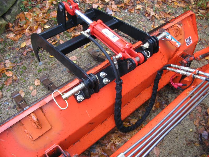

The grapple is bolted to the bucket. The Tatro grapple base is 1" thick flat bar and it's not going anywhere with eight grade 8 bolts holding it on. There is basically no way the bolt holes in the bucket will ever deform.
The 3/8" weld-on grab hooks are welded onto a piece of 1/2" thick plate then the plate was welded onto the bucket.
The picture explains it all.

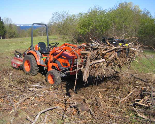

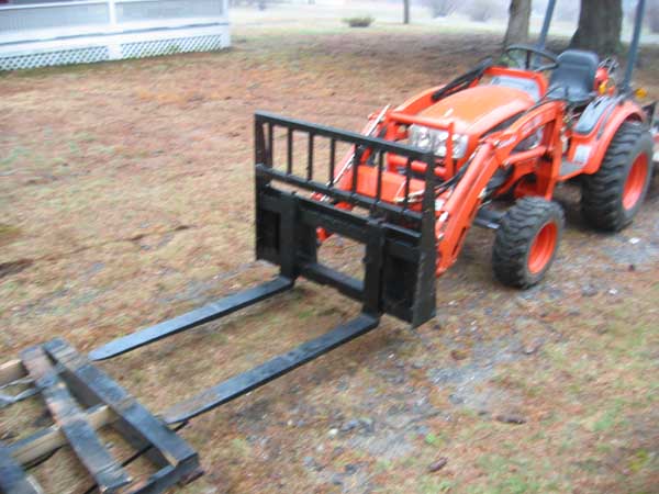

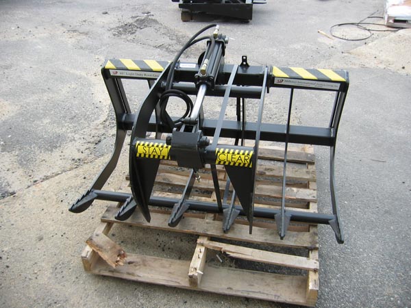

The Millonzi 48" Light Duty Root Grapple with QA mount weighs 280lbs. My CK20 loader can lift 1070lbs at the pivot pins. I'm not sure if the lift capacity you quoted is mid bucket or pivot pins but in either case the Millonzi would be fine. WRLong also sells a very nice lightweight grapple but for lots more $$$. I got mine via eBay and I have heard a variety of prices quoted to other TBNers from mid 600's to over 900. You'd have to call Millonzi and bargain I guess. ATI sells one too I think $$$ and ATI definitely sells a nice QA adapter (approx 650) for your loader that would work with any "Bobcat" or standard QA attachment.
I think bucket grapples are very useful but if you are really doing a major land clearing operation strongly consider getting a true grapple for the job. You can always sell it when you are done and it will be much more efficient than a bucket grapple for brush. I doubt you'd have any trouble at all selling a used QA grapple. The bucket grapple would be more efficient IMO than a 4n1 for brush.
Other QA attachments that are useful to consider are a tree boom, forks, QA bucket (you could modify your stock bucket just by removing the pin ears and welding a QA attachment plate ($150) to the bucket. The beauty of the QA system is that implement switches are trivial and quick. Some people will buy a plain backing plate and attach other implements (such as a trailer hitch so you can add or share other implements). Bottom line is that you can use most anything a Bobcat can use if, and this is a big IF: 1) the device does not require high flow hydraulics (eg. mower) and 2) it is not too heavy for your loader (mileage will vary here but many QA implements are very heavy duty and weigh more than half your lift capacity).
