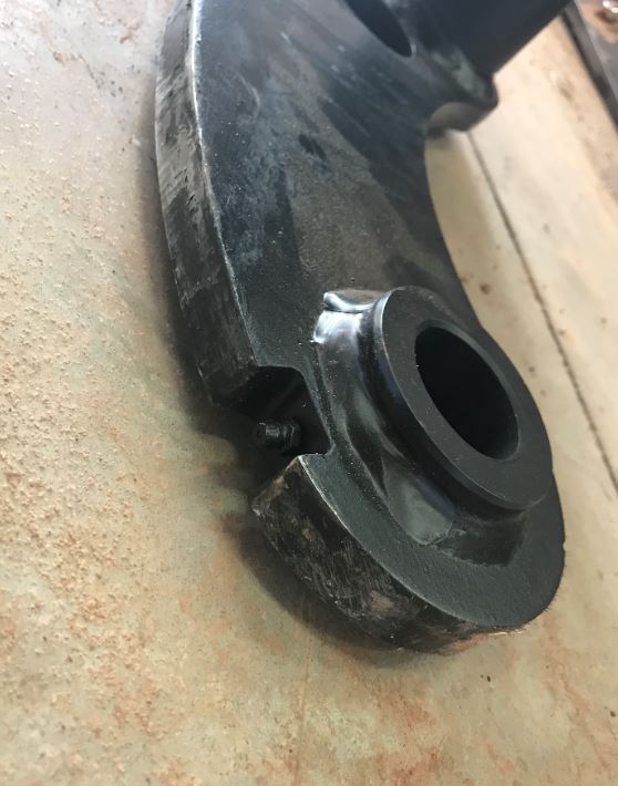

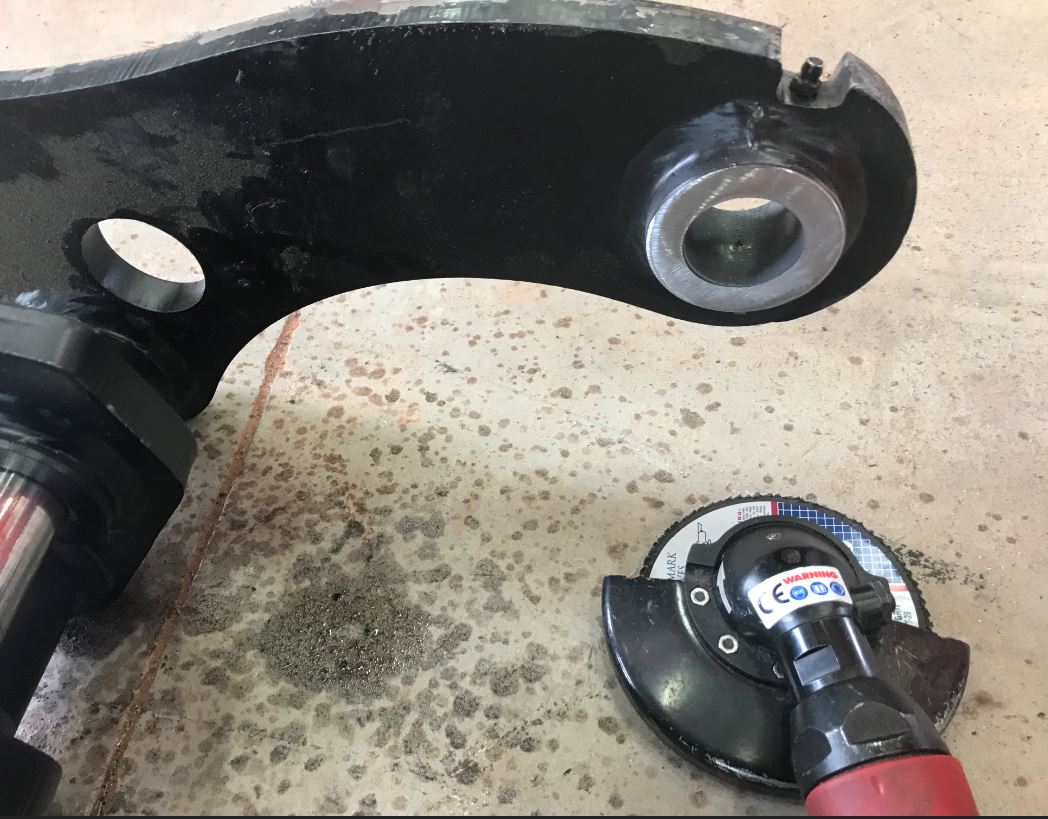

I finally convinced myself that it was time to add a thumb to the M62. After getting a quote from my local Kubota dealer (which is great but... ouch!) I decided to see what else was out there. I sent out several inquiries to various thumb manufacturers to see what was available. All but one either didn't reply at all or replied with 'sorry we don't have anything'. A company called ShowTimeFab replied almost instantly with basically 'we can build you anything you want'. Skeptical- I decided to give them a shot and WOW did they deliver! They answered every email within about an hour, they were super friendly, the thumb arrived very quickly (1 week +/-), It saved me about $1K, and the product is spectacular.
I was really not looking forward to install this thing. I'm thinking 'those big pins are not going to come out easily, everything is heavy, and SOMETHING is going to be wrong' but, to my surprise, start to finish I only spent about 1 hour on the install (not counting having to stop to take my wife to pick up her car from the body shop... grrrr!).
Here is how the install went for anyone that is interested.

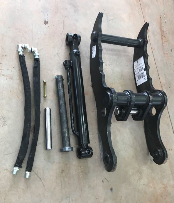

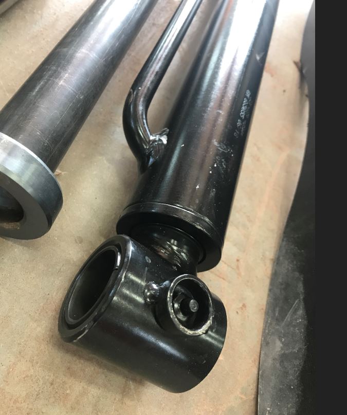

Here is the kit. The parts all look amazing. The welds are perfect and, until I drug them around on the shop floor, the paint was perfect also.
I love how the grease fittings are all recessed and protected.

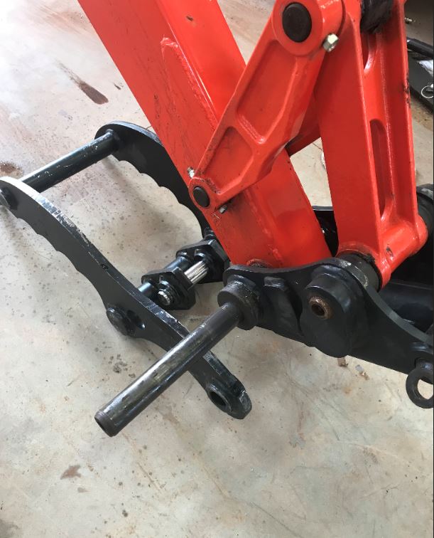

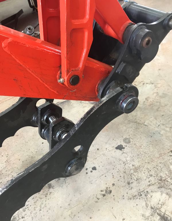

So to start the install I drove the roll pin out of the main pin and used an air hammer to drive out the main pin.

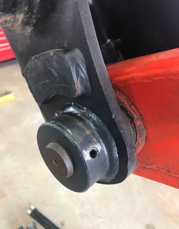

Since no one (but Kubota) had a kit for this exact machine- this was a custom kit that was built to my measurements and... well... I measured wrong. :( I ended up having to grind about 1/8" off the thumb bushings to get the thumb to fit. 100% my fault.

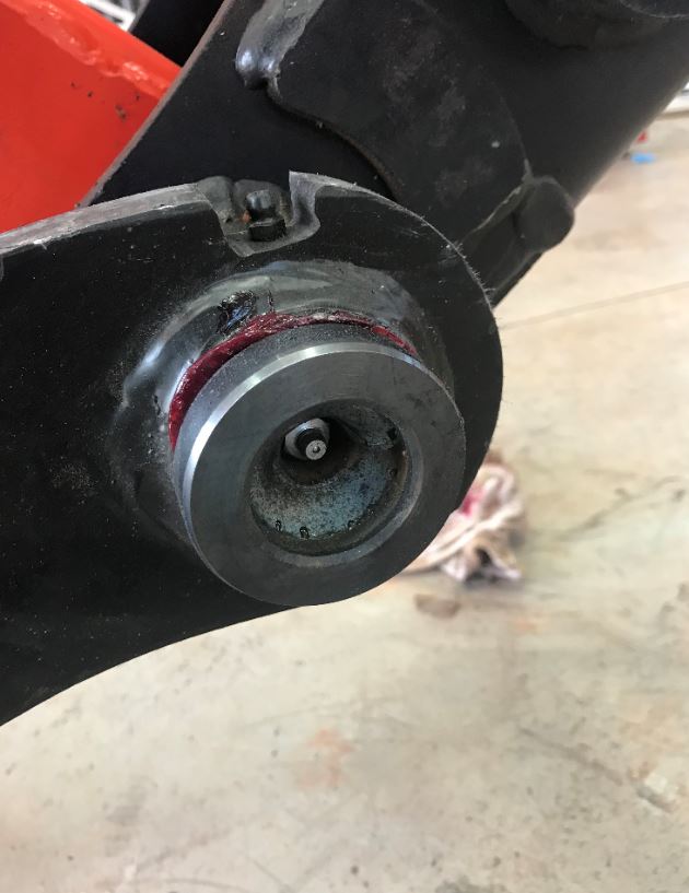

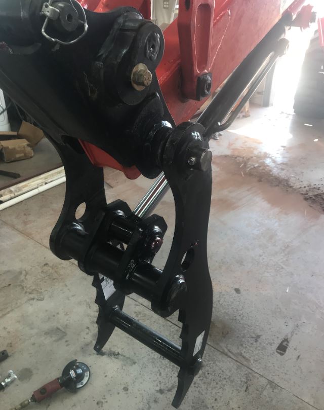

Once I ground down my mistake the new hardened main pin fit perfectly. The longer main pin came drilled and a recessed grease fitting came installed

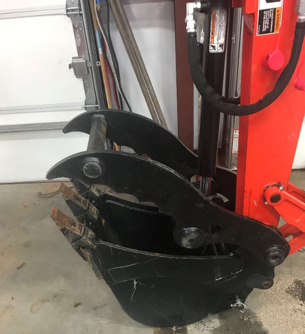

Then it was time to install the cylinder which was also built to my (mis)measurements and required about 1/8" to be ground down.
I did a little testing with the new thumb tonight but I ran out of time. I will post a couple more pictures later but, so far, it looks like it was was definitely worth the investment and I want to give a huge recommendation to check out ShowTimeFab.com if you are in the market for a thumb.:thumbsup:

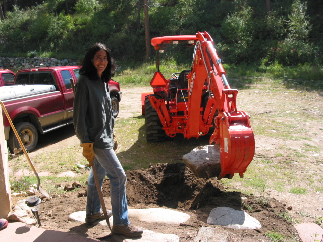

It didn't take long before the thumb became our favorite feature. We like to landscape, and have a lot of rocks and trees. So we probably fire up the tractor to use the thumb more than any other reason - and none of what it does is what we expected when we got it. The backhoe rarely just digs holes in the ground, more often it is used as a lifter & positioner. Here it's doing some rockwork.
